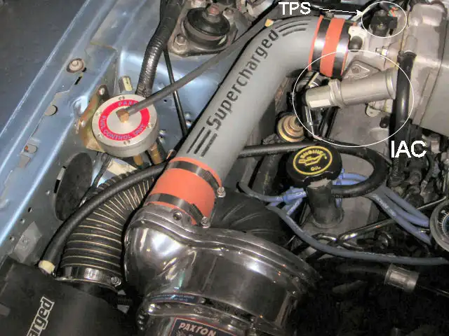

OK, time for my stupid Q...
My car does the same thing (stalls), is the IAB/IAC the thing that is screwed to the top of the throttle body?
Here's a pic I had laying around, I circled the IAC and TPS.
Jeff

Woot woot woot!!
I got some carb/TB cleaner, took the IAC off and cleaned it out. This morning when I started it up, no stall:D
Excellant advice, thanks again
