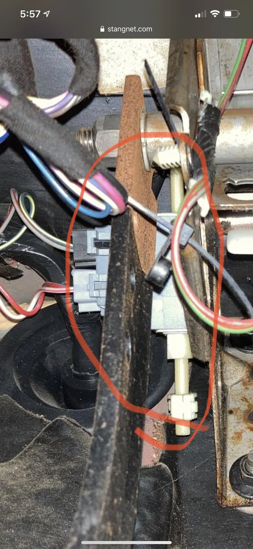

S skimbap Member Jul 13, 2020 15 2 13 California Jul 24, 2020 #3 Jul 24, 2020 #3 wmburns said: Getting a picture for you will be a tough order to follow. The clutch safety switch is located under the dash above the pedal pivot boxes. Why don't you post of picture of the area above your clutch pedal? Click to expand... Here's the picture! I hope it's clear enough. Attachments 115824925_1544044595776189_3225599873326496871_n.webp 555.7 KB · Views: 700

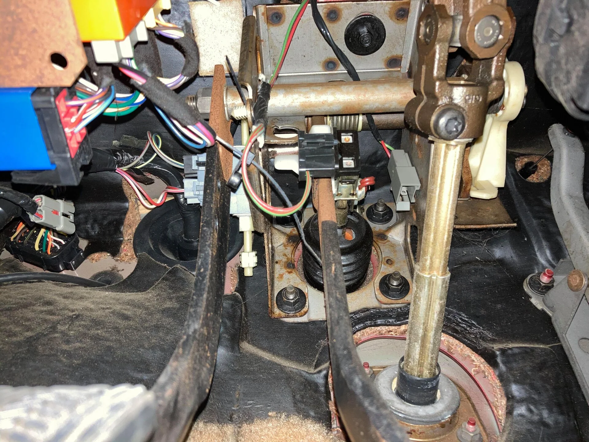

Mustang5L5 That is…until I whipped out my Bissell Mod Dude Feb 18, 2001 43,347 18,081 224 Massachusetts Jul 28, 2020 #4 Jul 28, 2020 #4 This is it. You can see the two plugs on the left side of it. One is your clutch starter interrupt, the other is the Nuetral Gear Switch Reactions: skimbap
