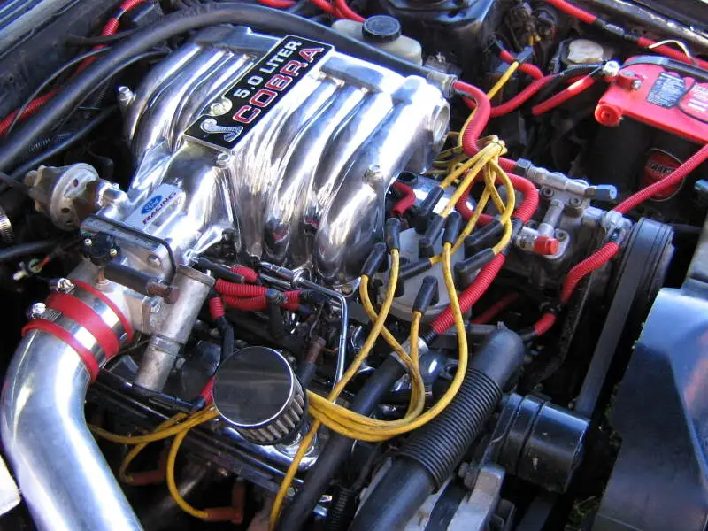

here are some pics of the intake and my cars

Nice...I'm willing to bet it would run better as well if you were to help that breather in the valve cover rigth into the garabage and replace it with the factory air line.
i plan on capping them off but first ineed to fihure out why it wont stay running unless i stay on the gas, it runs until you let off the gas then it quits. It was already doing this before i installed the new intake and throttle body, i figured i could install the new throttle body and give it a tune up and maybe it would idle but no luck.
I had the same problem on a previous car, it was the IAC valve that was bad. I bought a new one at autozoo and it was fixed.
If you run a breather like that, you NEED to cap the vac lines like that. If you don't it will draw air from the breather into the engine and run a little bit leaner
