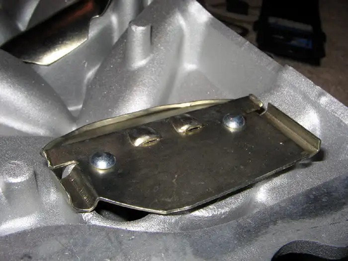

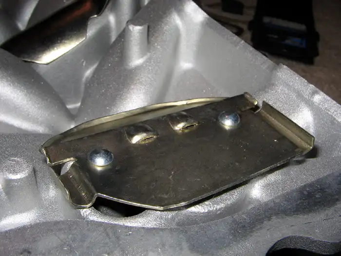

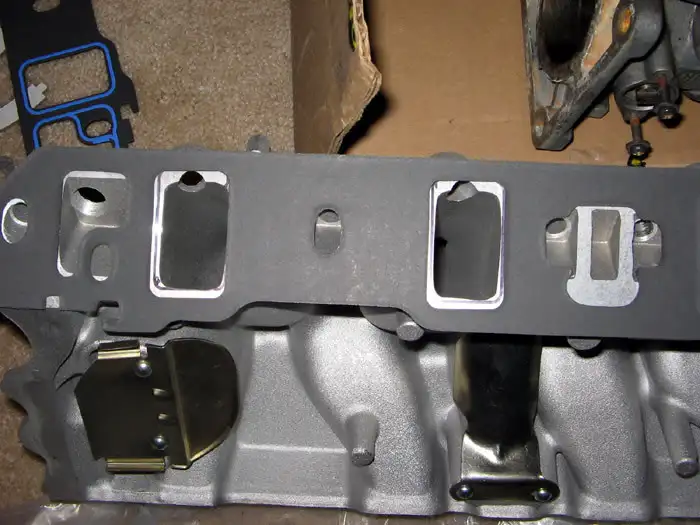

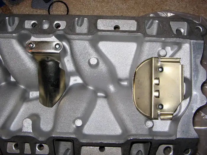

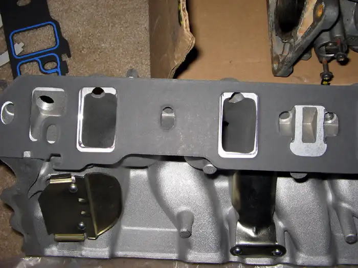

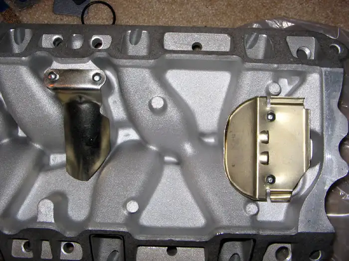

Well a few people said the baffle on the lower isnt made correctly and I have to get a new one from FRP.

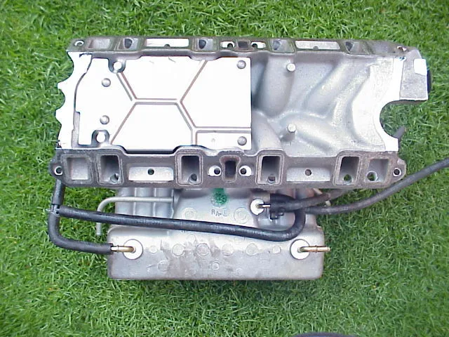

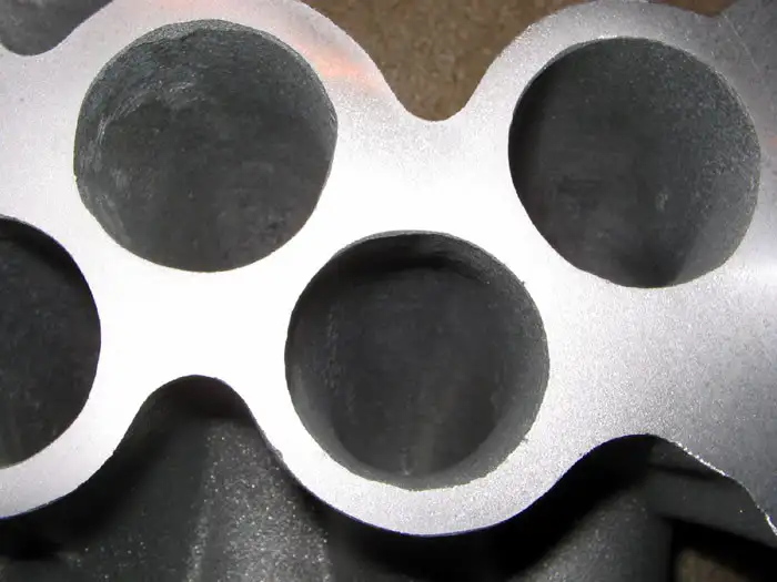

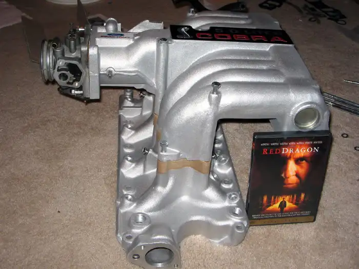

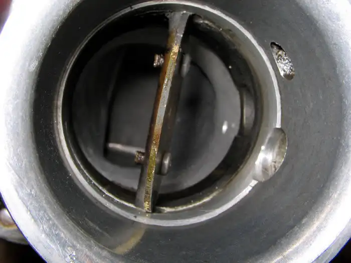

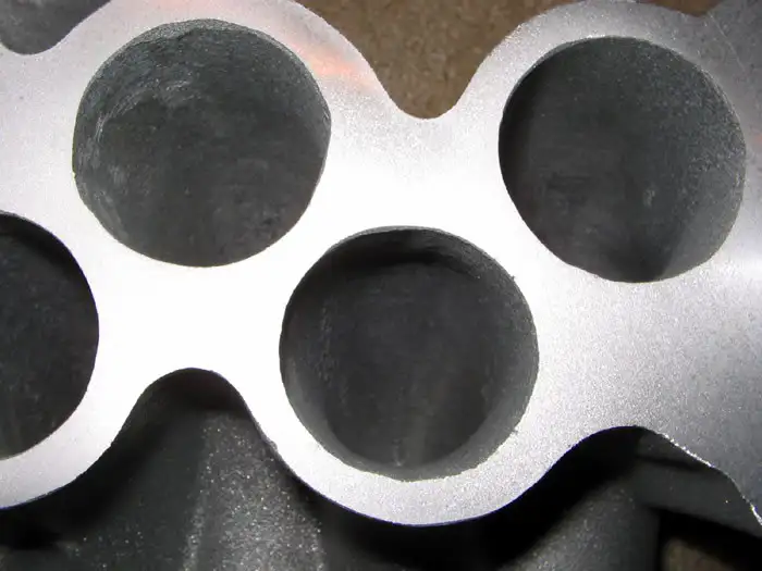

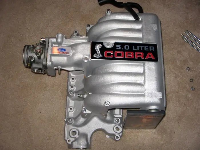

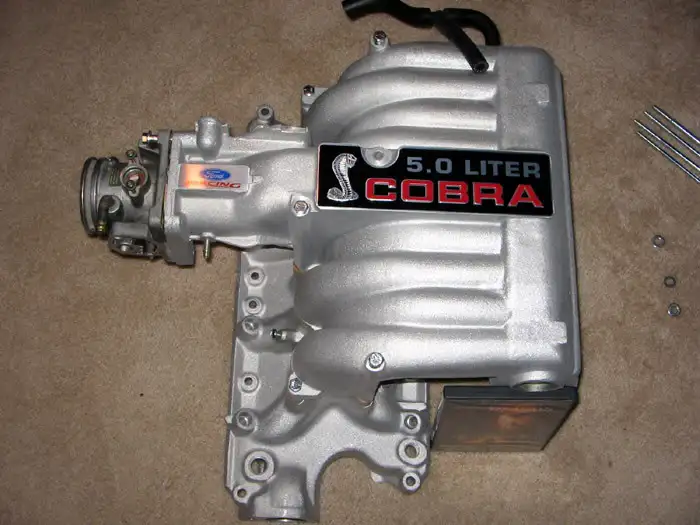

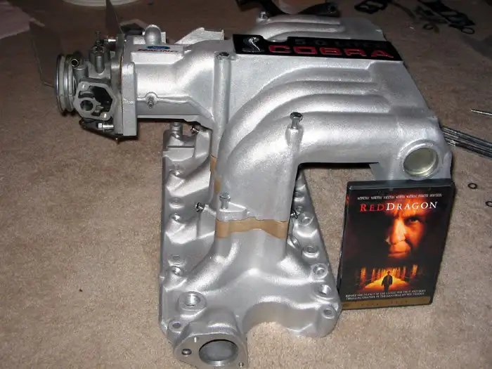

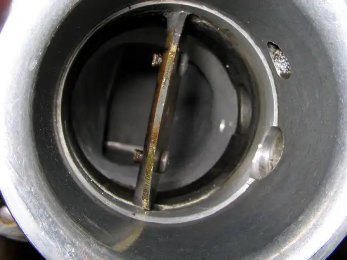

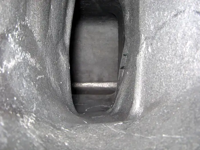

Well I took some pics of mine and let me know if this is the "bad" baffle. Also a few other pics.
It doesnt look like much oil could get in there, but I could be wrong.

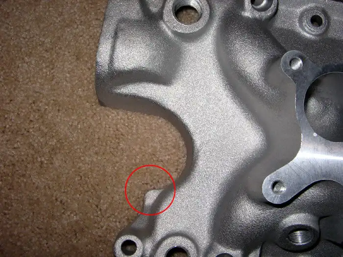

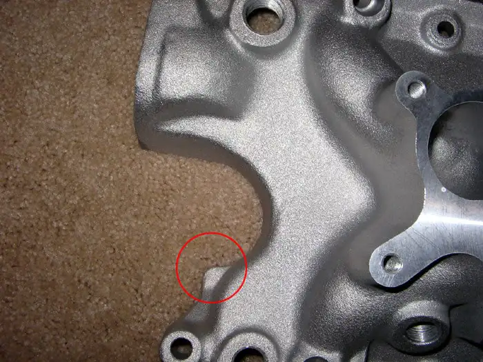

Also, someone mentioned the distributor not fitting in correctly w/o grinding the lower. Is this the part I need to grind?

The coolant passage/distributor housing on yours is different from mine. I was talking about the part opposite where you circled, where the t-stat sits. On mine, there was no cut out for the distributor module to turn. You should be safe there. You have the same baffle set-up mine came with that caused the oil consumption problem. I wonder though, since you appear to have a different lower casting than I do, if you'll have the oil consumption problem I did?:shrug:
I'd call the tech line and see what they say about that.

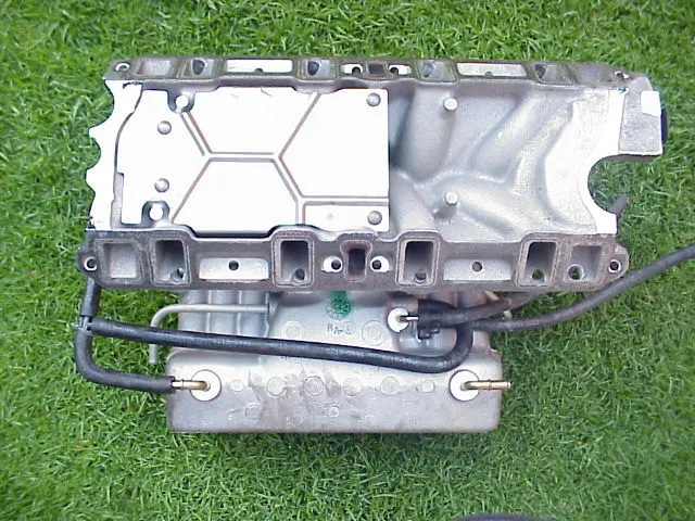

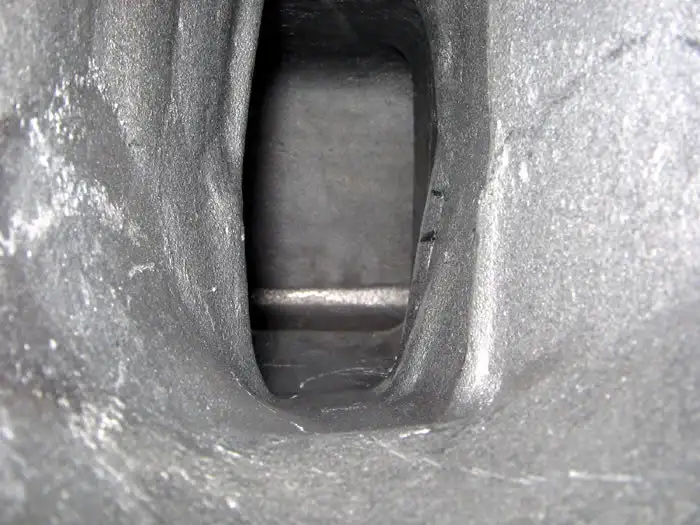

wow the baffle on my explorer intake covers about half of the lower intake. Id say the inside of the intake looks alittle rough but my explorer intake didnt look much better. Good luck with fitment issues, not sure if itll work or not, thats weird the china intake has been out for a while, weird to only just now start hearing bad things about it.
I got this picture from another site but this is what the explorer baffle looks like
Since the intake has not been installed yet,if I were you I would replace the baffle with the Ford Racing updated baffle to be on the safe side.
Like I said before,it would really suck if you do have the oil issues and have to remove the intake a second time to replace the baffle.
wish one of you guys had a pic of what the new baffle looks like.
Maybe I could just smash the one I have down a bit.
It would seem to me that for the PCV to work I would only need a tiny area for air/excess pressure to get to. Correct?
And Im sure its not a huge amount of pressure.
Wow,that oil baffle on the Cobra looks like a total joke compared to the one on the Explorer.
I`d be wanting the Explorer size over that mickey mouse Cobra baffle.

Dude, Call FRPP and get the updated baffle or YOU WILL WISH YOU HAD DONE SO. Trust me, I had teh same issue with the same chinese intake. But thank God I have the tall FRPP valve covers so I moved my pcv to the driver side valve cover and it solved the problem with an air/oil seperator inline. Other than that the intake is awesome!
Yeah Ill probably just end up calling them.
Doesnt look like the old one would be hard to get off.
Drill out the rivets. Then I can drill and tap the holes and use screws.
Do you think cleaning up the casting on the ports will help flow at all?
well I called Ford, and they said they would ship a new, larger, baffle.
But what surprised me is that he said of the 1,000's of cobra intakes they have sold, only a few people have had PCV/Baffle problems....
