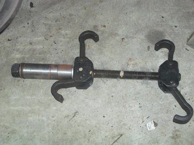

Does your spring compressor look like this????
I think this is the best kind to use. You gotta wrench on it from under the hood, but it seems to stay in place really well.

Ys thats it. Mine didn't come with that spacer sleeve so I went and used 3/4" grade 8 nuts instead.
Are you guys saying to have a long and short arm on each side? Such as one side has long arm on top and short directly below?

Yes. Mine didn't come with the spacer either, so I used a piece of water pipe to get the job done before it ran out of threads.

I was not concerned with the alignment, it just sort of fell into place. The arms are one short, one long on top and bottom. They allow for alignment to match the uneven curve of the spring.

Wow, no wonder it sucked so bad using the spring compressor I had! :nonono: I had to disassemble it and reassemble inside the spring, then turn about 30 degrees at a time with an open end wrench.
Imagine several hours' time to compress one spring. :( It was nasty bad.

The clamshell type is the best, IMO. It uses the top of the shock tower as a mount and two hooks on the other end. Far mor stable and you aren't screwing around with spacers.

How do you get the spring compressor to work without spacers?
I tried it without any spacers and the end of the threaded shaft was bottoming out on the spring perch before the spring was compressed enought to remove. Thats why Iended up using grade "8" 3/4" nuts as spacers.

NO. One guy said he didn't screw with spacer and I was mocking him saying I don't either. I use a spacer to do exactly what you said.
