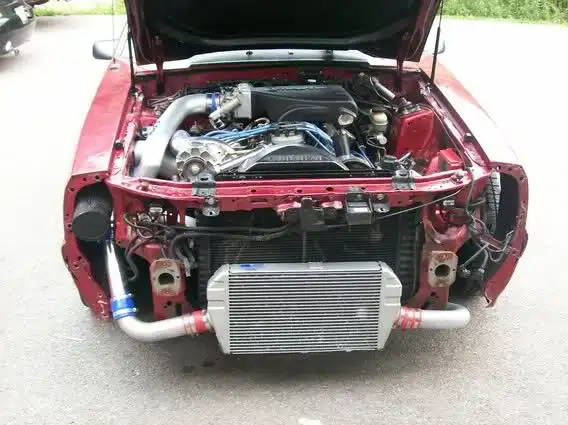

In the end, will the fenderwell kit look something like this? Minus the blower, IC and all the fancy crap lol Thanks for the help!

The filters that go into the fenderwell won't quite look like that, but do go into the same area. The filters that are exposed in the engine bay, which was already said, take in warmer air from the engine bay. In my opinion, the kits that go into the fenderwell are better because they are taking in a cooler, denser charge away from the engine. I don't have dyno numbers or anything....just makes sense to me.
kinda. do you see where the filter is poking out from between the fender? that's where most cold air kits run the filter. normally it's a different style filter though. regardless, like everyone said, if you have a factory air box, keep it. it IS a cold air system. i have a BBK cold air kit, but that's only cause it came with the car. and no, there is no cutting or drilling or anything. there is a big oval hole right behind where the stock airbox is. after you remove the airbox, the cold air tubing runs into that hole and just bolts down using the factory air box bolt holes.
