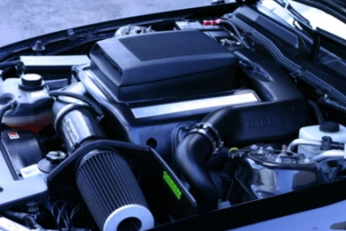

Once again, youre misunderstanding me. I never claimed an aftermarket CAI is worse or not more efficent. And to the Stangnet Judge on this topic, I do know the difference between the different types of filters. Why do you think I run a Demolet/SCT Intake with a Shaker Hood? So please dont insult me or, Im sorry JUDGE me when you dont know me. I just said the stock box is one version of a CAI setup. But I will know longer try to argue this pointless topic, to each his own.
