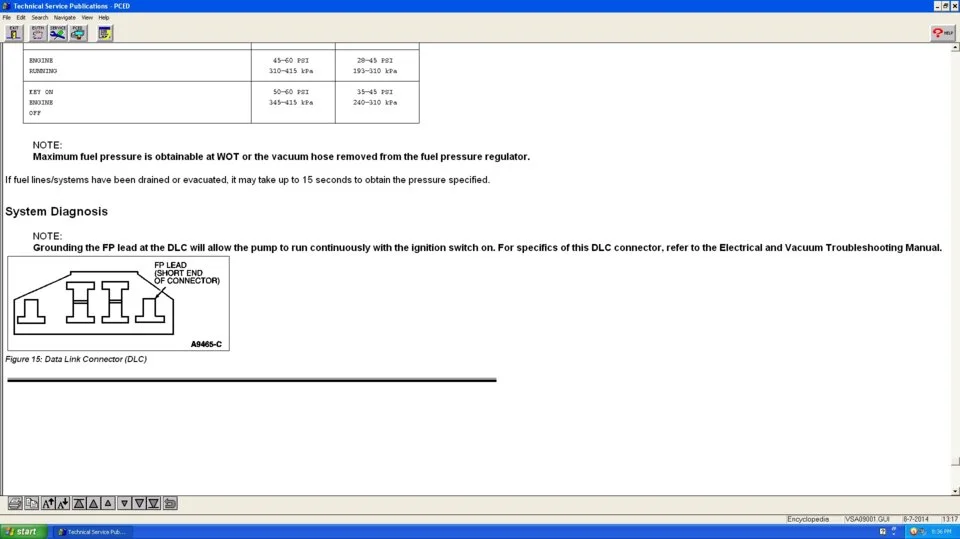

Check the voltage to the fuel pump with the engine off and then on. The 22 psi KOEO is suspicious. It should be close to 40 psi. Ground the fuel pump as illustrated to keep it on.

Fuel pump pressure test
Disconnect the larger of the two fuel lines up by the Schrader valve. It is the return line and does not have the Schrader valve on it. Find a piece of rubber fuel hose and clamp it on the return line coming from the regulator. Stick a bolt in the other end of the hose and make sure that all your connections are tight and leak proof as possible. When this powers up, you don't want fuel squirting everywhere. Hook up the fuel pressure test gauge. Turn the ignition switch on and watch for leaks. You may want to use a helper inside the car to cut the switch off quickly if you have a leak. To trick the fuel pump into running, find the ECC test connector and jump the connector in the Upper RH corner to ground.
Caution!!! You have blocked the return line for the fuel pump! Pressure will rise very quickly past safe levels with a good pump
If the pressure goes up past 55 PSI, the pump is good and the fuel pressure regulator is bad. If the fuel pressure does not hit 55 PSI or more in a few seconds, the pump is bad or you have electrical problems.
