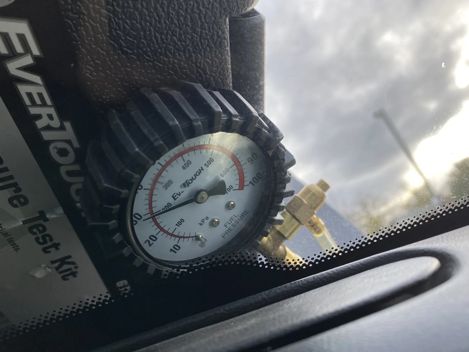

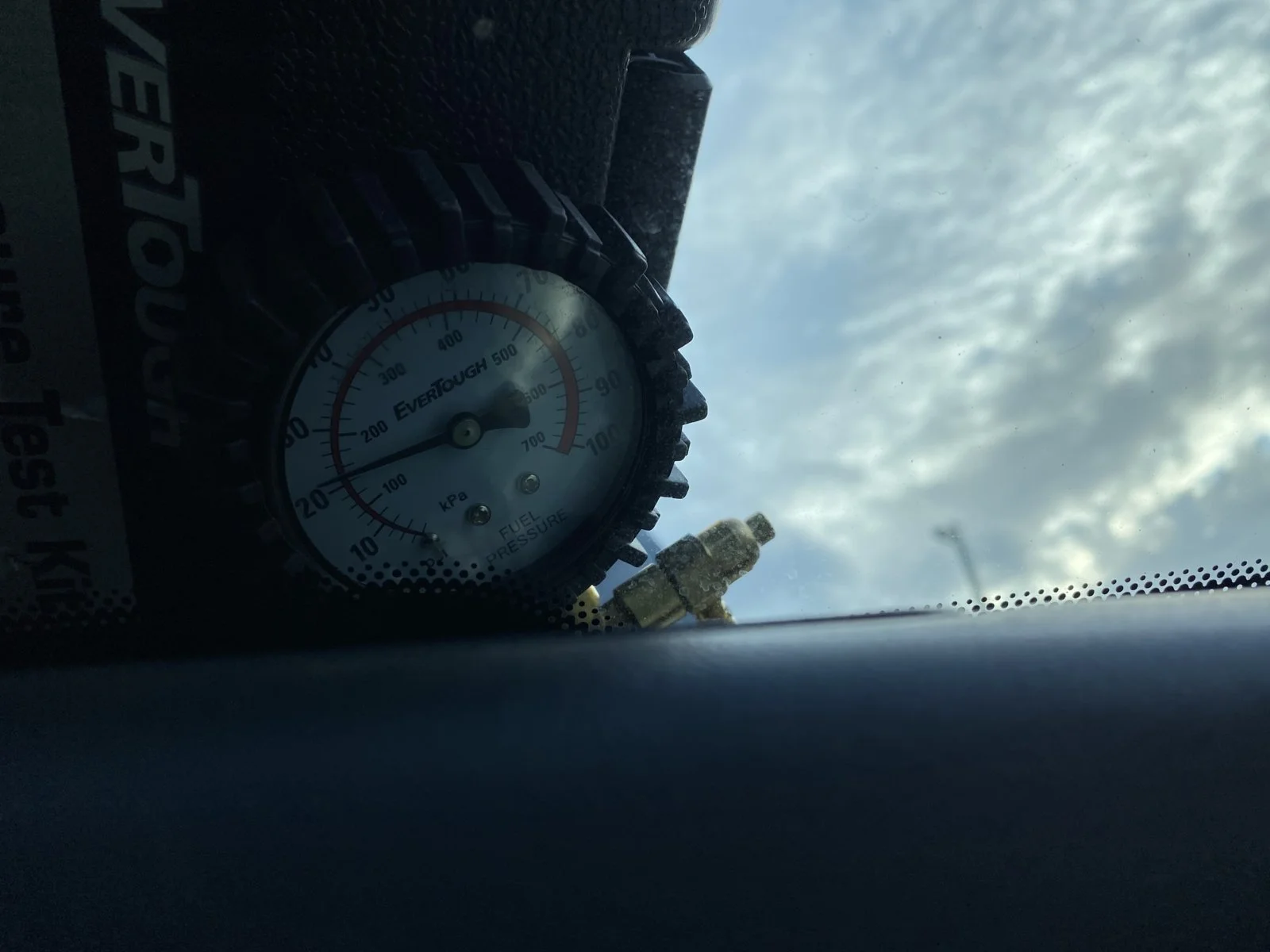

Yeah that behavior seemed weird to me. It did that before i changed the pump which is why i changed it. its a new 155lb pump from LMR. also the fuel doesnt seem to bleed down super fast after i turn the key off. it does go down from about 35 to 29 right when i turn the key off then these two pictures are 22 minutes apart right after shutoff.
Pressure not supposed to bleed down "super fast". Doing so will create other problems on hot start. Pressure look normal in those pics.
