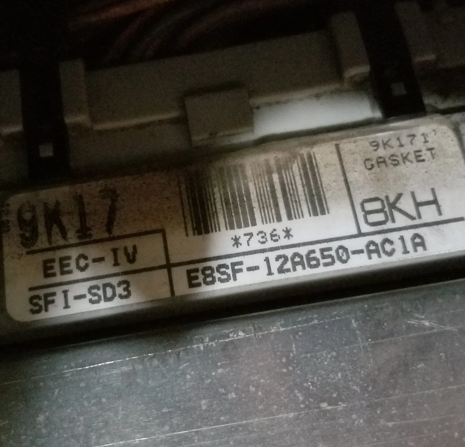

Can anyone tell me what this is out of? It's in my 88 mustang gt 5.0 manual transmission, speed density. Can that be Why its running rich
Dump the codes to find out why the car isn't running right.
Dump codes sticky
Look at the top of the 5.0 Tech forum where the sticky threads are posted. One of them is how to dump the computer codes. Codes may be present even if the CEL (Check Engine Light) isn’t on. You don’t need a code reader or scanner – all you need is a paper clip, or if your lady friend has a hair pin, that will do the job.
I highly suggest that you read it and follow the instructions to dump the codes. http://www.stangnet.com/mustang-forums/threads/how-to-pull-codes-from-eec4.889006/
That computer is programmed to run an engine with the 1-5-4-2-6-3-7-8 firing order. Running that computer on an HO firing order engine will cause all sorts of problems.
