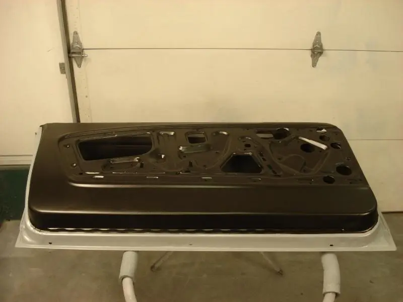

I use Dupont DTM epoxy primer but I'm sure there's cheaper ones out there that work just as well. I've heard SPI is good and well priced but we don't have it in Canada.
No sanding between coats, as the door has a textured finish, I just stayed within the top coat window between the epoxy primer and the Hot Rod black, and the flash times between coats of the black.

65Rob, that black has a satin finish? Looks good
