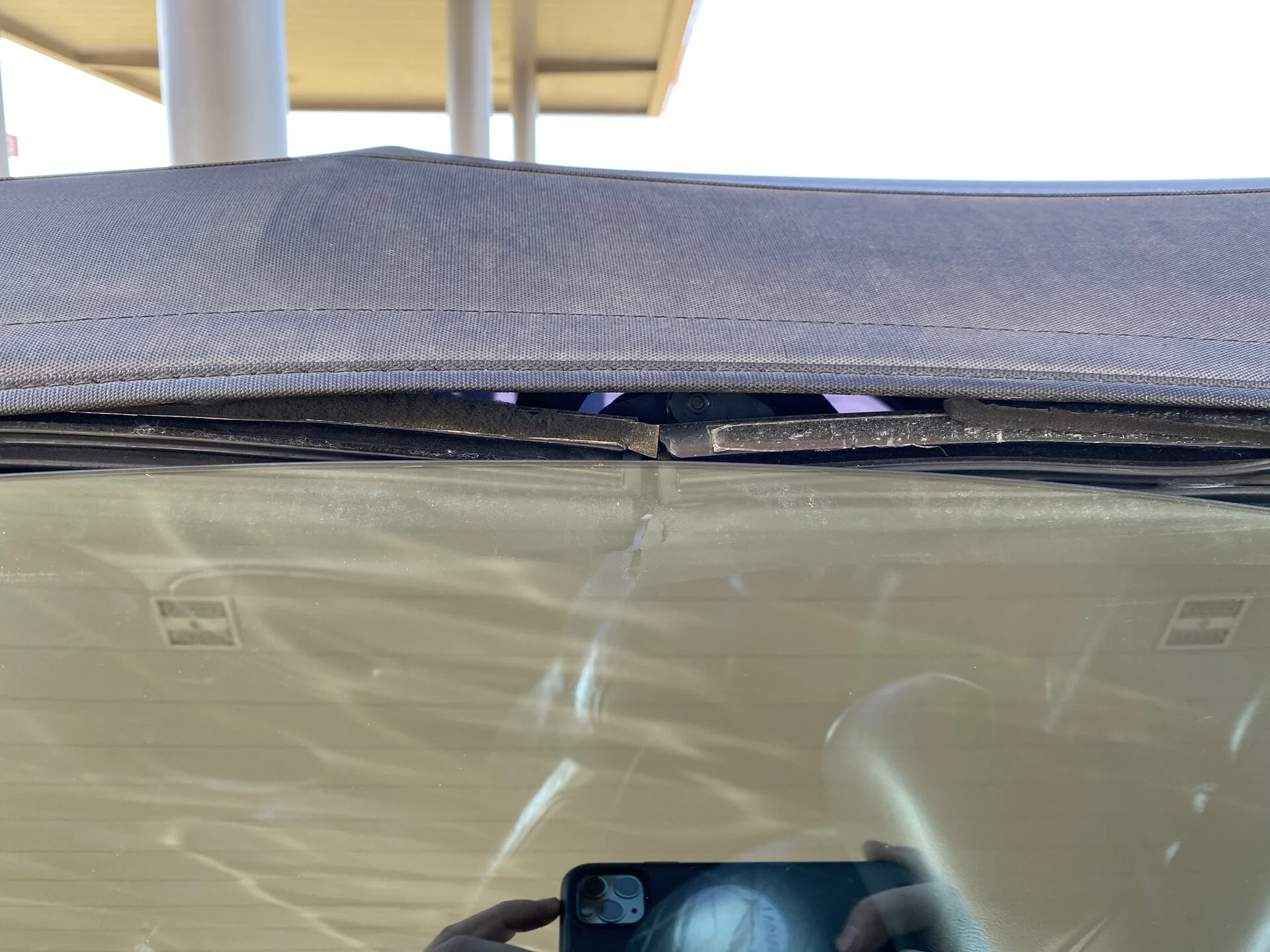

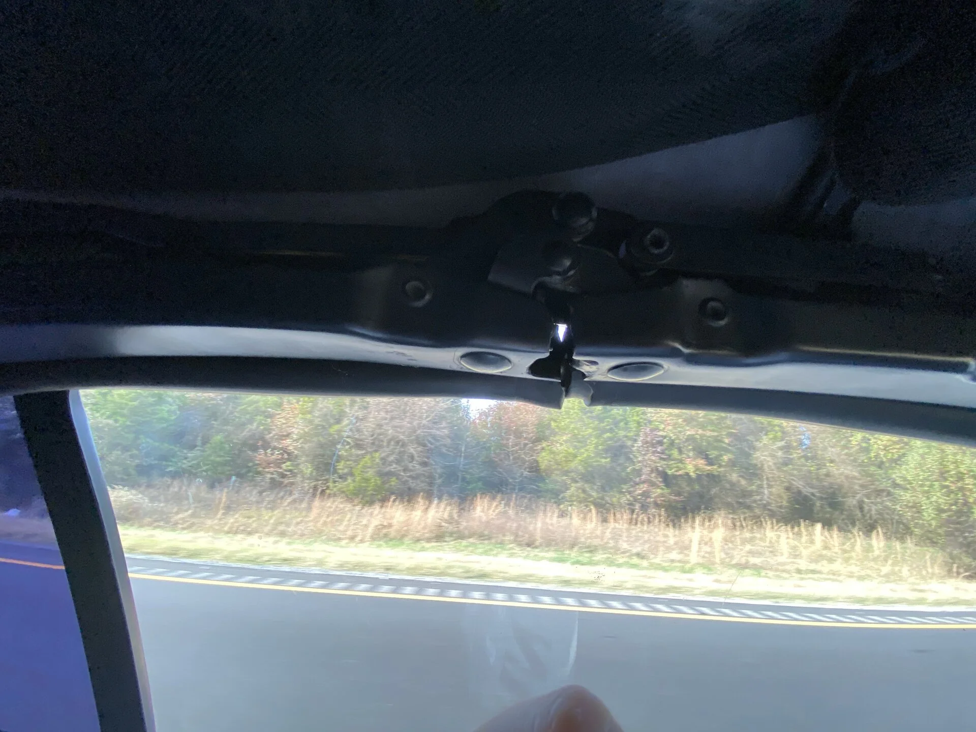

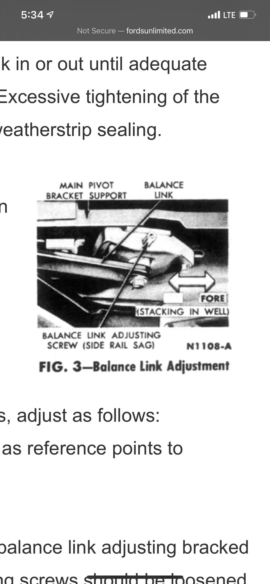

Robs96 said:
If anyone needs help with verts I have a lot of hands on with top replacement and adjustment.
I need help, my piece in the middle by the drivers window is sagging. I tried to loosen the bolts at the adjustment lever behind kick panel in back, as well as the gear to take the slack out of the two joints. It never fixed it. I put new weatherstripping thinking that would help at it didn’t. How do I adjust the sagging in the middle by the window. I can’t get anyone to help me, I have a broken back and can’t travel the 3 hours it takes to get to a guy who works on upholstery and tops. I never found that balance link adjustment screw like everyone talked about. Does my 1994 GT Vert even have one. I’ll send the pics of the part they showed me, and the gap I’m talking about. It causes the window to be at or nearly above convertible top and the passenger side fits perfect. I’m almost out of options, I am tired of seeing that sag. I’m about to just sell it if I can’t get it fixed.
I have to be honest and say that I haven't had that car in over 10 years now, and that was the last time I owned a convertible anything. I couldn't even remember my user name or password to log back in so I had to reset to reply lol. I can't really remember what all I did back then, but there are adjustment screws. Another issue with sag could be that the top isn't completely tight and allowing it to bow. As the top goes up all slack is removed to make it a tight part of the car frame. That being said, a 94 would be the same as my old 96. Wish I could be of more help, but that was a long time ago, and many other cars since.
