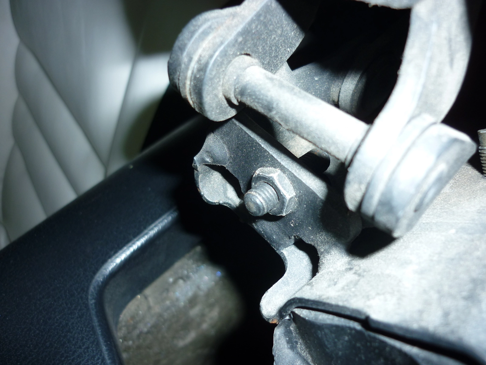

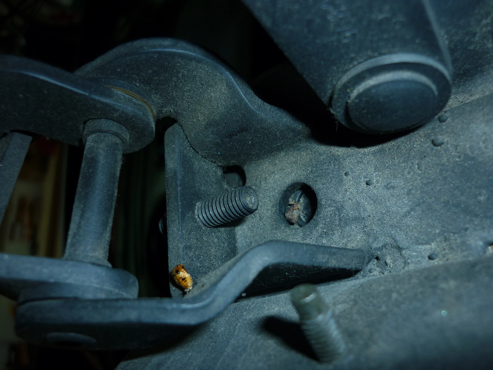

Does anyone know anything about convertible top adjustment? I have a 94 and on the passenger side the top doesn't cover the edge of the window. Looks like the cable needs to be tighten. The driver side is prefect.
There is an adjustment screw that is visible when the top just begins to open. It is located towards the top edge of the window where the first hinge is. I've attached a couple of pictures. You will recognize it when you see it. This will allow you to lower the top relative to the window edge. It's a screw with a hex head and locking nut.
