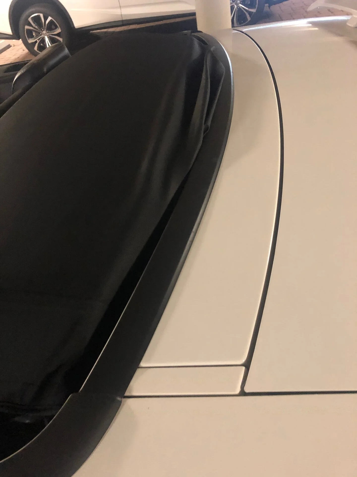

M MLSGT2006 New Member Jan 21, 2021 1 0 1 Florida Jan 21, 2021 #1 Jan 21, 2021 #1 My top does not tuck in properly when I retract it. Any ideas?

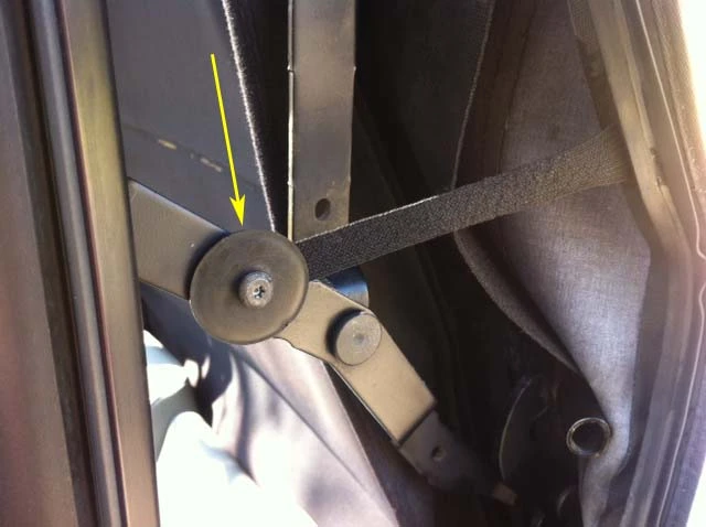

S silverdroptop New Member Nov 5, 2021 1 0 1 Sac Nov 5, 2021 #3 Nov 5, 2021 #3 The elastic straps get worn out over time and loose their elasticity. The straps are needed to keep tension so the top folds in the right places. One strap goes all the way across the top, maybe MLSGT2006 is broken.
