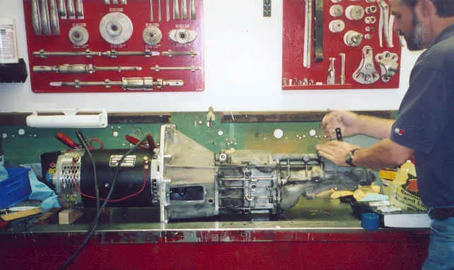

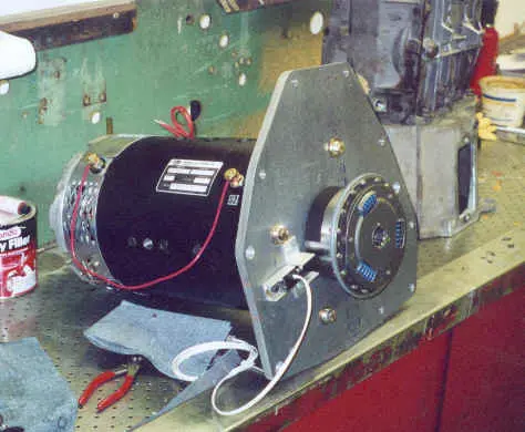

Please post a drawing or picture of the drive end of the electric motor. Is there a flange mounting pad on the drive end of the electric motor? I may have some helpful ideas for you.
I pick up the motor from the rebuild shop tomorrow. I will try to get some pictures then. In the meantime here are some pics from another person's project. He had someone else make the adapter with no documentation generated. You can get the idea regarding what is required. My motor will not have a straight keyed shaft as this WarP9 motor does. My motor has a SAE splined shaft. This motor is 9" diameter, mine is 11.5".
