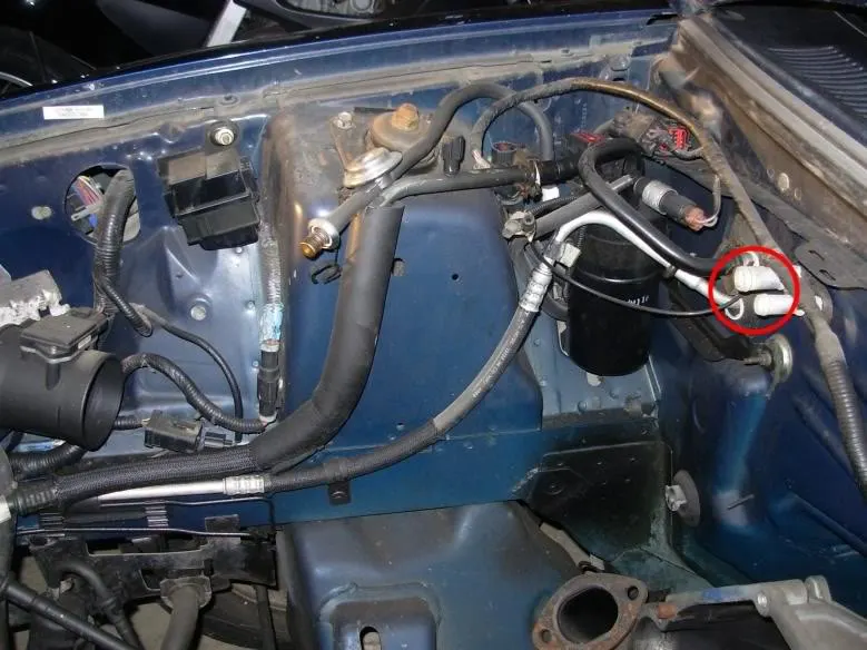

Re-route your heater hoses!
Are you are talking about one of the plastic fittngs shown in this picture that is identified by the red circle? If you are, this is a real big and expensive repair. I would say if you don't need your heater, I would re-route your hoses that is hooked up to these plastic fittings. You will need to adapt two different pipe fittings together to accommodate the two different size hoses, like the one shown in the lower picture. Once you get the appropriate fittings adapted together, back to back, simply remove the two hoses from the plastic fittings on the firewall, and install your adaptor fittings between the two hoses with some hose clamps. You need to do it this way, to keep your coolant flowing properly through the engine, otherwise you can overheat your engine and cause major damages. The two plastic fittings on the firewall can then be covered with rubber caps sold at any auto parts store. This is probably the fastest and least expensive way to get your engine running again. Good luck, Tommy.

The coolant is not from those in the red circle. Its from the black plastic on low on the firewall just above the exhaust manifold.

Plastic Fittings Location!
Ok, I just used that picture as an example. No matter where your plastic fittings are located, if the coolant is leaking from one of the plastic fittings located on your firewall, it is a very expensive fix. To replace the plastic fittings, I could be wrong, however, I believe your entire AC/Heater box will have to be removed from under your dash to get to the fittings. My suggestion is just one simple way in which you can get your engine running again safely, without causing any damages to it. Good luck, Tommy.
