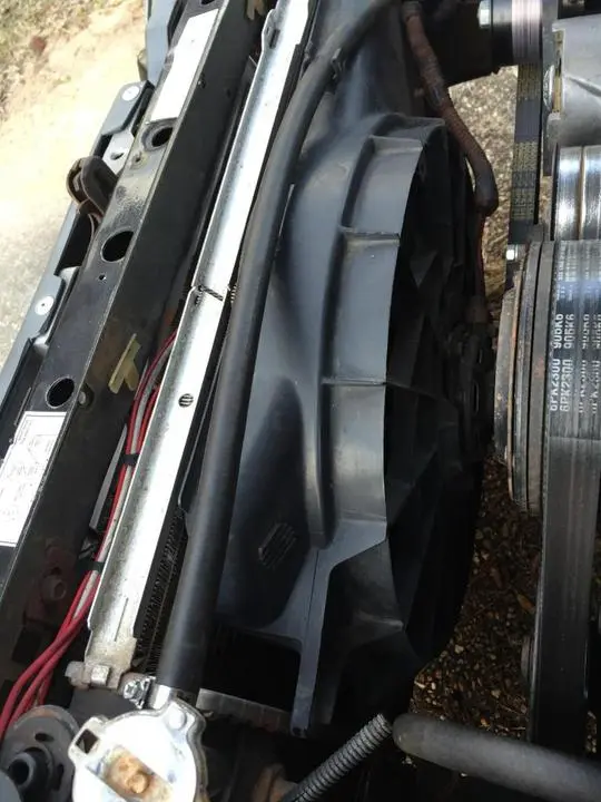

Google "taurus fan and flex a lite conroller install" There is a good install write up in the tech section here and on the Corral. This is not a very good picture but you can see the taurus fan and ss overflow bottle. The controller is mounted under the CAI in the passenger fenderwell

My E Fan stopped coming on, i'm not exactly sure why that is. I'll be looking into that tomorrow. I thought it might have been a blown fuse, and I did find one but it didn't fix the issue. I'll post a picture of the fan that is mounted now, it looks really similar to your fan pictured above and if that's the case it'll save me some $$$.

Any 93-96 taurus should work. Guys use both the single and dual fan setup. No sense getting a new fan just because you blew a fuse. Chances are you just need the proper wiring and/or controller. Take some pictures of the fan and controller.

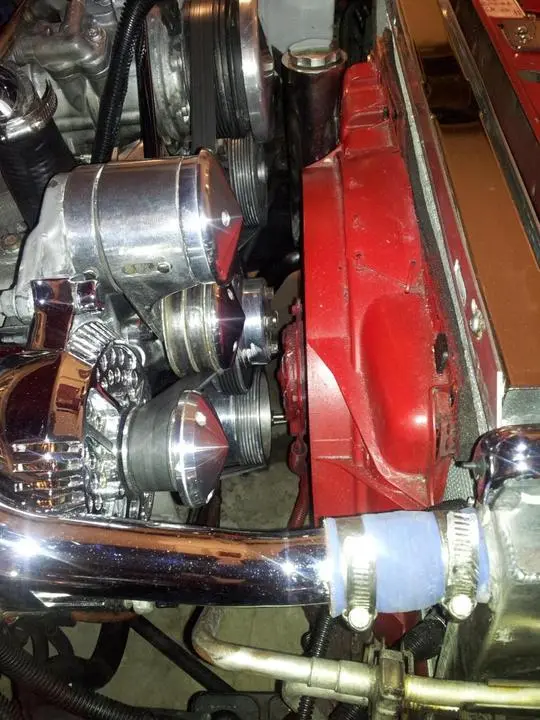

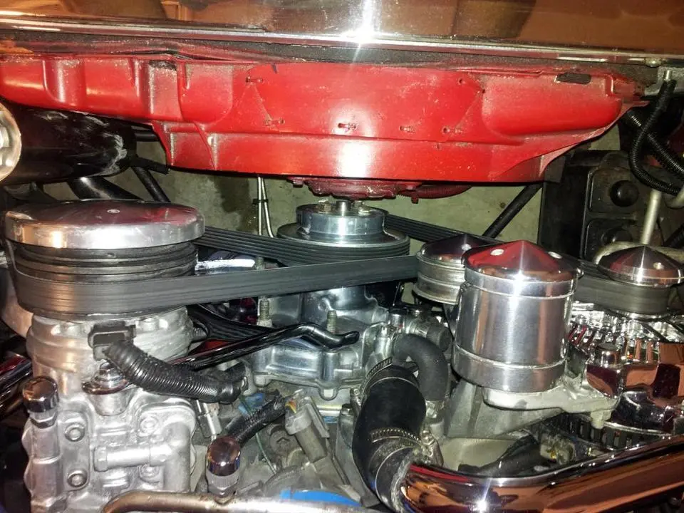

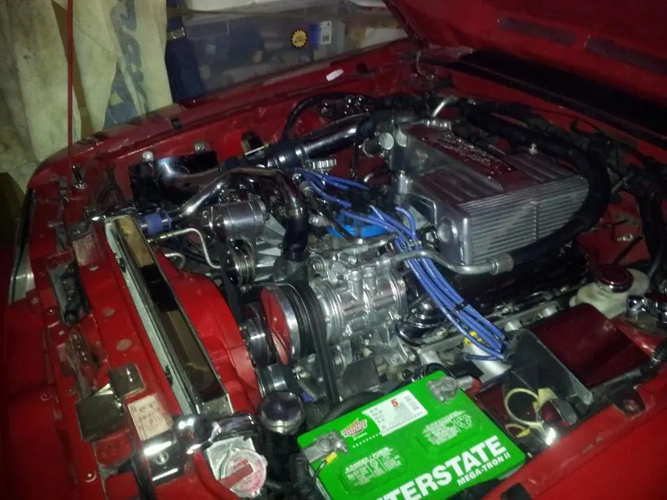

If you do mind spending that much money (I did). Buy that SVE radiator in your link, but not the dual fans kit. They're only 1900cfm. Instead get this Flex-A-Lite Black Magic Extreme fan kit(3300cfm). http://www.latemodelrestoration.com/item/FLX-185/79-93-Ford-Mustang-50L-Flex-a-Lite-Electric-Fan-Kit
This is the rad and fan I'm running with my HCI/Novi settup. Fits perfectly with the blower pulleys. I have a stock waterpump and thermostat. It runs perfect and stays perfectly cool.

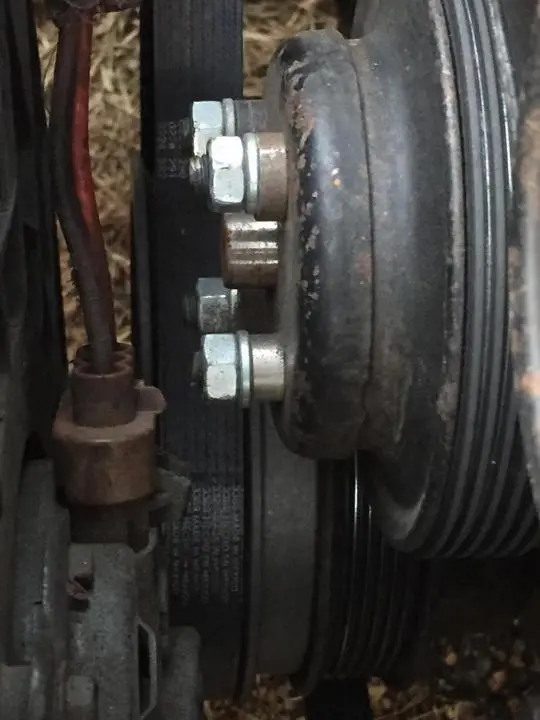

I checked it out today and I think this is the Taurus fan. When I was looking I saw that the plug to power the fan wasn't fully plugged in, so i believe that was the problem with the fan itself(Duh ). Unfortunately it seems like I only have about an inch(if that) from the radiator plug to the pulley. That is a problem only because this is a single row radiator, so I don't know if a larger one will fit. Anyone else have this issue?

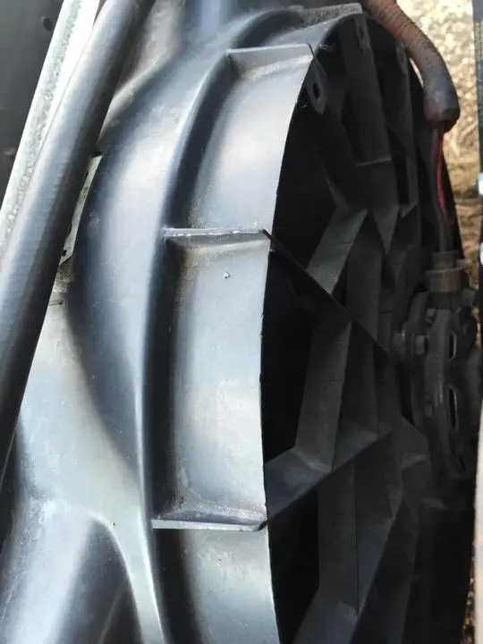

That is the exact same fan I have. Keep it as it will outperform most if not all aftermarket fans. It is smaller than the radiator so you can move it around and/or flip it over to gain extra clearance. There is an opening on the bottom part of the shroud that you can easily cover. I cut a piece of an old Coke bottle, secured it with small zip ties, and then painted the fan body color so it blends in.
I have a 2 core radiator and you can see although it is tight in my pic it does fit. Just saved you $300....
