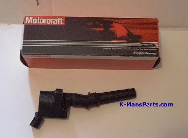

maybe a bad cop? also, do you have a tune installed?
what's a COP and how do I know if it's bad? I bought the car second hand and I'm not sure how to find out about a different map. I did think about it and the car does have flowmasters so it's a possibility...
COP = Coil on Plug
these stupid things...
