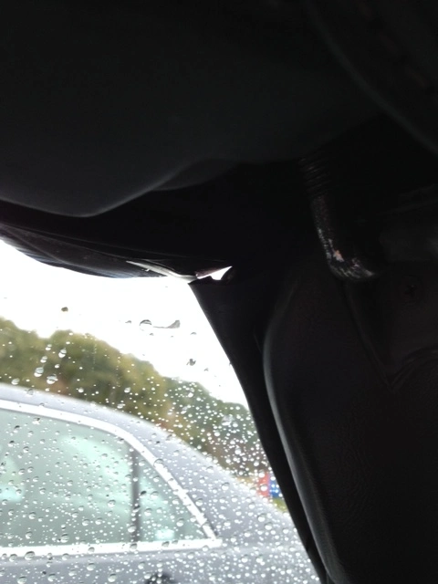

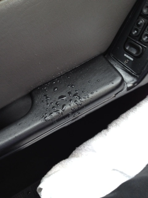

I’m having a leaky door window issue that I could use some help with. When it rains water runs in on the top edge of the driver’s door window and drips down all over the door panel, carpet, and driver’s seat edge. You can see daylight where the top seal and pillar edge seal meet. I’m just not sure which one I need to replace to fix the leak. I ordered a new top header seal and the convertible maintenance manual so I can adjust the door glass. Any other ideas or past experiences? I’m getting ready to order all new upholstery very soon so I really need to get this fixed. Thanks in advance.

It looks like your rubber is good but a little low, if its dry it may have shrunk some..
Is the window square when up? It look ok by the photo but hard to tell. If its tilted forward it won't push the windshield rubber tight enough.
Honestly they have no rain gutters so if the car is leaning that way it will drip in. After 25 years I've experienced no water issues even with that corner drip since it not all the time...

The header gasket appears to be in good shape. I get no air penetration at high speeds at all. All of the weatherstripping is in pretty good shape and doesn't appear dry or brittle. I did order a new header gasket and the book to make the necessary top adjustments. Hopefully between the two I will be able to resolve the issue.
