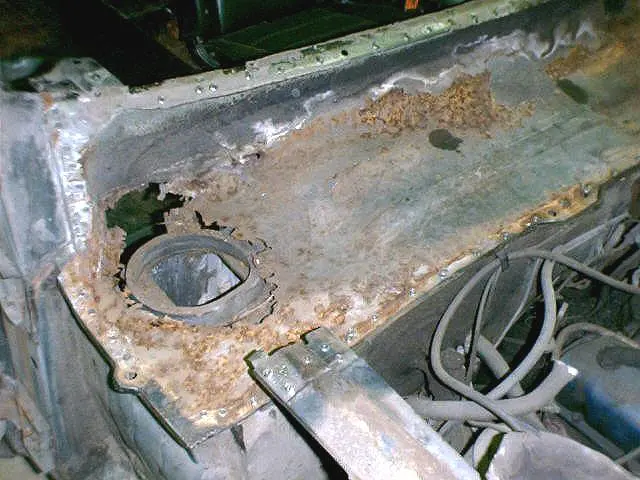

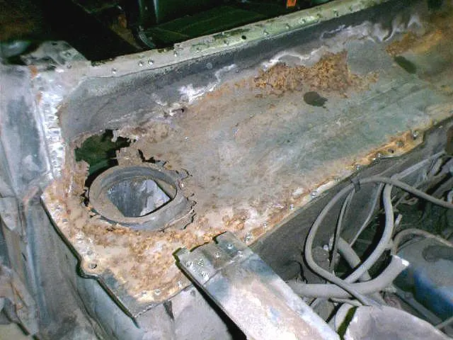

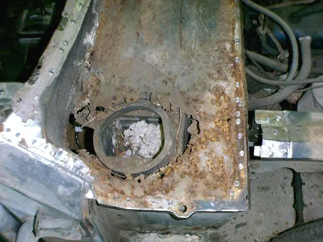

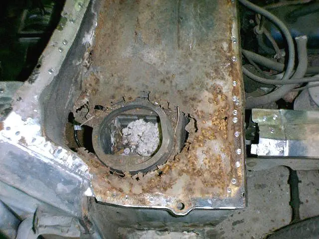

Just figured I'd share the pics of my green 72 coupe cowl area:
I got lucky and found a cowl piece on ebay a while back - won it for $50 :banana:
