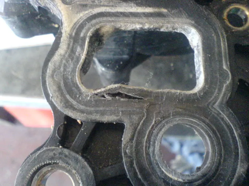

I'm currently on the road. I saved both gaskets and the intake just in case . . . when I get home, I'll take some pics and post them up here. I don't see how over tightening the thermo housing could crack this place in the manifold. Pics will help to describe.
Yeah, I had coolant in a couple of the plug holes too, but it wasn't that much so I vacuumed it out and that seems to be just fine. Got the new intake from the Ford dealer with a little bit of a "buddy deal" but it appears to be identical to the one I pulled off. Either way, it's all back together and runs great.
Interesting to hear how many others have heard / seen of this . . .

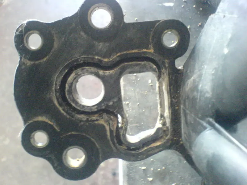

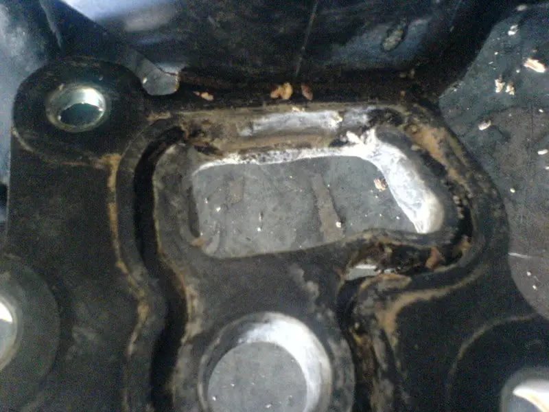

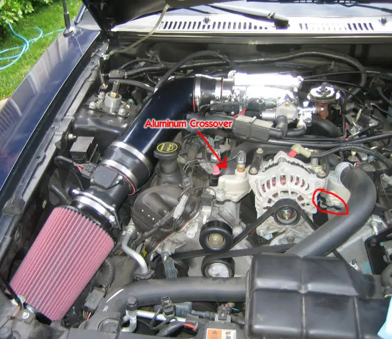

only pics i have. crappy quality i know.... camera phone was all i had at the time.
you are looking at the passage right under the thermostat housing & aluminum crossover that cracked and melted.
The circle on the right is showing the plastic portion of the intake manifold that cracked and melted under the thermostat housing.

I am curious if the orifice on the aluminum piece is bigger than the orifice on the composite piece which eventually led to the erosion of the composite material.
It would appear that coolant was bypassing the rubber ring and eroding away the composite material.
