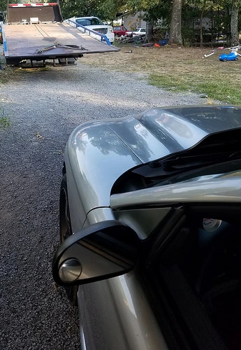

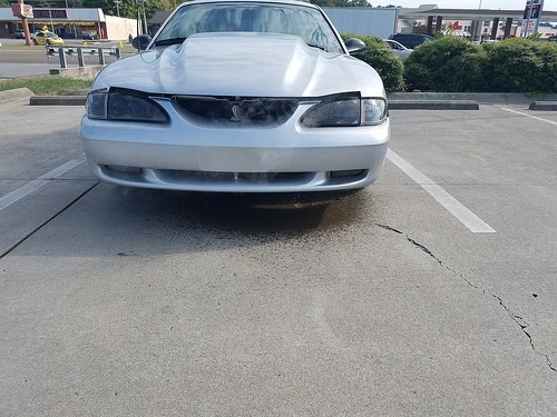

While I was picking up the IAC, though, I got out of the car and noticed a lot of steam coming out from under the drivers side of the hood. I also noticed a LOT of antifreeze being dumped at the front of the car on the drivers side. Once I could get the hood opened I noticed quite a bit of antifreeze on the battery and around that area, but not anywhere else.

I thought a hose might have busted, but all the hoses seem good. I got it home and it starts fine and runs, however, I do know the coolant is a bit low.

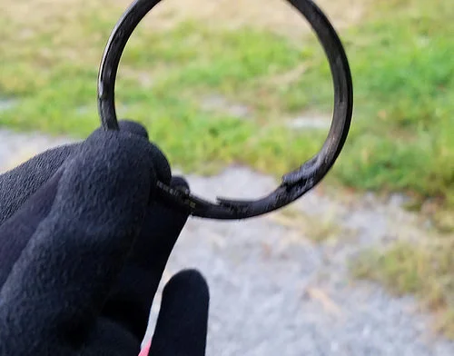

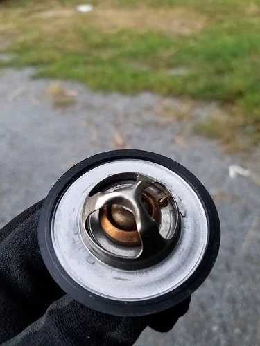

I was finally able to replace the thermostat, and the old o-ring was shot all to pieces. Part of it looked like it had melted to the thermostat housing, so I scraped it off and installed the new thermostat and gasket.
