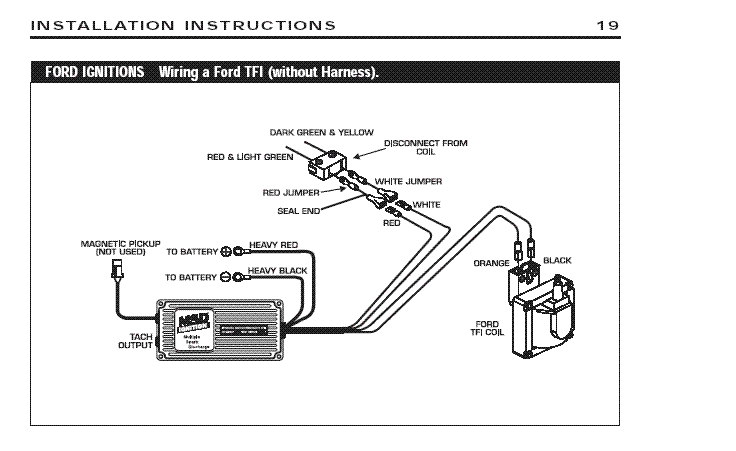

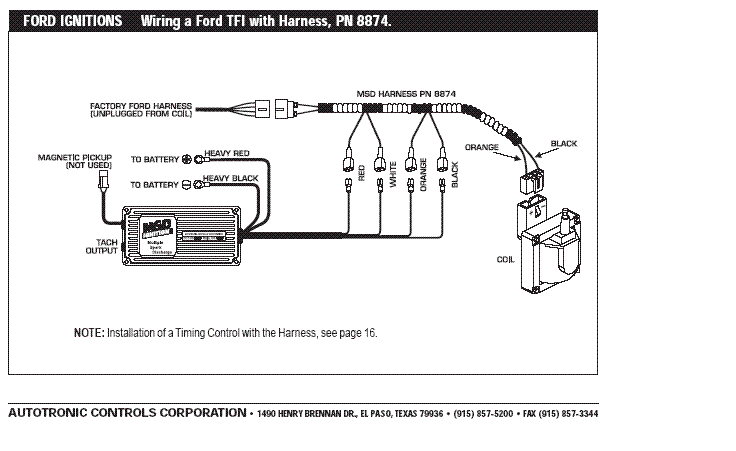

Do you have 12 volts at the input to the MSD box (small red wire) with the switch in the Run position?
The small red wire comes from the ignition switch and turns on a relay inside the MSD box to supply high current to the electronics inside it. No 12 volts on it with the ignition switch in the Run position and you have no voltage to make the standard OR MSD ignition operate.
MSD wiring:
Instead of using the battery negative terminal, attach the heavy gauge black wire to the body ground point by the windshield washer filler.
The battery common ground is a 10 gauge pigtail with the computer ground attached to it.
