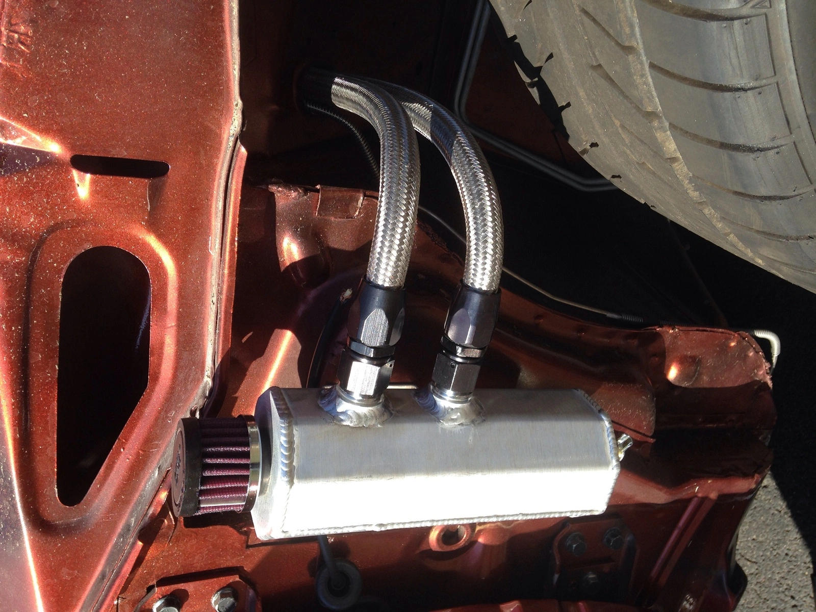

With that much boost, I would be ditching the pcv and run two breather Iines into a catch can. I also agree that you should check compression before you start taking things apart.
Yup, vent each valve cover to a catch can. Also, even if you just want to rebuild the bottom end anyway, you should diagnose the problem before you go through it and put it all together and still have the same issue.
Reactions: modulistic

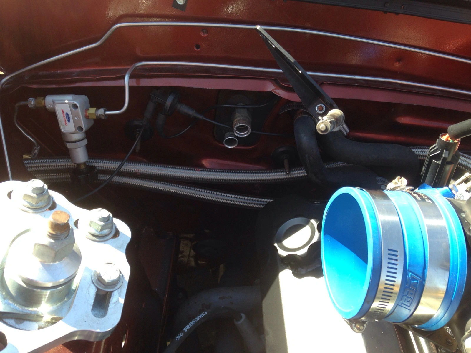

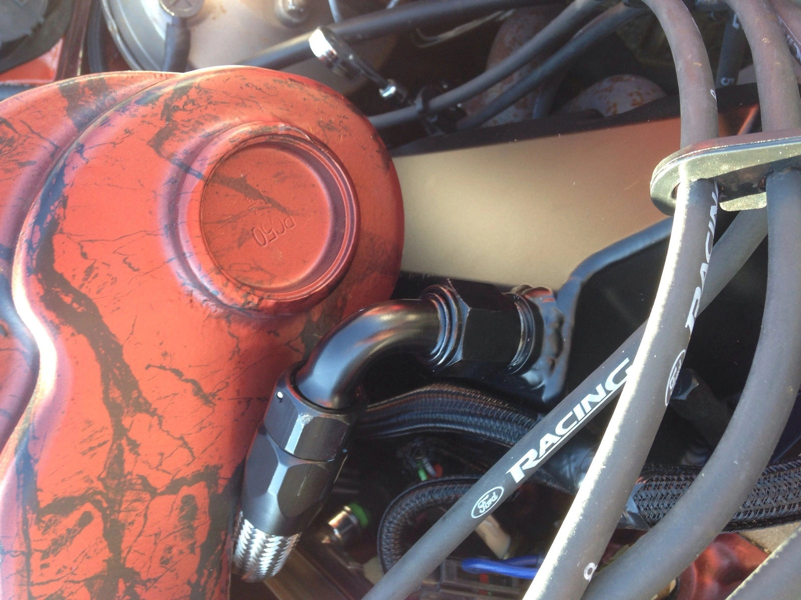

I'm not familiar with the catch can system, I've seen valve covers that extend the breathers up a few inches. It's actually never given me any trouble up until now, and I put this setup together about 12 years ago.
This is my setup

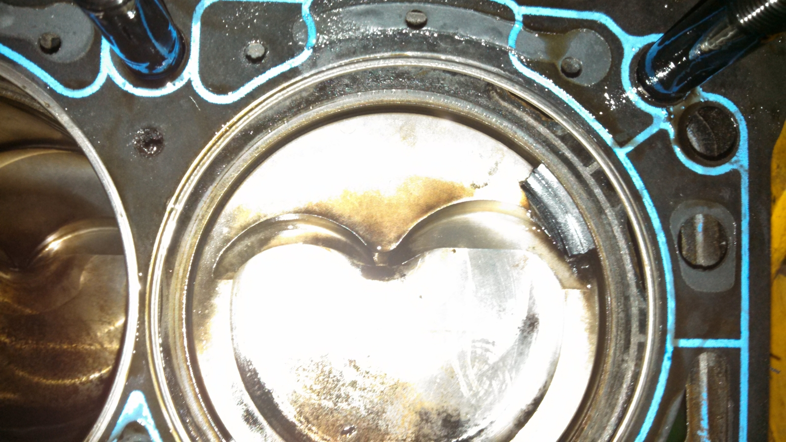

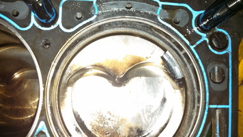

I'm thinking maybe this could be part of the problem? Had 40 psi on #8, but a little JB Weld and she should be good to go! Looks like the block is okay at least.
That's a missing piece of piston! I tore the whole motor down, the only damage I can find is to that one piston and rings. The piston is demolished, it even broke around the oil ring land somehow! Haven't pulled the valves out yet but there is no damage at all to the combustion chamber, even the rod bearing looks fine. Thinking about putting in a set of flat tops and a different cam and going back to N/A.
At least the leak down told you where to look. I figured the valve guides were not the problem. But WOW, do you think it went lean and melted the piston edge, or did that chunk somehow make it out past the exhaust valve?
I'm wondering if it detonated because the fuel was stale, but if it did I couldn't tell driving it. Looks like it started to melt and then a piece broke off, but its weird because there's no marks on the piston or combustion chamber. The lower ring land on a 331/333 stroker crosses the pin bore, and one side is somehow broken downward toward the pan in that spot, can't figure out why. Only damage seems to be to the one piston.
