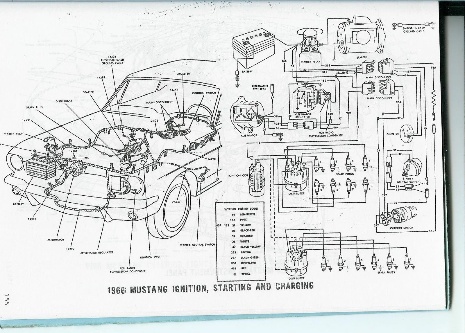

This is for a '66. but I would be shocked if '68 was much different. Essentially the coil pulls its 12v+ from the hot-in-run/start terminal on the ignition switch so it is always powered as long as the car is on.
Thanks for the diagram!
So to help the next guy: I did one more diagnostic check, I got my multimeter on the + coil and had my kid crank the motor, the volts went from 12V down to 3-4 volts. Same measurement on the solenoid. I figured it must be the solenoid then, went and put a new one on and it started right up(Solenoid was only a few months old....so either I got a bad one or something else messed it up.) either way Im back on the ROAD!!
