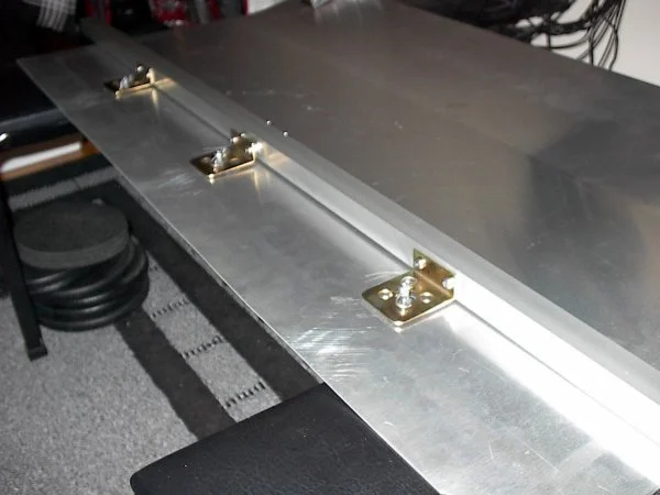

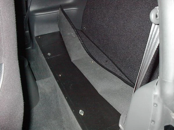

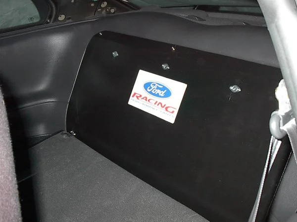

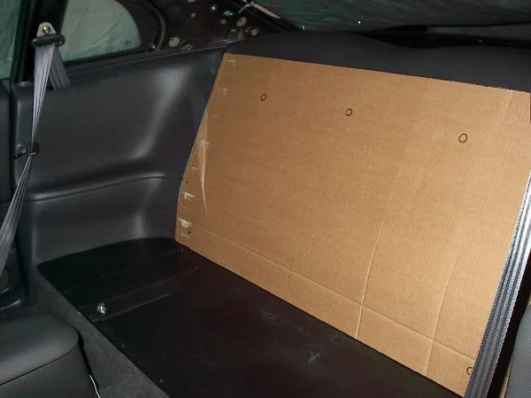

My seat delete
Hear is some shots of my rear seat delete,..it's made out of aluminum and the carpeting is held on with dome fasteners. The aluminum is removeable and held in place with Dzus fasteners,...
