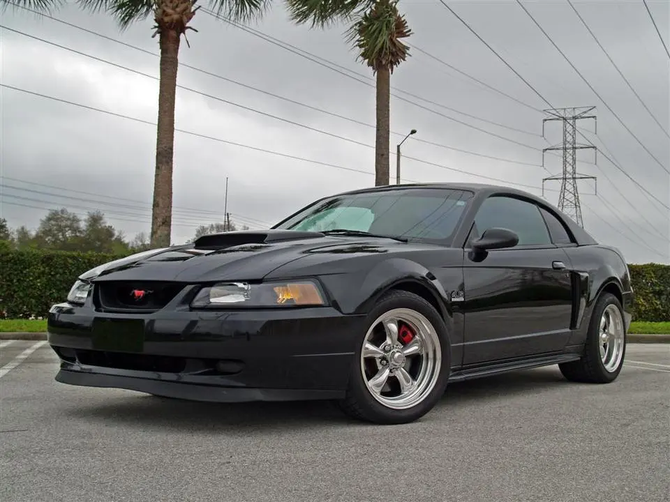

I cut a set of Mach 1 springs for my (gone but not forgotten) Black 2002 GT - 1/2 coil in the rear and 3/4 up front. The ride quality didn't change at all. I already had MM CC plates, so alignment was no issue. While I know everyone says, 'DON'T DO IT' I personally had great success with my minor chop and wouldn't hesitate to do it again.
