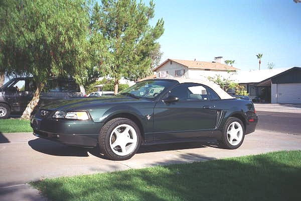

I was a teen hotrodder nearly 50 years ago, so I am getting re-acquainted with doing my own repairs, maintenance, etc. My little 35th Anniversary Pony sports headers, X-pipe, FlowMaster Delta Flow 50 mufflers, K&N intake, Diablo chip, 4.10 gears, Ford Motorsports clutch upgrade. Most of those upgrades were performed by a tuning shop, but now it's time for me to jump back into my old hobby and do my own wrenching. I ordered this car in February 1999 and I waited 16 weeks for it to be built and delivered.
