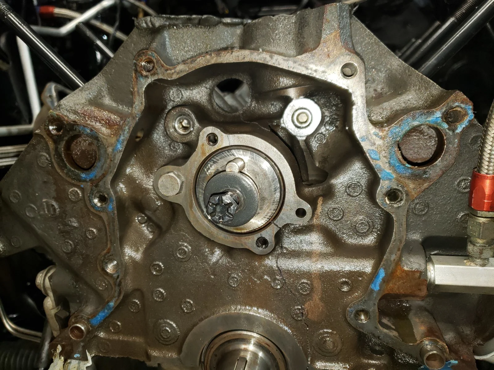

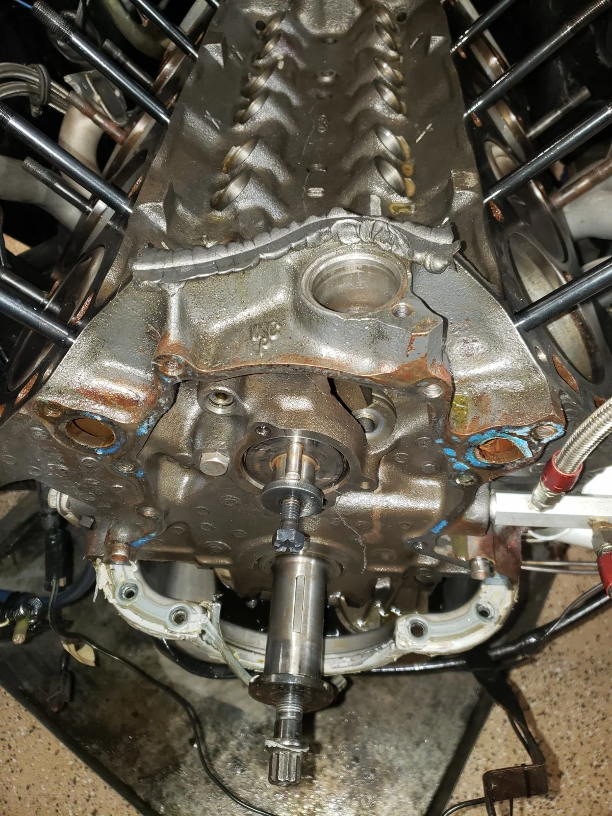

Mustang5L5 said:
In to see block in two separate pieces

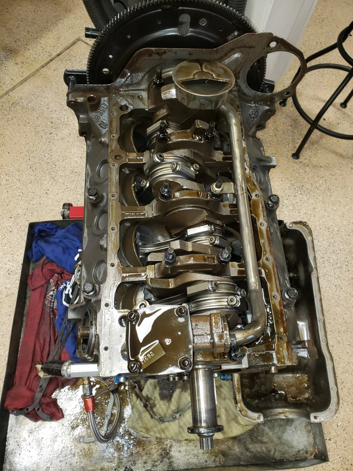

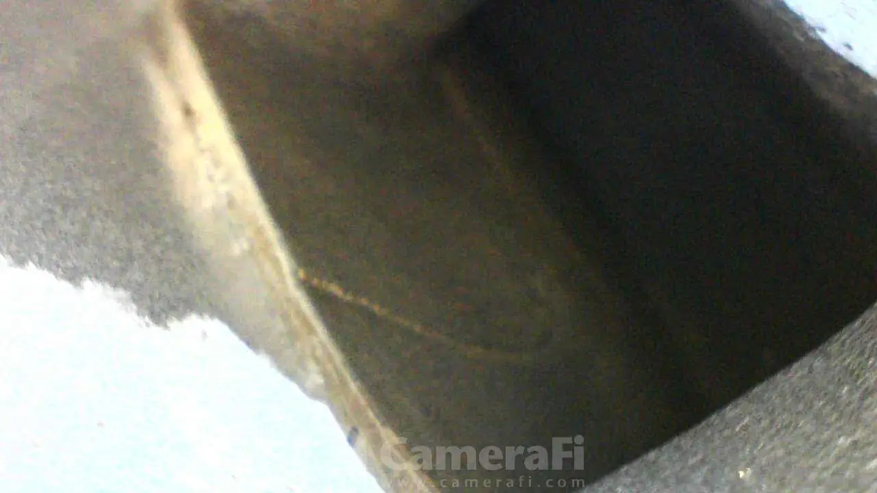

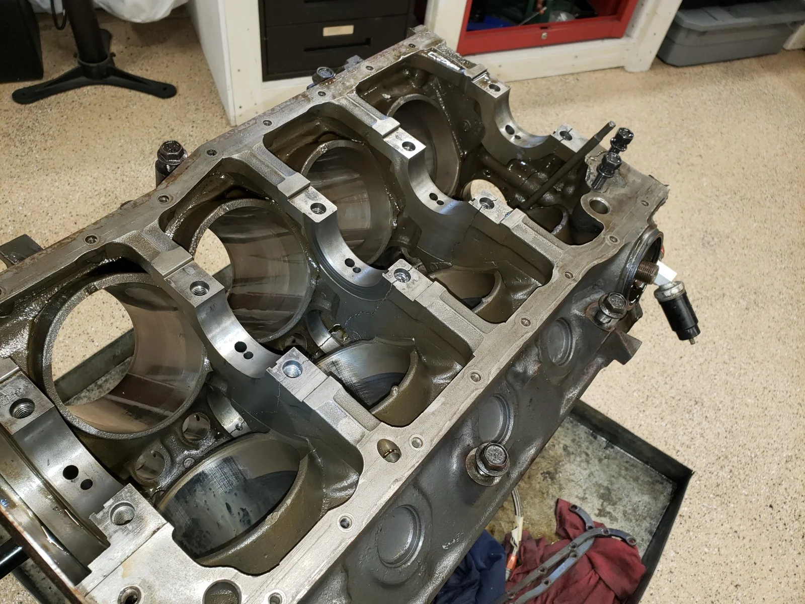

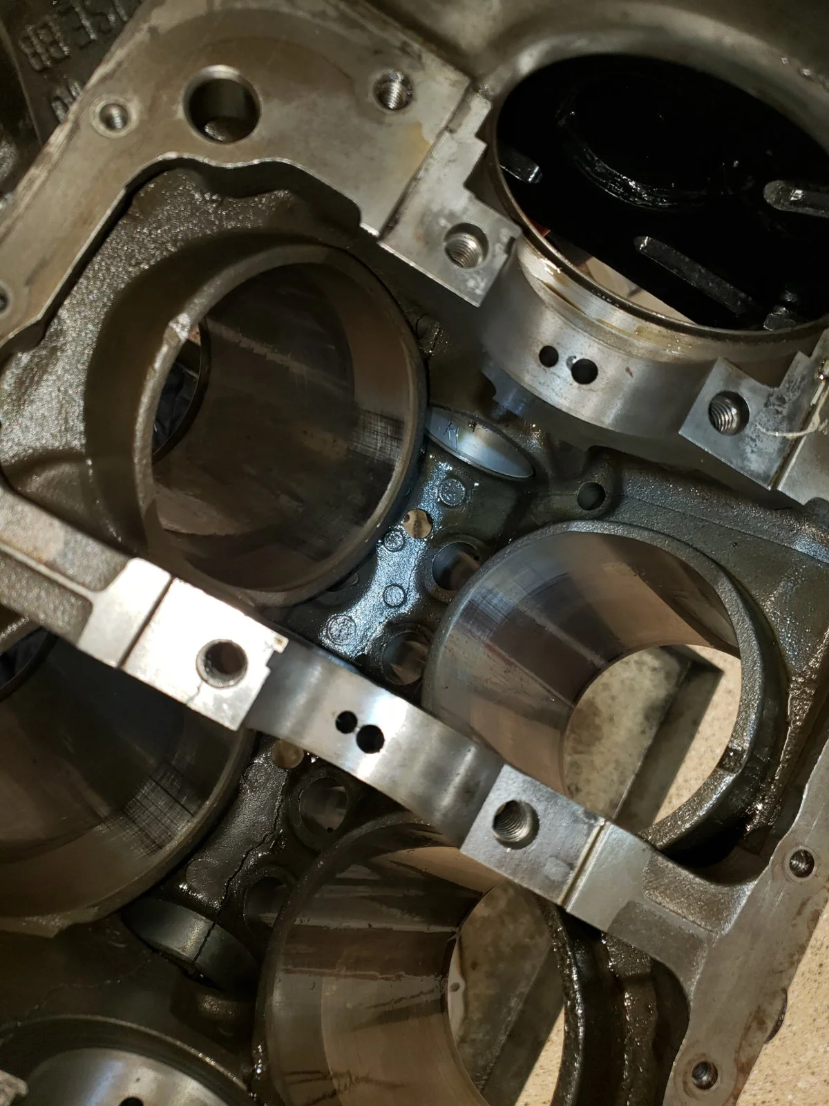

Almost put it in two pieces. Still surprised this didn't come apart, all of the drivers side main cap stud nuts (except the rear one) were loose when I pulled the pan off. All of the main caps (except the rear one) are cracked where the block split. It looks like the rotating assembly survived so I will at least be able to salvage/sell the rods and pistons.
Split the block the whole way back to the rear cam bearing and up into the block a little. I'm thinking the only reason the block didn't split completely in two was because of the thick SFI certified bellhousing the engine was bolted too.
Hard to see, but the crack goes past the last drain back hole and up and into the cam bearing hole. You can take a pry bar and spread the block to see the crack better. Not much material holding this thing together.

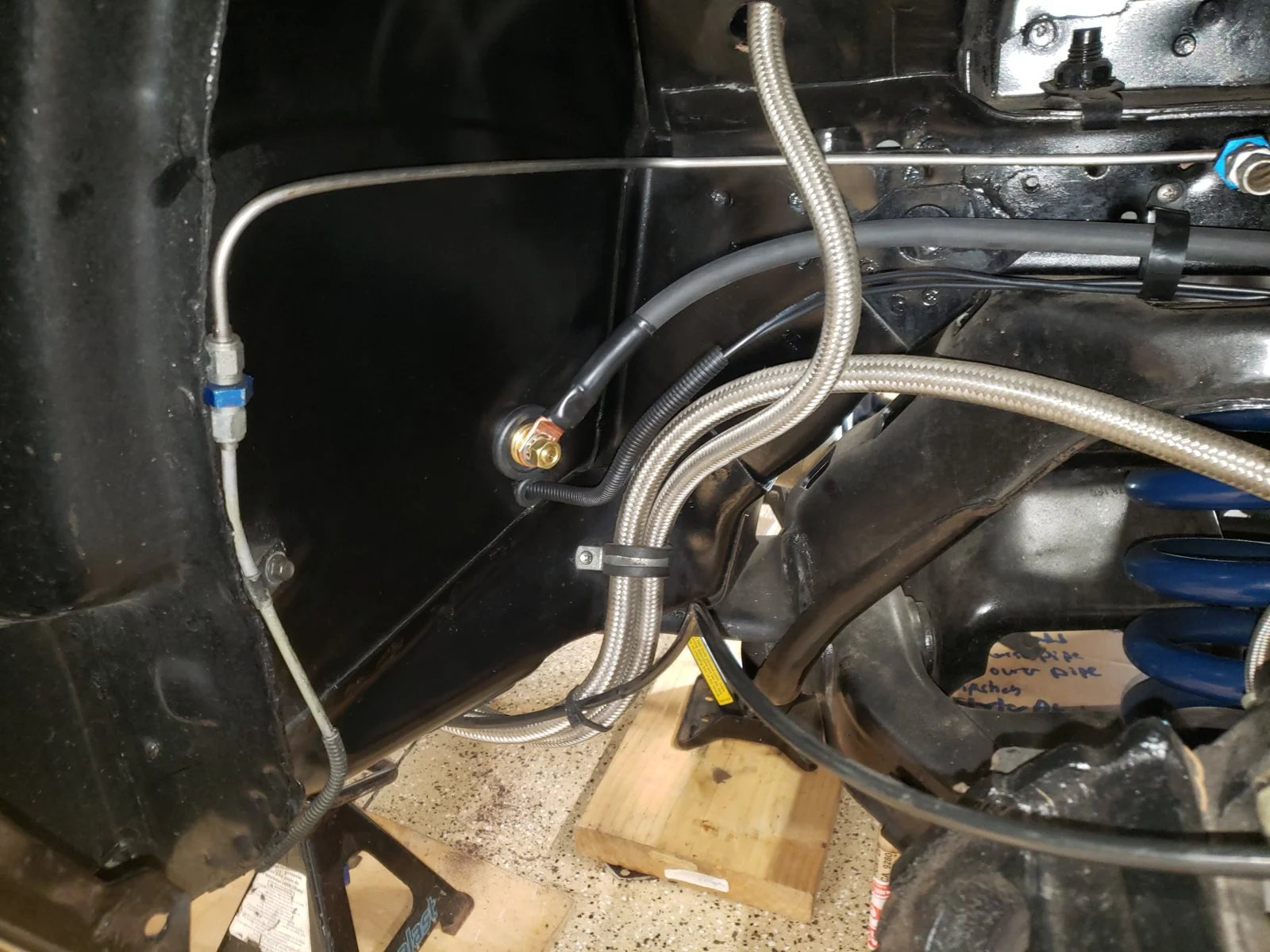

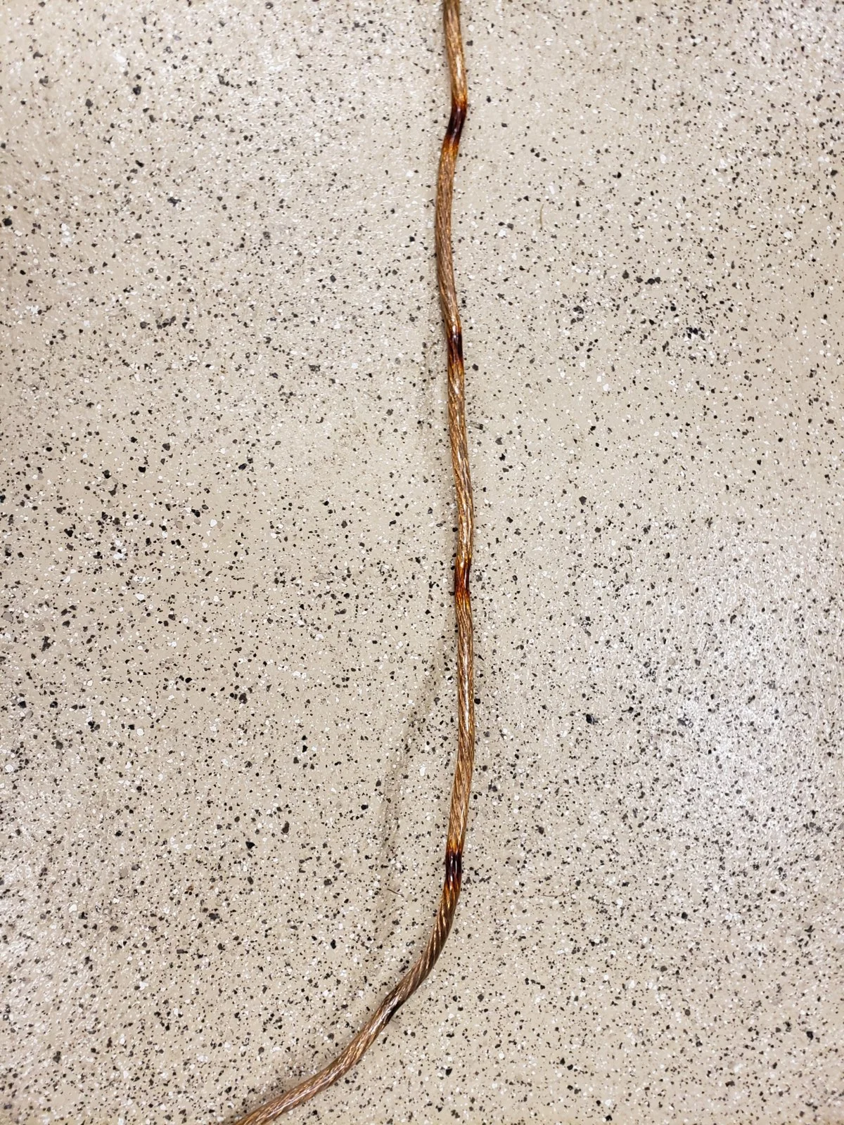

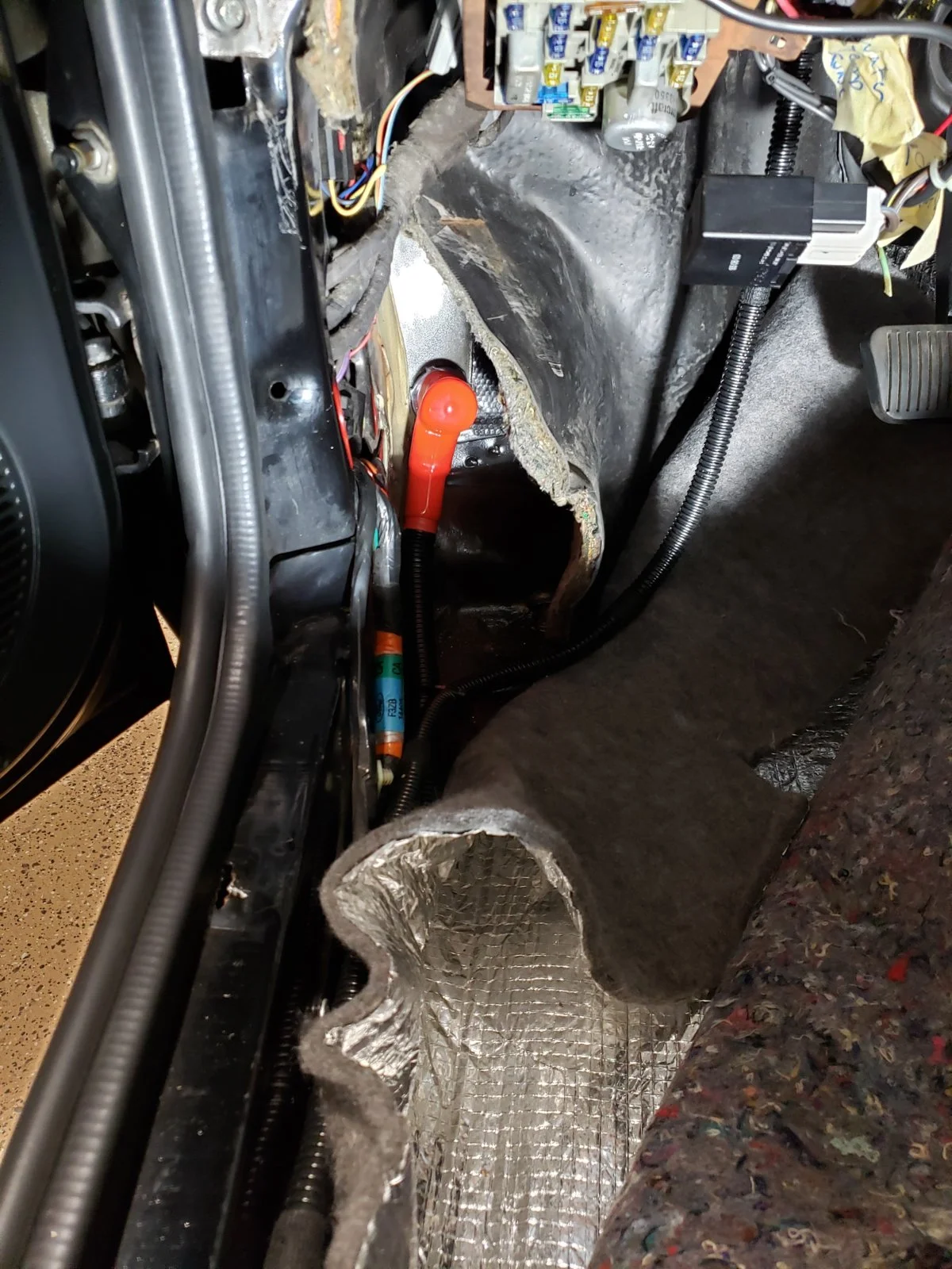

One of the first things I started working on was to re-wire the battery relocation that the previous owner did. He didn't do a horrible job, but he used 2/0 cable, didn't use grommets on the firewall penetrations, and ran the alternator output wiring through the cut off switch. I upgraded both the ground and positive cable to 1/0 welding cable, put in proper firewall grommets, ran 12 gauge cabling back to the cut off switch to disable the exciter on the alternator and properly strapped the cabling. I also ran cabling from the new ECU location to the rear of the car for future PWM control of the fuel pump.
This is the old positive 2/0 cable I pulled from the drivers side. This might explain part of the hard starting issues. Notice the heat marks in the jacketing.
Punched and installed the Moroso through firewall grommets for both the negative and positive battery cables.

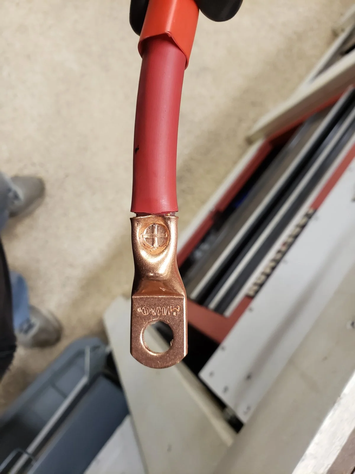

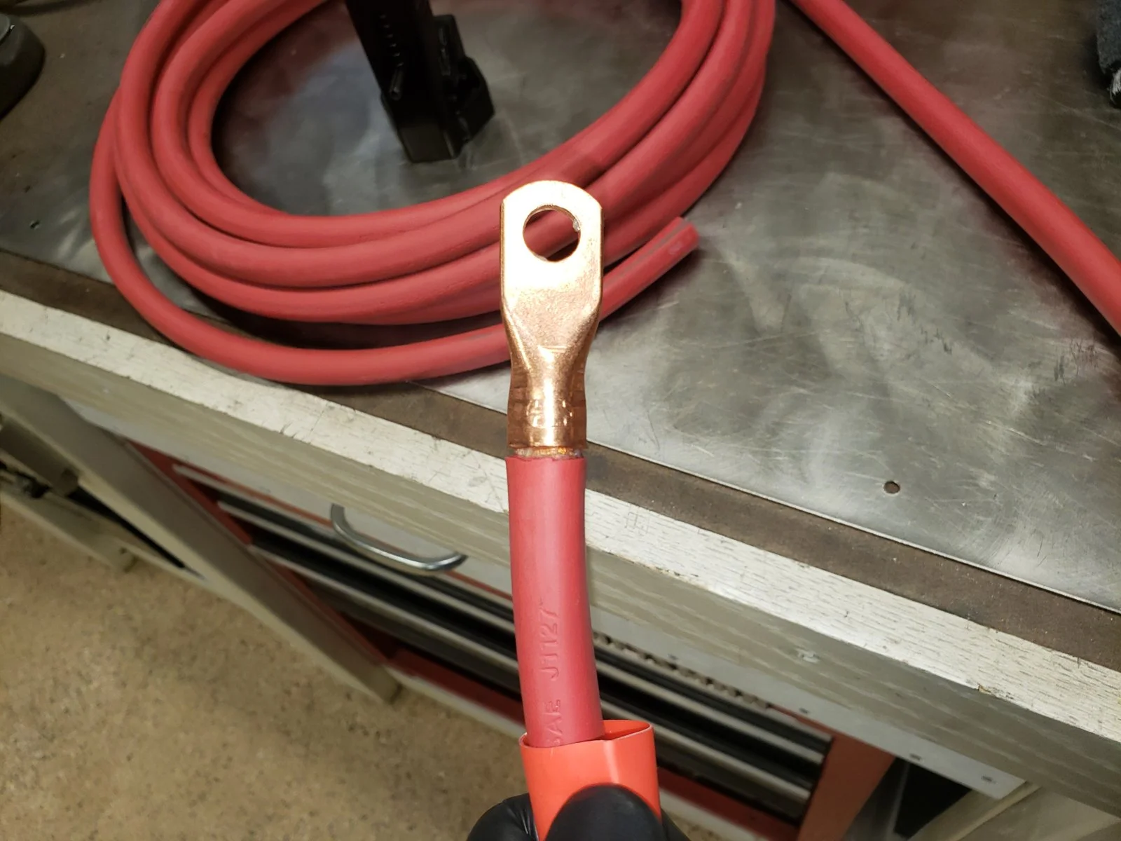

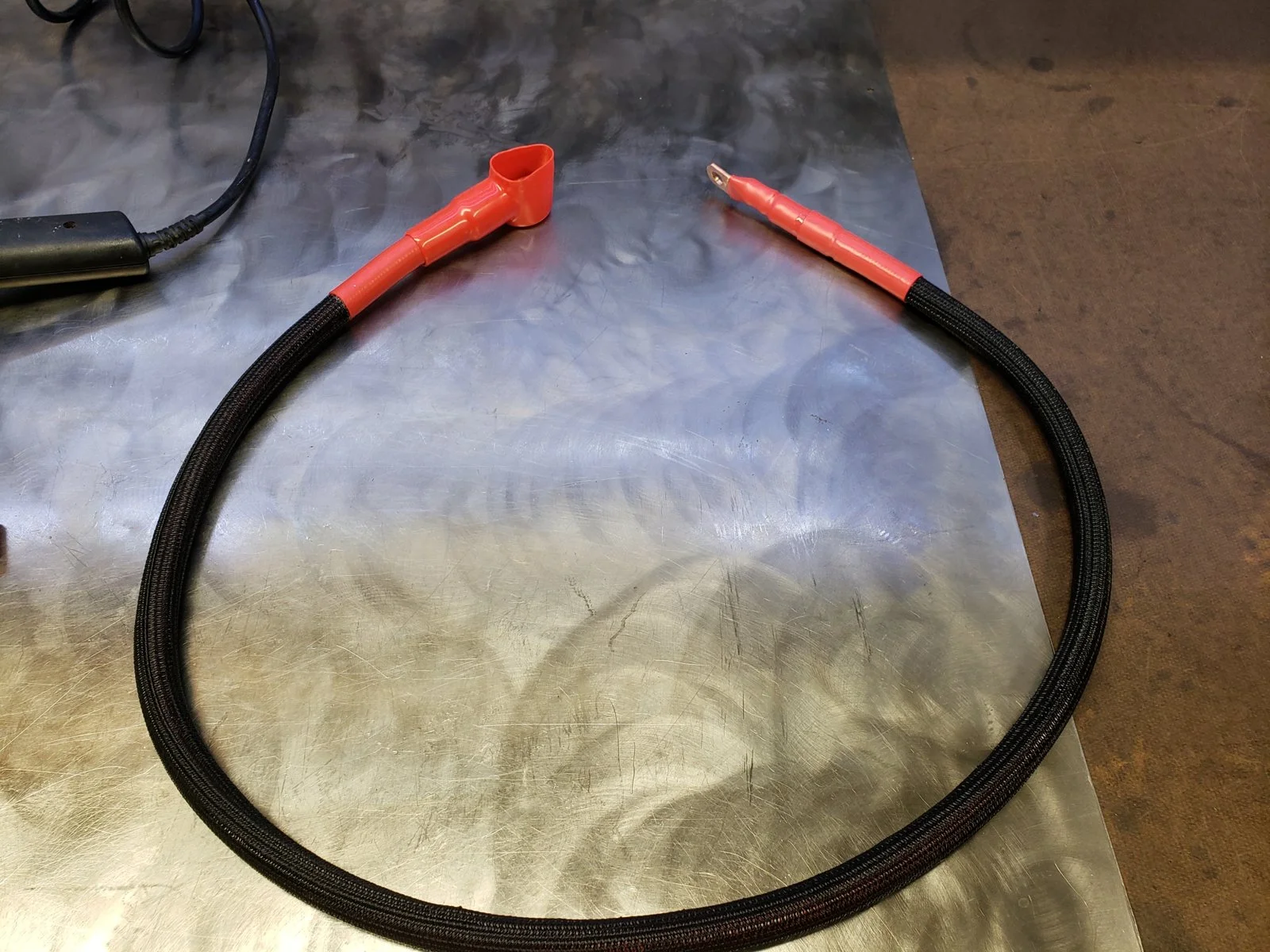

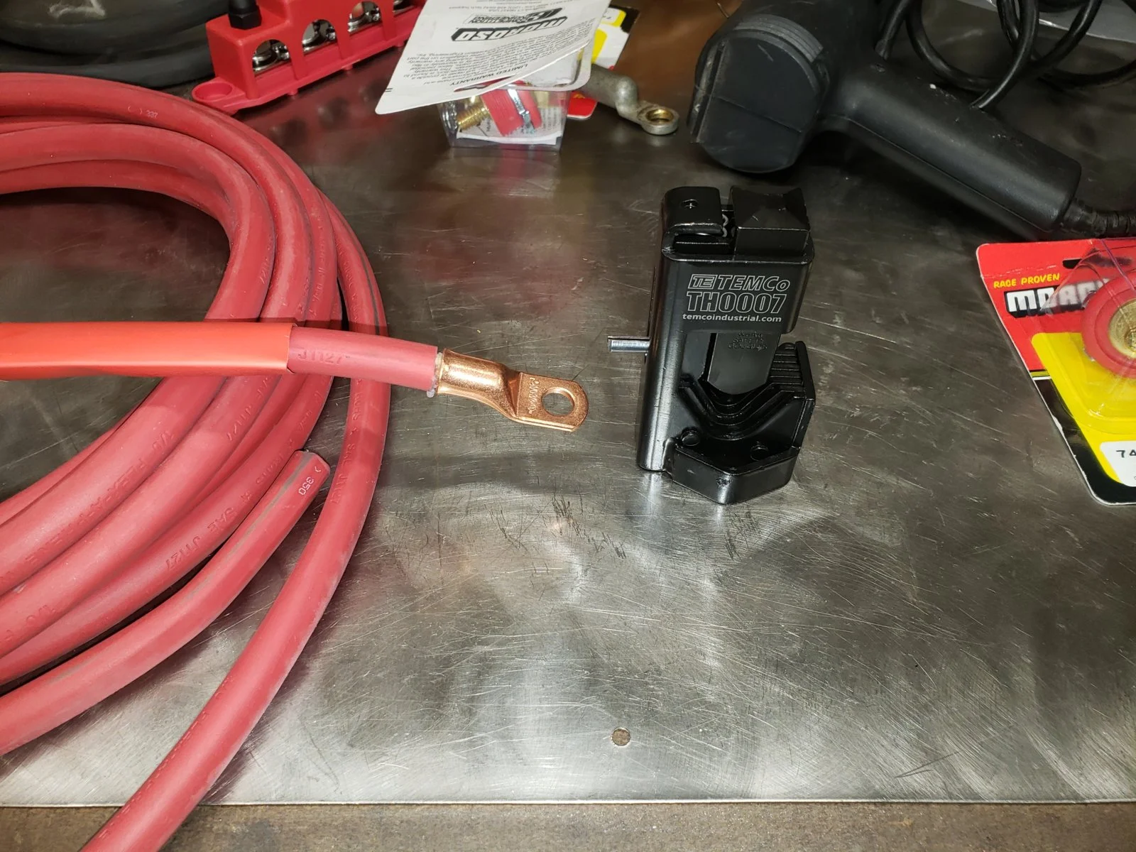

I bought this new crimp tool which IMO does a great job of crimping these larger connectors. I used to just crush the connector with my vise but this thing really captures the cable. I really tried to yank it out after crimping but could not get it to budge.
Just a finished cable picture.

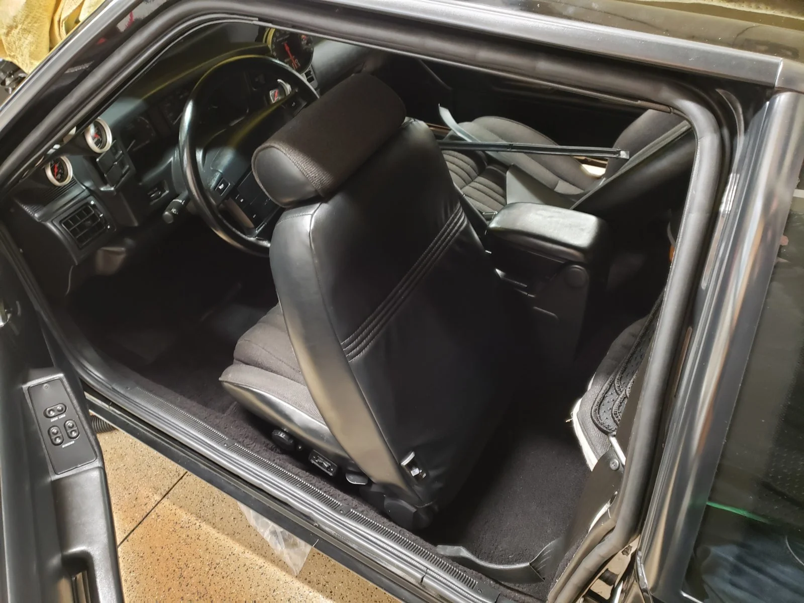

Installed my new door seals while I had the interior ripped apart.
When the guy originally built this car he spent the time to modify all the wiring harnesses for all the modifications he planned. He did a really nice job and then wrapped everything in electrical tape. Great for appearances, but a PITA to figure out exactly what he did and to unwrap to modify. Since I am switching to Megasquirt, all of the ECU wiring will be eliminated and I get to re-do everything else he did. I'm pretty sure I have 99% of the old wiring figured out at this point but I'm sure there will be some stuff that pops up.

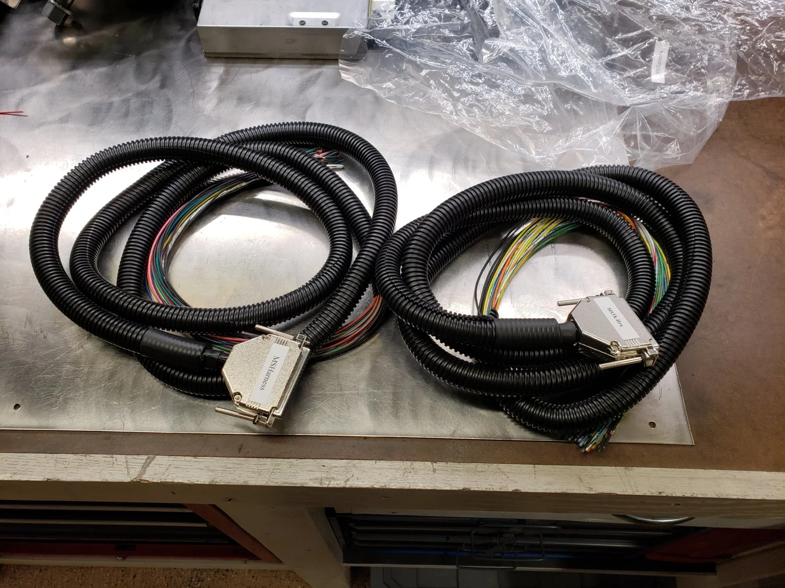

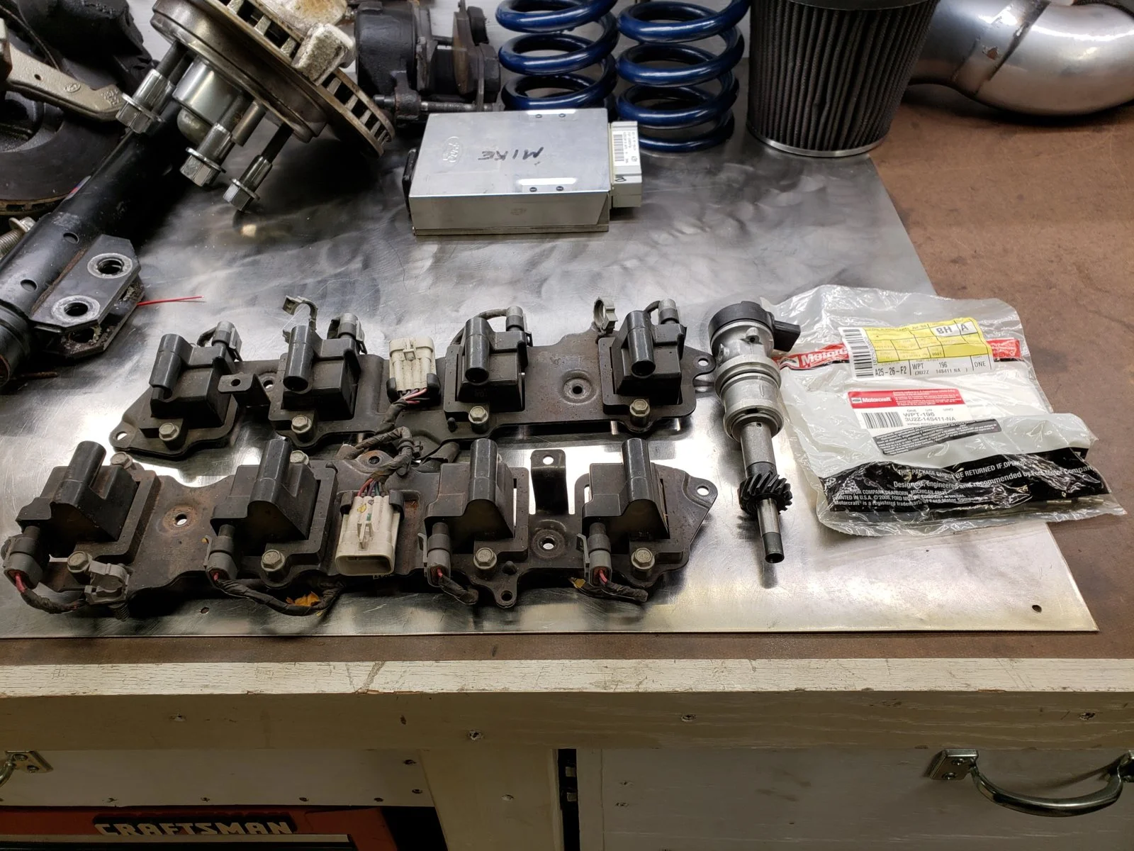

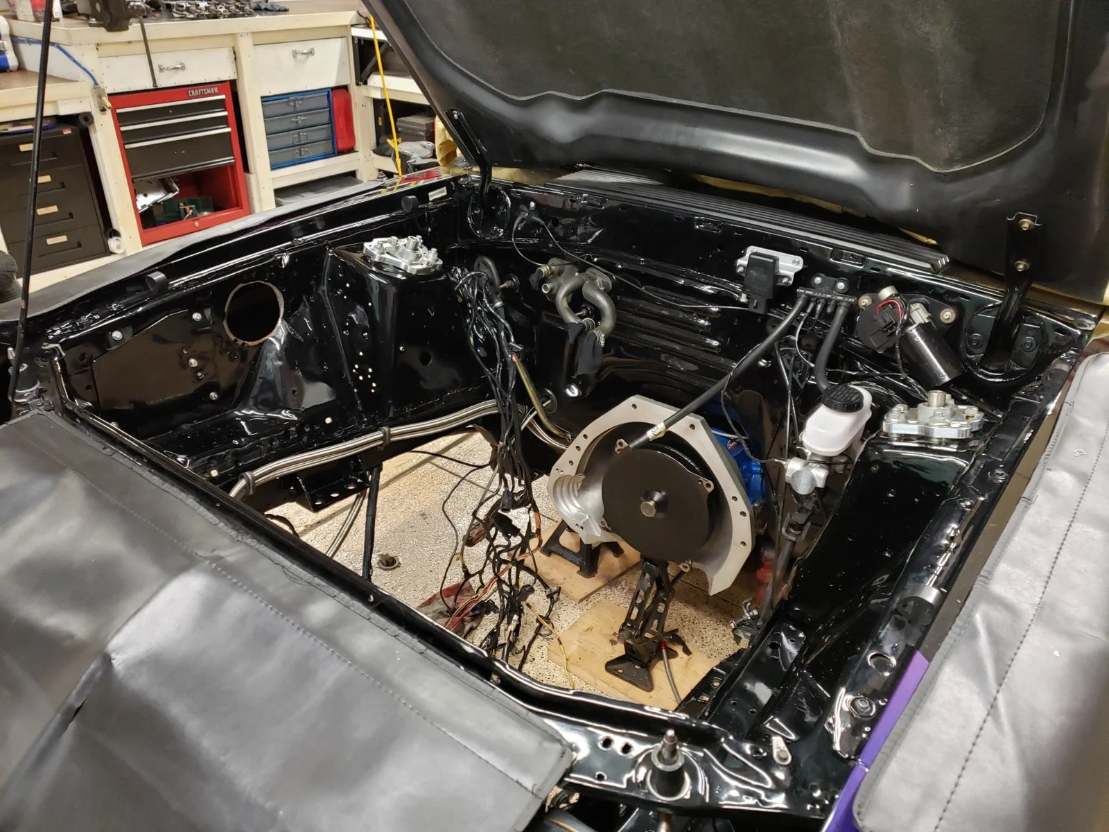

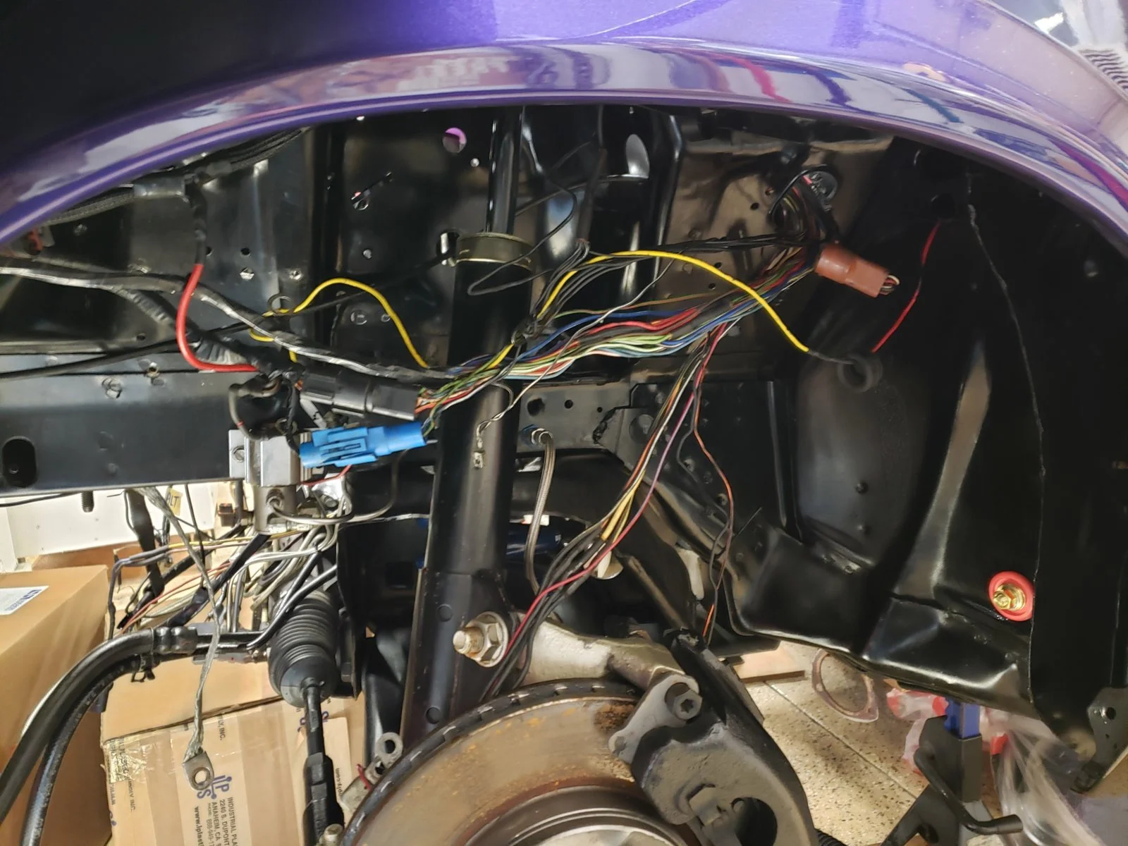

Got my MS3 and MS3+ harness to start re-wiring the engine bay. I'm consider myself pretty competent when dealing with this stuff but am sure I will have many questions on this as I move forward since this is the first from scratch megasquirt wiring project I have done.
I am going to be doing coil on plug with this engine. I actually had all the parts laying around. I'm thinking I should be fine with these LS coils for now as my current plans are for ~600rwhp. The cam trigger and harness is for a 96 Explorer (hall effect) and I will be doing a 36-1 trigger wheel. Looking for suggestions on how best to do the 36-1 trigger wheel (I will be buying a new HB for my zero balance 363 if that makes any difference).

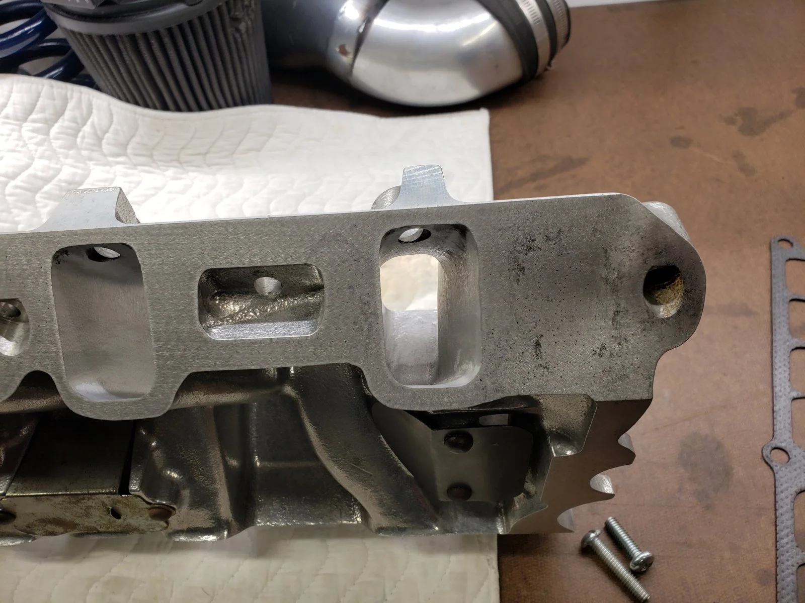

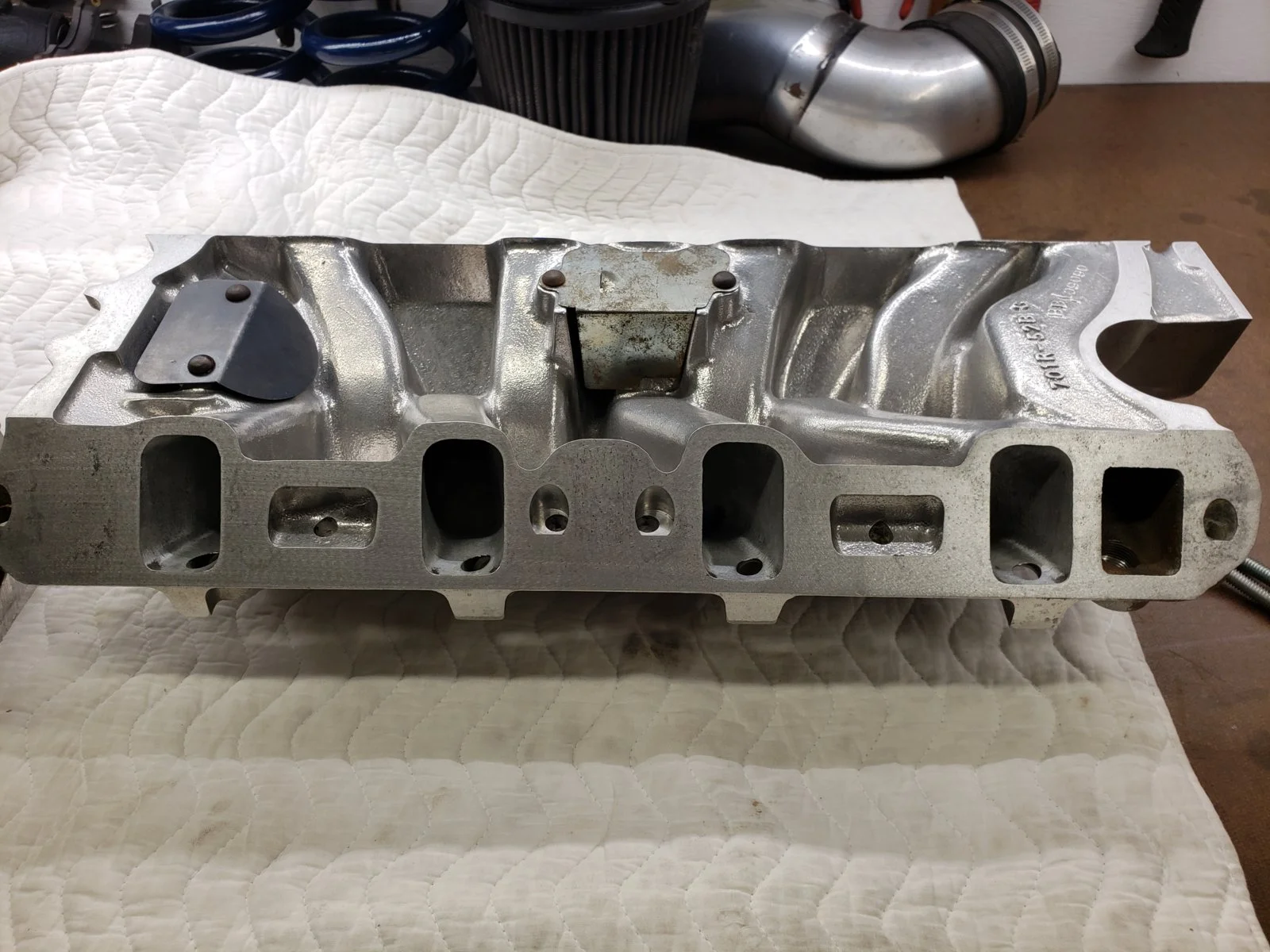

I sent the lower intake from my Systemax II to Tom and Matt Moss for porting. I'm really happy with the results on the lower. I just had them port it to a 1262 gasket and not the 1262R that my heads will be at since this isn't a max effort build at this point (plus it requires welding on the intake to do this). I figure I will see how this intake does and then upgrade down the road if needed when I switch to turbo.
I'm really surprised how the ports from the lower to upper don't align very well. Looks like I have some work to do to get these inline. I'm also going to be porting my upper to a 80MM throttle body opening. The mismatch is about the same on every port:

This weeks goal is to finish cleaning up and engine bay and finishing all the touch ups as well as get the UPR K-member installed and squared. I'm going to be sending my V1 to get the Si upgrade something this month also.
