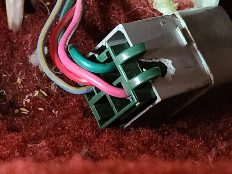

Fuel pump relay:
Blk/pink is constant hot 12v
Orange/blue is switched 12v
Red is switched 12v
Tan/Green no voltage

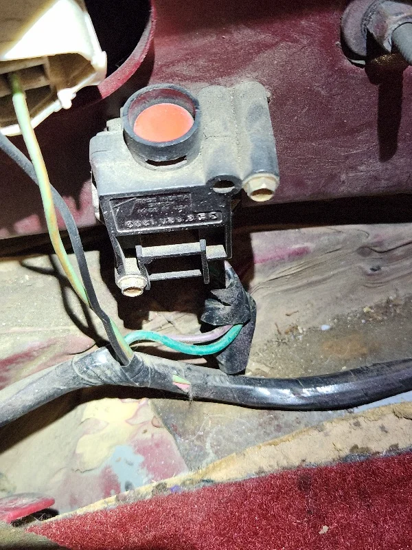

Inertia switch:
Yellow/green is switched 6.8v
Black/purple no voltage
Im not sure which pins to jump on the relay to test if it's a bad relay. I've attached an image of the relay.
The inertia switch had no power unless key was turned. Then power only on one side and less than 12v, showing 6.4v.
I jumped the connection at the inertia switch and it made no difference, no pump prime.
- Should the inertia switch be showing less than 12 v? If not what could that mean?
I'm thinking it's the relay but would like to test it before buying one. Per the color wires in my photo which terminals do I need to jump to test if the pump primes when bypassing the relay?

Oh, that bypasses the relay? I was wondering about jumping the relay terminals.
I tried the above and only got a click, pump did not prime.
It doesn't bypass the relay, it operates it.
The year of this would be helpful. There are several wiring versions. Some have the inertia switch located in different spots in the circuit. On some years it's in line with the pump and others its part of the relay control. They also use different wire colors.
I'd be cautious poking around jumpering things unless you are referencing a correct schematic. Accidentally sending power to a computer ground can be a bad day. Keep in mind the computer grounds the FP relay to activate it.
Myself and others can offer some suggestions, but need to know what year to give accurate info.

91-93 fuel pump wiring is in this diagram:
88-90 fuel pump wiring is in this diagram:
You need to check and see if the fuel pump relay has power from the battery (through the fusible link) and is getting power on the coil side of the relay from the ECU power relay. Once you have verified both of those then you ground the tan/light green wire (which energizes the coil of the relay) and see if the relay outputs power to the fuel pump. If you are getting power out of the relay to the pump then you will need to chase the wiring back to the pump so connector in driver side kick panel, back to the inertia switch, through the connector just above the fuel tank under the car, and through the fuel pump hanger connector.
What is weird is your relay appears to have the wiring colors of the 91-93 diagram but it looks to me that its under the seat co I am guessing this could be a late 91 or early 92 car?
One other thing, when you check for codes the fuel pump should do a prime sequence. If you do not hear it prime but you do not get a Code 95 then I would assume the pump has :poo: the bed.
