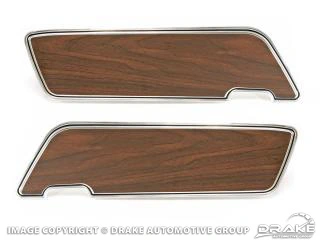

Using your example, the loss of value would be equal to the cost of obtaining originals of equal condition. The panels on the doors are available new in both the walnut and teak variety, although originals would be more desirable. No such luck on the dash panels, if they are damaged, you'll be out of luck if you can't find decent ones.
BTW, they are vinyl, so staining would be a problem. Paint, maybe.

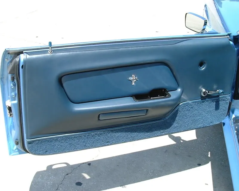

The repro comes ready to use:

Sorry, what I meant is that there isn't a black insert panel for the deluxe doors. Looking at the picture 2+2GT posted, I now see there is trim around the edge that I'd want to keep, even if I painted the woodgrain black or found some sort of black applique. So my fab plan won't work in this instance.
