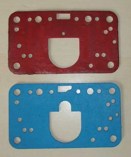

Hi all .... I have solved my problem. When I rebuilt the carb I used new, but leftover gaskets from various Holley rebuilds. I used a correct gasket on the secondaries, but the gasket on the primaries was as per the attached photo .... original red and the one I used blue ... as you can see the blue one has a cutout at the top of the D and this must have been what was not sealing .... running fairly well now just needs some time setting up idle etc. :nice:
