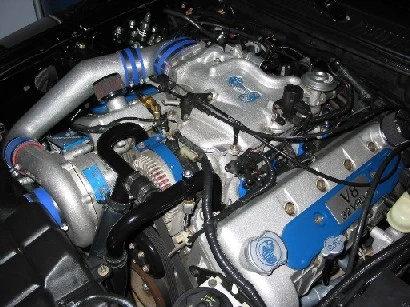

For detailing, I use a product called CD2. Makes black, black, and the paint on the valve covers and intake just sparkle. I can't find this stuff anymore at stores, but purchased some from here....Clicky
