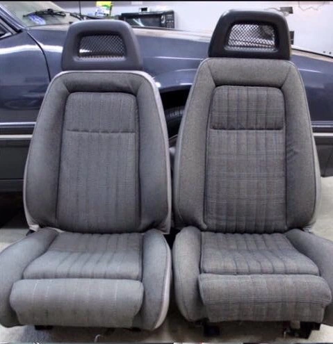

The 87-89 GT and 89 LX hatch sports seats all had large, tilting headrests. 1990 and later had small headrests. 84-89 sport seats had a 26" tall seat back, while all 90-93 and 79-89 non-sport seat backs were 24". The 87-89 seats with the taller back and big headrests tended to block out the rear seat passengers, so Ford ditched the higher seat models
Ignore the headrests in this pic. left is a 24" tall 90-91 sport seat (which should have small headrest), right is an 26" tall 87-89 sport seat (which should have the large tilting headrest)
