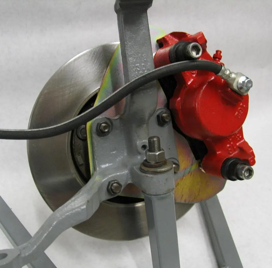

Let me clarify some misinformation that has been stated in the above comment, in reference to the "Cobra" name, with respect to the '60s-era Mustang disc brakes.
There has never been a disc brake system produced by Ford and installed on the '60s-era Mustangs that was referenced to as a "Cobra" setup, by Ford.
The simple act of installing a K/H rotor/4-piston caliper on a beefier designed early spindle doesn't make it a "Cobra" setup. It's just a K/H caliper and rotor on a stronger spindle.
The Cobra II's had Pinto brakes, so I won't even count them here.
Technically, and in the real world, the first instance of an actual Ford-produced disc brake system installed on a Mustang [that could be considered "Cobra" brake parts] came with the production of the 1993 Fox-bodied SVT Cobra Mustangs. These were 4-lug setups with discs on both front and rear of the vehicle.
--Even more technically so [in reference to the "Cobra" name] would be the brakes that were installed on the 1993 SVT Cobra R's [only 107 Cobra R's were produced. All were red in body color]. The Cobra R's were the very first Mustangs to receive the massive 5-lug 13" front rotors with the aluminum, twin-piston, PBR floating calipers. The rear brakes of the '93 Cobra R's had 11-5/8" ventillated discs with a single-piston Varga floating caliper. --These are the same brake components that carried over as the standard brake equipment for the 1994-2004 SN95-bodied SVT Cobra Mustangs.
For the '94-'04 Cobras, the word "COBRA" is actually written across the outboard face of the front calipers [visible through the spokes of the wheels]. All '94-03 Cobras have charcoal-colored calipers with the "COBRA" script on them. The 10th-anniversary SN95 Cobras [2004], had red calipers with the word "COBRA" on them as designed and produced from Ford under such designation.
'94-'03 Cobra calipers:
10th anniversary [2004] Cobra calipers:
'01 Bullitt Mustangs also had the same massive brake components as the '94-'04 Cobra Mustangs. However, the the only difference is the Bullitt calipers were red with a running horse insignia on the front calipers instead of the word "COBRA".
'01 Bullitt calipers [still, technically, "Cobra" brake components]
'03/'04 Mach 1's also had the same massive brake components as used on the '94-'04 Cobras and '01 Bullitts. '03/'04 Mach 1 calipers were charcoal-colored and didn't have either a running horse or a logo on them. [they were plain] but still, technically, they are real "Cobra" brake components.
The '93 SVT Cobra/Cobra R, '94-'04 SVT Cobras, '01 Bullitts, '03/'04 Mach 1's actually had factory "Cobra Brakes", but no vintage era-Mustang ever had any brake components [beefy spindle or not] that was referenced to as a "Cobra" setup, by Ford.

"Continental" or "Galaxie" big brake upgrade would be more accurate of a description, but definitely not "Cobra".
'69/'70 T/A Boss 302s [the factory-prepped race cars for the Trans Am racing series] had the beefy 4-hole flange spindles with larger pins and the larger hole for the outer tie rods. These were heavy-duty drum-style spindles outfitted with the larger 4-piston calipers/rotors from the bigger '65-'69 Lincolns or Ford Galaxies of the era.
However, the street-production Bosses didn't run drum brake-style spindles. They had factory single-piston floating calipers and a [true] disc brake spindle --the ones that are the close cousin of the Granada spindles. The regular production Boss 302s also had drum brakes on their 9-inch rears, just like the other regular production Mustangs.
Stock 1969 [non-T/A] Boss 302 front brake/suspension photo:
Even with the big Lincoln/Galaxie upgrade, the rotors are still 1" smaller in diameter than the 13" SN95 [true] "Cobra" rotors.

Yes, the rotor is 1" smaller but it is a fixed 4 piston caliper with big pistons instead of a floating 2 piston caliper. If someone wants a more period correct piece that doesn't require larger rims it is a good option... except for the fact that the brackets on the market today are WAY over priced.
The Boss 429s used the same brake rotors as the other '68-'73 Mustangs with disc brakes, but the hubs were different to fit the wider Kar Kraft spindles that were unique to the Boss 429s [early Mustang discs had two-piece rotors/hubs]. The production spindle pin for the Mustang is around 4.5" wide. The KK Boss 429 spindle was 5".
Boss 429s also used production Mustang drums on the 9-inch rears.
Dan had made reference to the Raybestos 6004 rotor [installed on an early, heavier, '70 Mustang spindle]. That is the 11-19/64" '65-'67 rotor for the associated [smaller] '65-'67 Mustang 4-piston K/H brake caliper. If he had been referencing the bigger Lincoln/Galaxie 11.72" rotor and the associated larger 4-piston K/H caliper, then the rotor number would have been the 6008 part number. The Raybestos 6008 Lincoln/Galaxie rotor is 11-23/32" in diameter, or two 'ticks' under 11-3/4". --So, to correct my earlier statement that the Lincoln/Galaxie rotor was 1" smaller than the SN95 Cobra 13" rotor isn't correct. It's actually more than 1-1/4" smaller than the Cobra rotor. [I thought the 6008 rotor was a full-12", but it isn't]. --Also, putting a '70 spindle [actually, any '67-'73 Mustang spindle] on a '65/'66 Mustang will give you the same incorrect steering geometry as using wrecking yard Granada spindles on a '65/'66 Mustang.
Stock 14" wheels will fit over the standard '65-'67 Mustang K/H disc brakes, but I'm fairly certain the stock Mustang 14" wheels will not fit over the larger Lincoln/Galaxie K/H brake version. If this is correct, it would require 15" diameter wheels, minimum, for the bigger Lincoln/Galaxie setup.
I'm not sure what the actual reasoning behind going from fixed calipers to floating calipers [really] was (?). The 'popular belief' seems to be it was because of a production cost-savings thing [cheaper to produce].
I might would believe this was totally true on your average production Ford Taurus, Chevy or Chrysler 'Whatever', but if a "fixed" caliper is "better" than a "floating" caliper, why did a high-end [expensive] car like a '94-'04 Cobra come with floating PBR calipers if "fixed" was really better? --these weren't ["cheaper"] production brakes taken out of the common parts bins that were going on the other commonly-produced Mustangs/Fords. This was a more expensive, secialty brake setup.
Maybe you know this and maybe you don't, but the C5 Corvettes, --a very high-end, expensive car --even more so than the Cobra Mustangs came with a twin-piston, floating PBR caliper & 13" Brembo rotor that is very close to the same design as the PBR floating twin-piston caliper and 13" Brembo rotor that came on the SVT Cobras.
http://image.gmhightechperformance.com/f/8749118+w750+st0/0602gm_brakes_z.jpg
The Corvette is geared toward a market that is generally much more financially secure and can more afford a high-cost car like the Corvette. If the fixed caliper really is so much better, Chevrolet could have easily installed the more "expensive" fixed caliper design and simply passed that cost onto the consumer, in the price of the car.
A possible reason domestic auto manufacturers got away from fixed calipers, since the mid-'60s, may be because as long as the rotor on a fixed caliper setup has a tight axial and radial runout, the caliper is happy. As the rotor gets hot though, it begins to expand. As long as the rotor remains "true", things are fine. However, if the rotor does not expand evenly, or if it gets too hot, it will start to distort. As the distortion tries to pass through a fixed caliper, the caliper has nowhere to go. This produces the phenomenon known as "knock-back" where the rotor slams the pistons of the fixed caliper back up into the piston bores of the caliper, since they are the only things that can give.
A floating caliper does not have this problem. Since it "floats", it is able to follow along with any in-or-out movements of the rotor's friction surfaces and is still able to grab the rotor to reduce the vehicle's speed.
Like I said, I don't know what the definitive reason is behind why domestic auto manufacturers switched over to floating caliper systems, but these are just some things to consider as to why they did.
A fixed caliper is superior in performance to and equivalent floating caliper, if only by a little bit. Fixed calipers are more expensive then the floating calipers, they require more maint. and over time can require recentering on the rotor. I imagine all of these together make a good argument for most manufacturers to use a floating design. You will notice on the true high end cars that they don't use floating calipers, they don't need to save cost on production and they expect people to be ok with the added maint. cost down the line.
