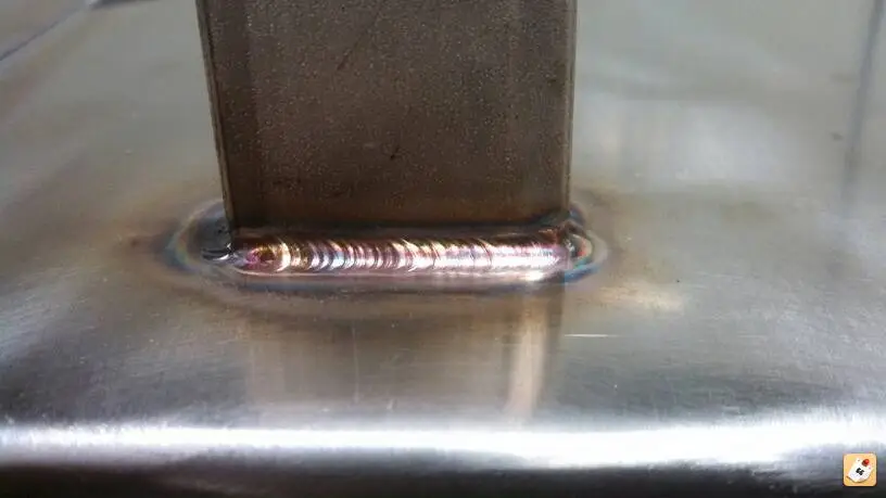

To me the hardest thing about welding on the foxes is all the damn galvanized coating...be careful and use a mask.
I'm a certified welder ;)
