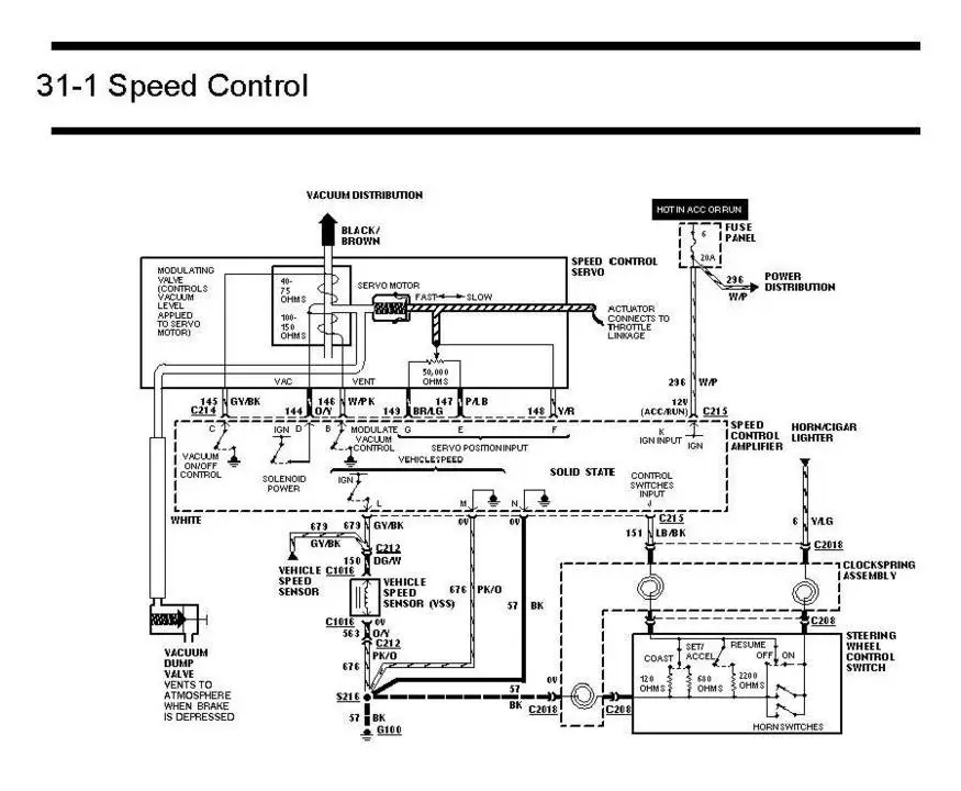

Does Anyone Gave A Wiring Diagram For 87-89 And 90-93 Cruise?
93 Speed Control
PM me your email address and I will send you a complete Ford Factory 89 Mustang electrical diagram set. The zip file is 2.5 MB and is too big to fit through Stangnet's email gateway.
They are in a zip file format to reduce the size of the package. You’ll need WinZip or other Windows archive tool to extract them from the zip file. See www.majorgeeks.com - Download Freeware and Shareware Computer Utilities for a free download.
You will need the Adobe Acrobat viewer which is also a free download – www.adobe.com/products/acrobat/readstep2.html - Adobe Reader download - All versions
Do you know the possible causes for cruise not working on a 91 5.0 with airbag? I have the cable hooked up to the throttle body with a clip, the steering wheel switches are good and the horn works but it will not hold speed. Do you have the diagram for a 91? Thanks
