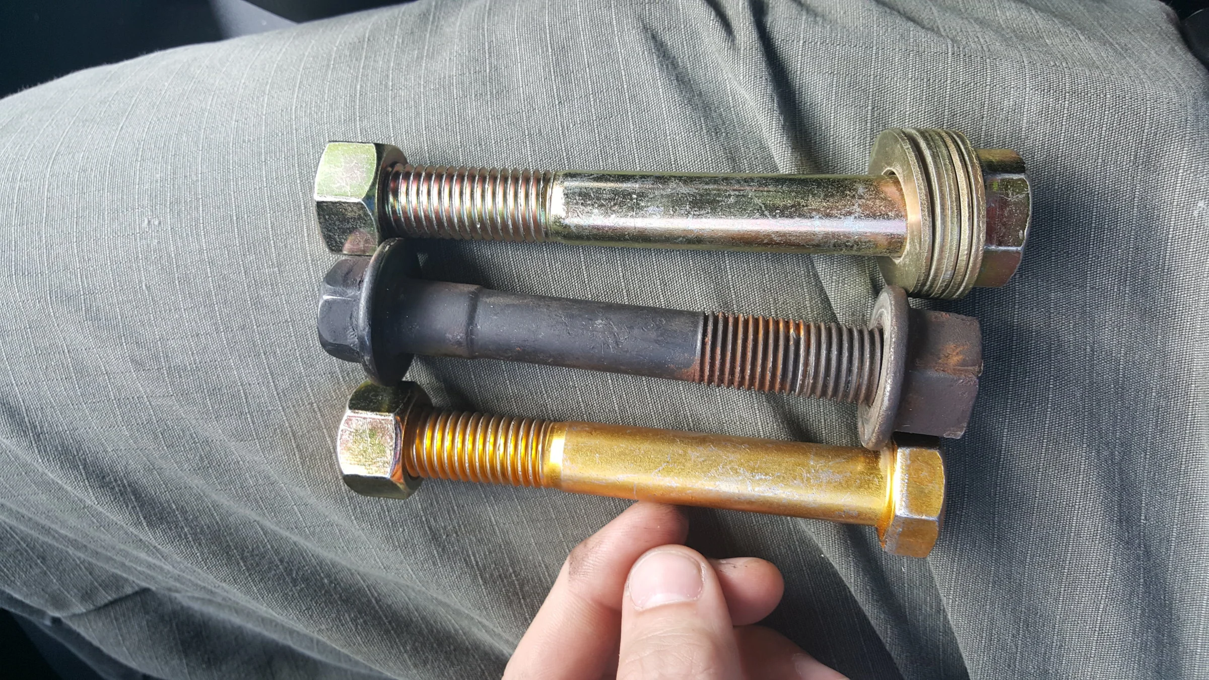

I am in need of a lower control arm bolt. i cannot finish my install without one. naturally first 3 were no issue to get out last one had to be cut out. jegs and LMR want over $50 for a set, and it'll take a few days to get here. does anyone in the above mentioned area have one handy??? I will gladly buy and pick it up.

yep. I've tried 3 places in person and called another handful. fastenal has offered the best scenario which is $40 for 5 of them (must buy 5) and they said MAYBE they can have them Friday, Def by Monday..... which is why I'm trying to find someone local who has 1.

pic below

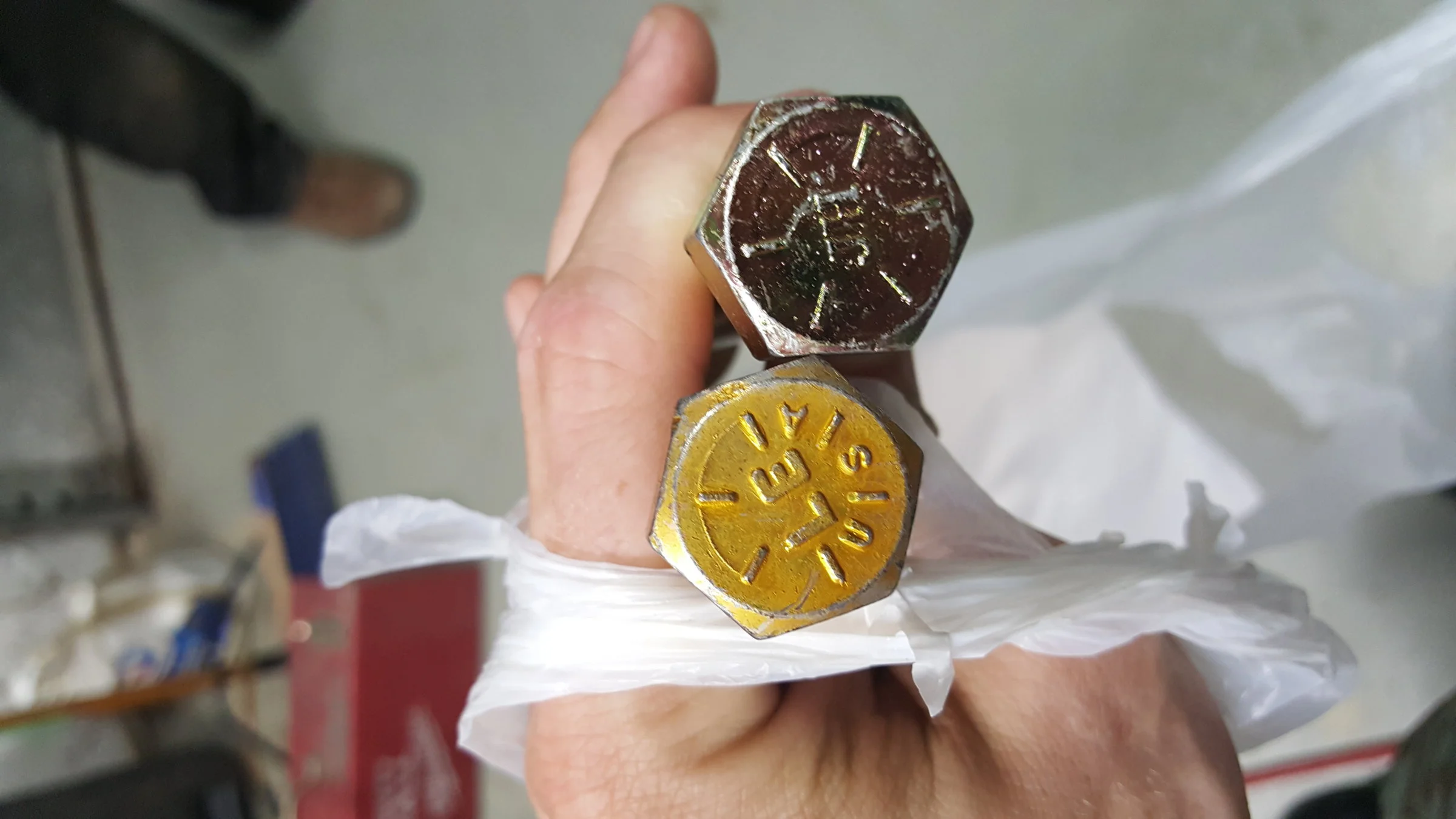

I was told these are grade 8, which is the same as 10.9 (1 metric and 1 standard). it was a fastener place and the guy seemed super knowledgeable.. . should I trust it, or just bits the bullet and order the :poo: from jegs?

Fastener guy said they were grade 8 on a metric bolt? They should really be graded on the metric scale here. Can you show a picture of the head to see the markings? Also, can we see the markings on the head of an OEM bolt?
Will do. The bolts are at my buddies shop. I will be back down there tomorrow evening, will upload photos as soon as I get there. Will be around 6 pm.
