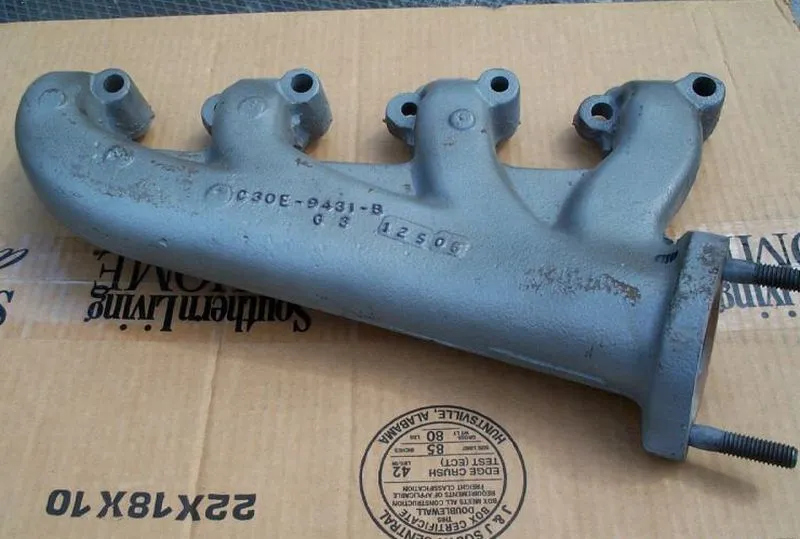

2+2GT said:
I have used both OEM and repro HP manifolds, and found the repros to be superior. Two reasons- Originals are most commonly the C7ZZ type, used by the factory in the latter part of 67, and for nearly 20 years over-the-counter. They have a deep notch on the upper left corner of the ports to clear the smog injectors, and are more apt to leak. Functionally, the core support "bungs" on the outside of the OE are also on the inside, right in the radius of four of the ports, blocking optimum flow. Repros use newer techniques, so the bungs are on the outside only, purely cosmetic. Either way, if you port-match your heads to the large HP manifolds, and clean up the roughness or bungs inside the manifolds, they work pretty well.
I suppose what I was getting at is that there could be quite some variance in the manufacturing. The castings in the article look different than the ones you posted pictures of which look different than the photo on CJ Pony Parts. The outlets are definitely not the same size, either. C6OE log top, D3OE "hipo" bottom left, C3OE log bottom right.

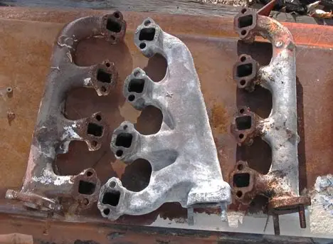

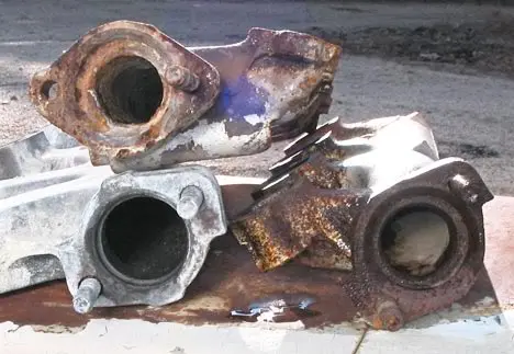

68xstang said:
Some people claim that the early 351W manifolds give slightly better performance than the hipo.
What casting numbers should I look for when searching for a good pair of 351W manifolds??
C9OE-9430-B and C9OE-9431-B
The only reason they might say that is the 351 had 2.25" outlets, while the HP had 2". This was offset by the odd angle of the LH 351 outlet.
No such weirdness with the HP manifold:

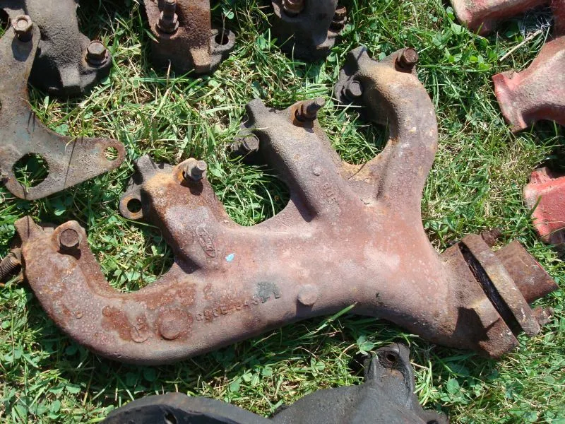

65ShelbyClone said:
D3OE "hipo"
No such thing. There was a kinda-sorta Maverick manifold that looked like one, but it was one side only. The matching piece was ordinary straight crap.
