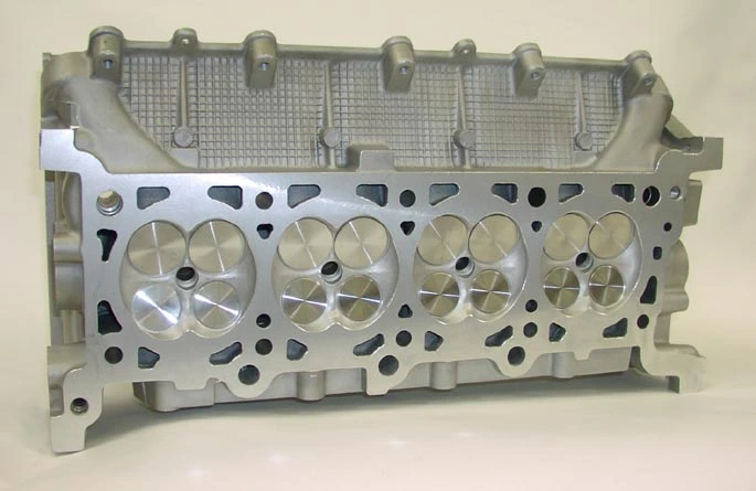

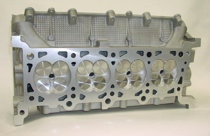

your heads look like this (minus porting, lol):
cobra heads look like this (minus extra large valves):

THE PICS ABOVE YOU CAN SEE THE CIRCULAR VALVES ( 2 in the top and 4 in the bottom pic) PER CYLINDER
