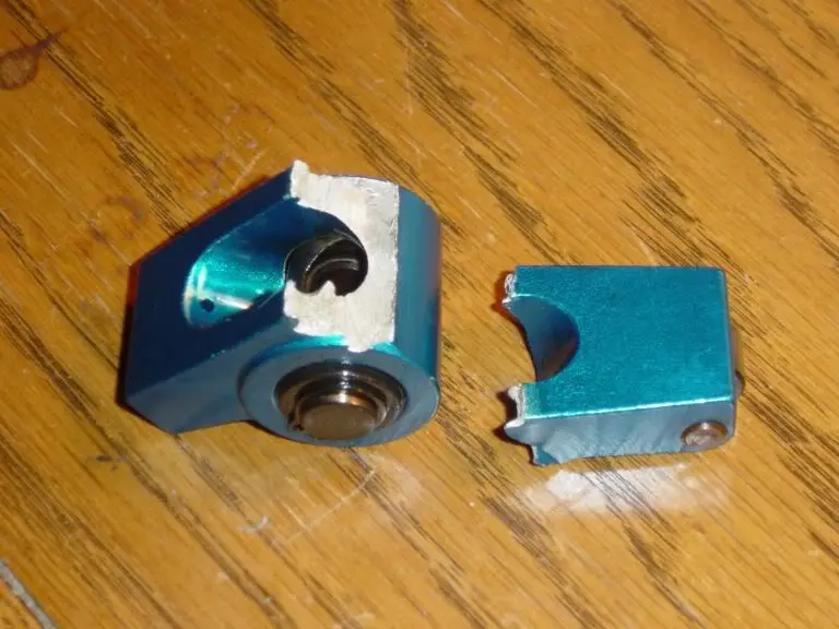

DONT BUY CHEAP ROLLER ROCKERS!...Here's Why..(pics)
Just got back from Joe Heck Racing and picked up these from Joe Amato for $289 .... http://www.fordracingparts.com/parts/part_details.asp?PartKeyField=632
They didn't have 1.7's in stock so I got the 1.6's....MUCCCHHH better quality than the ones I'm taking off
Will be using this order to set the valve lash to 1/2 turn preload

I'm not sure if your camera is up to it, but I would love to see some close-ups of the fracture surface.
I doubt anything revolutionary can be learned from it, but I am curious...
(I look at fatigue fracture surfaces at work every day)

Yeah no prob it might be a day or two till I get some up but I'll deff get some.....You can see how if you put it together the top and bottom of the fracture aren't completely touching anymore (just the middle obviously).....Once it started to open the valve and started to bend it finally snapped.
