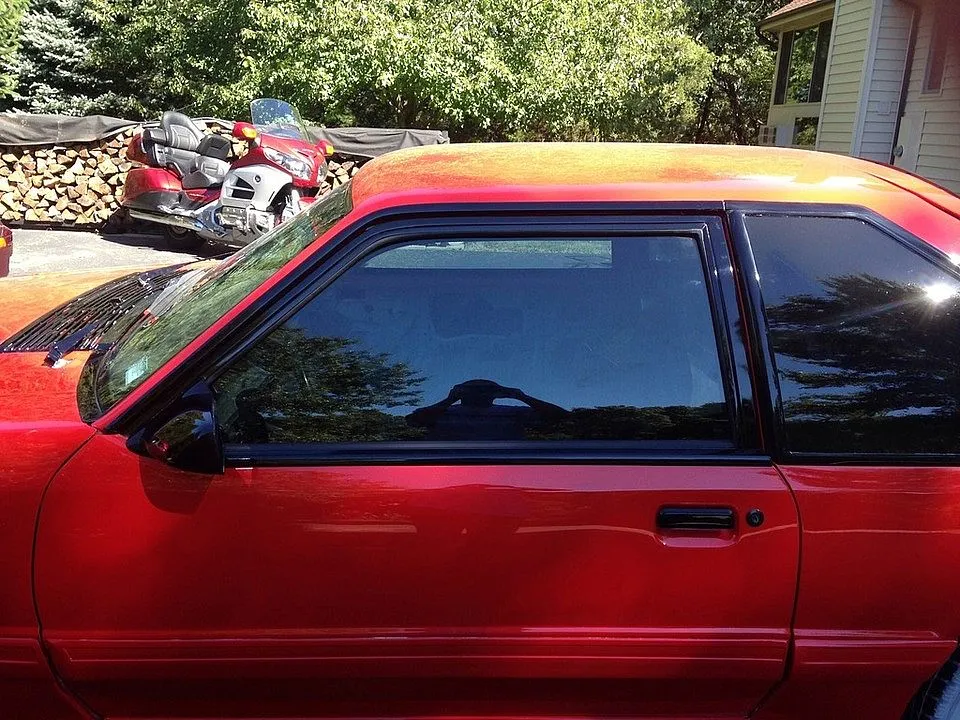

Mine were bought from LMR a quite a while back. I never really took super close up pictures of them, but you can somewhat see in this picture what I mean. I don't think they are "shorter" really, it is just that they are kind of wavy/uneven compared to the OEM ones, they were definitely stiffer and didn't conform as well.
For my project I had actually bought two doors from a 1987 GT and figured I could use them, but he stripe caused me a lot of issues and I ended up junking those moldings which is why I bought the aftermarket ones. I had really good luck with my blue GT taking the metal strips out and then painting them and attaching them - although you have to be extremely careful with not cracking the paint upon reinstall. I thought the metal strips could be bought now, but that was 20 years ago!
Anyway, here is the best picture I have of the LMR moldings which I bought in ~2015 I think.
