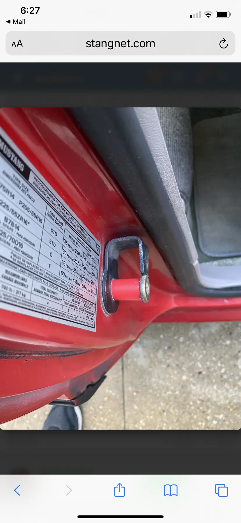

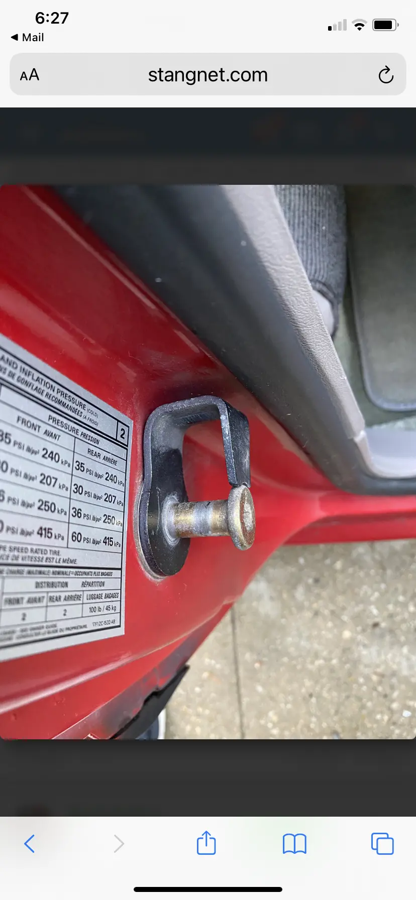

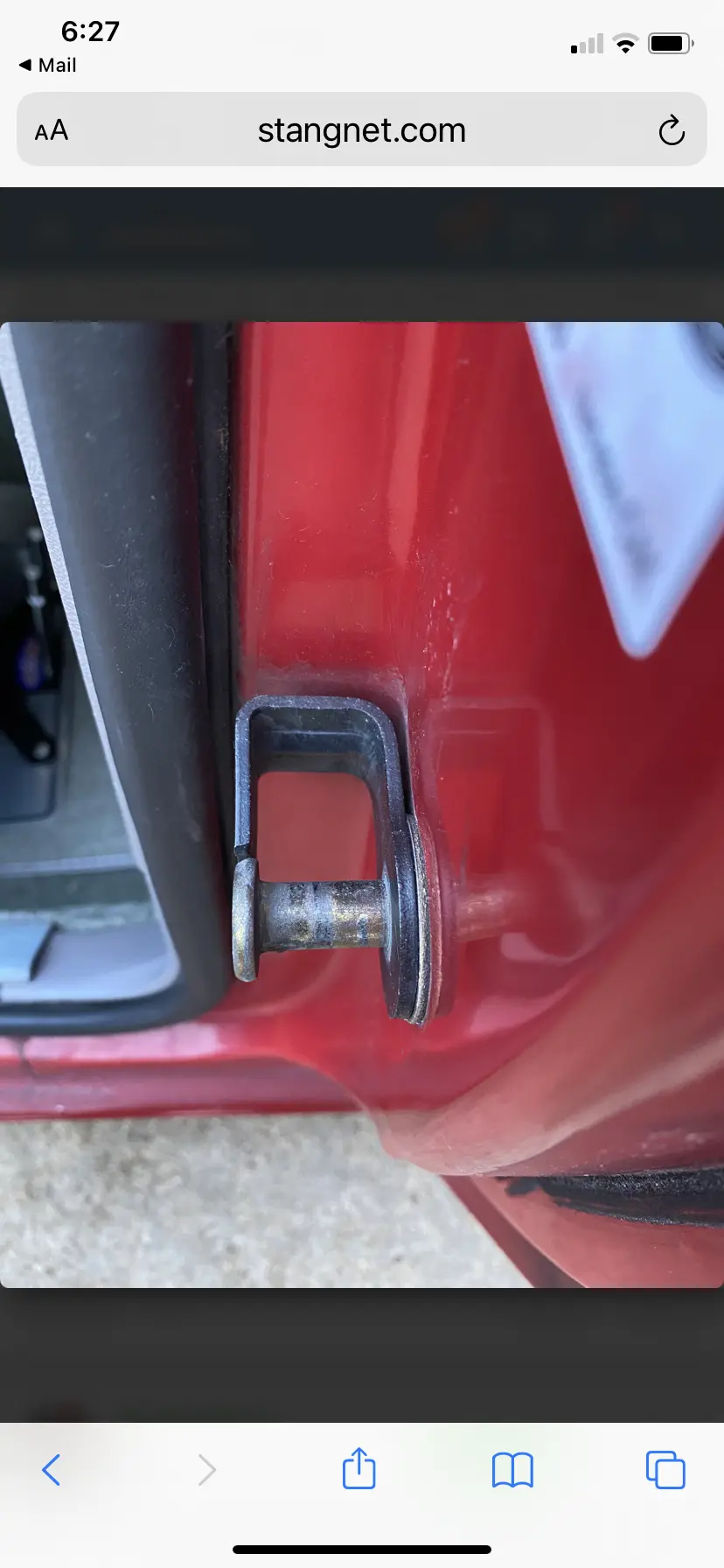

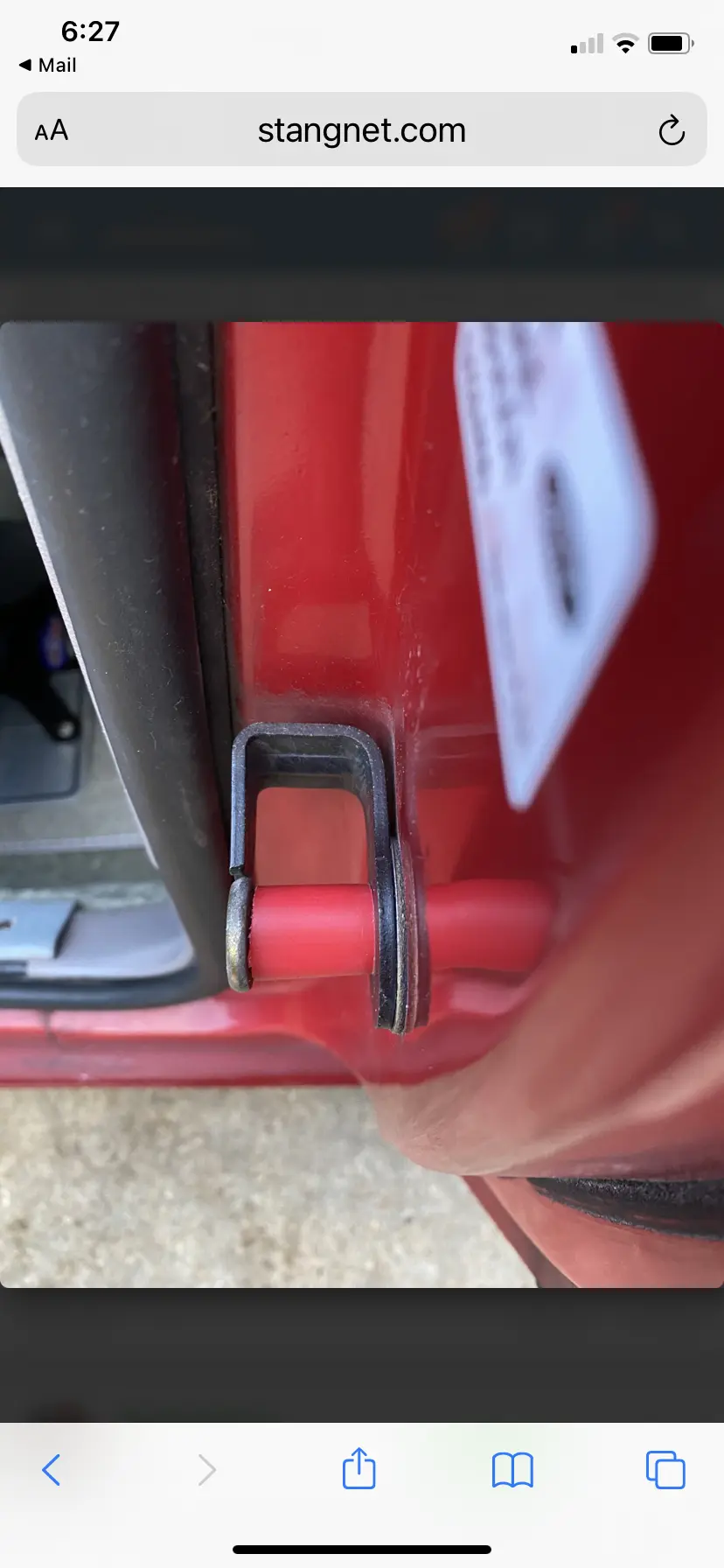

If your interested in an awesome cheap and quick fix with no risk that works incredible, buy a piece of 1/2” PEX in whatever color you like from Home Depot, cut it to length which is slightly less than an inch long and then with a razor, slice the piece down one side. Now put the tube that you sliced in front of the striker and push hard. The PEX will snap on and fit perfect and your doors will grab like new. Before and after pics attached. I was afraid of removing the striker and dropping the back down also and came across this fix online, gave it a try and it was one of the best and easiest fixes ever.
Nothing to lose by trying to see if your satisfied.

Nice....Pretty upsetting when that happens, and hopefully people read this.

The plates back there should be 'captured ' in a bracket of sorts and should not fall out, that said I've heard of the plates dropping off.
The fix above works really well and you don't worry about the plat falling.
I'd do it
