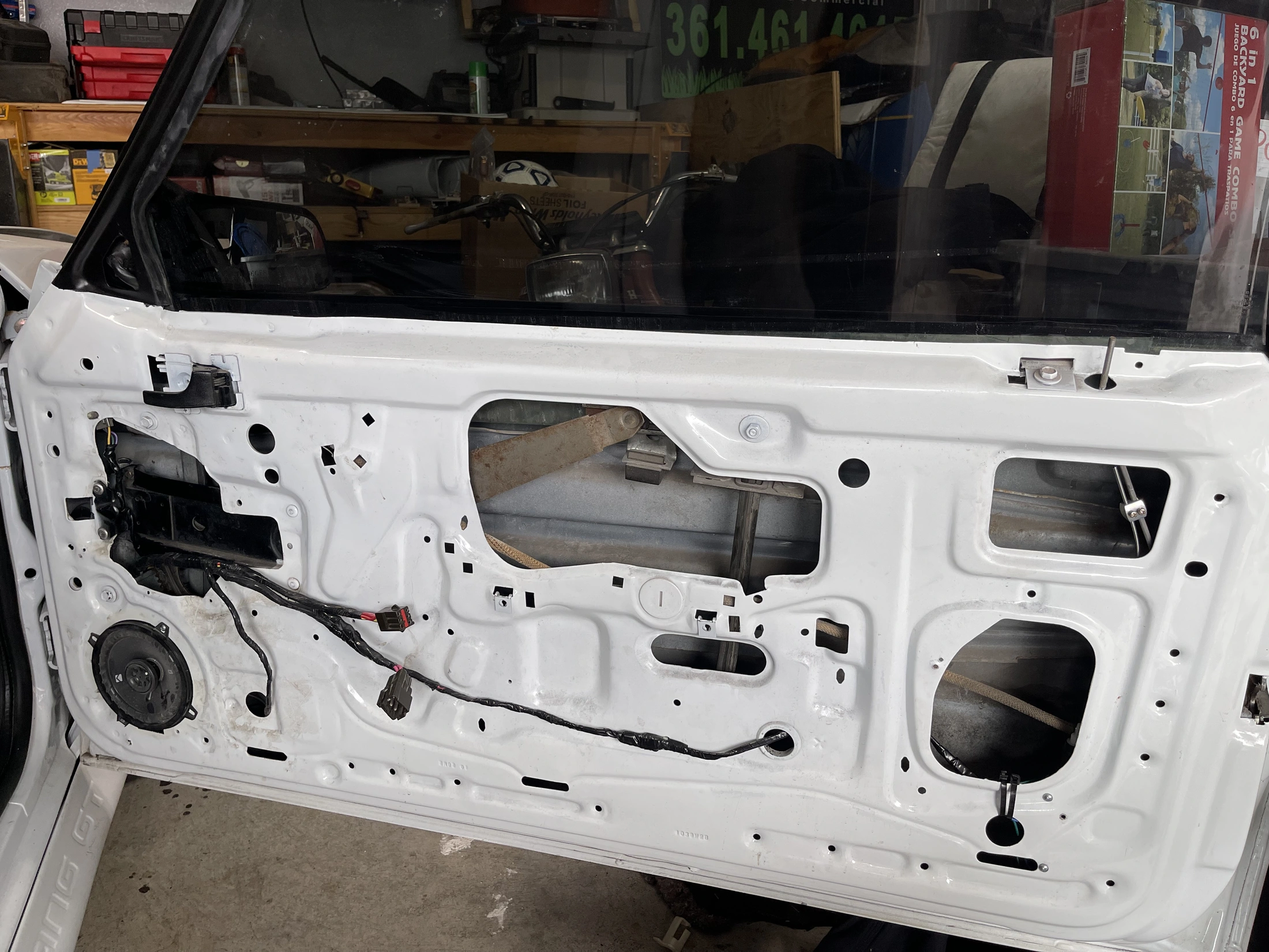

Anyone have pictures of the correct way to route the wire harness on power doors? Body shop pulled my harness out when they removed the doors and left me a mess. Trying to get everything buttoned back up but don’t think I’m routing the harness the correct way. Pics would great help to see exactly how to route them. Pretty sure I have mine incorrect.

Ah damn I literally had my door card off like 30 minutes ago, just buttoned up putting back on.
For those two power window and lock button connectors, test fit where your arm rest will go and route as necessary. I think you’re missing a push-in attachment point to hold them in place but should be fine as long as the door card isn’t pinching them. The connectors themselves will go inside the armrest once you put that back on.
My ground lug was just grounded so some hole on the outside of the door skin. I think that hole right below those 4 circle things.

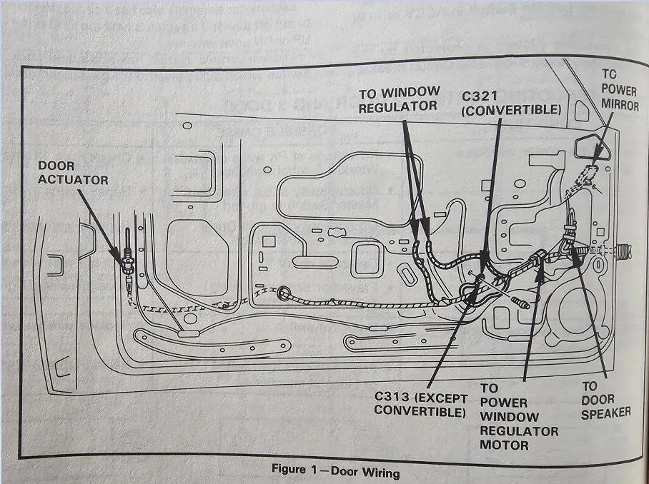

I have this for an 89:

Thanks. It’s a 1990.
This helps out. Appreciate it.

Best I could do with what I had. It should work though. Thanks fellas.
