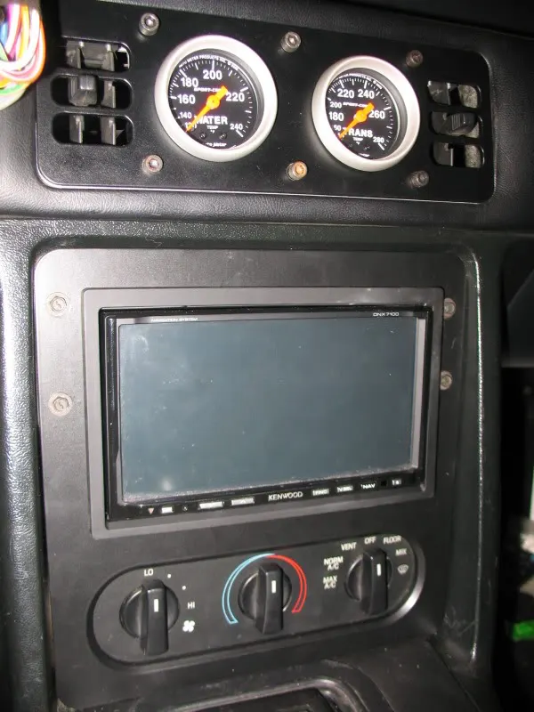

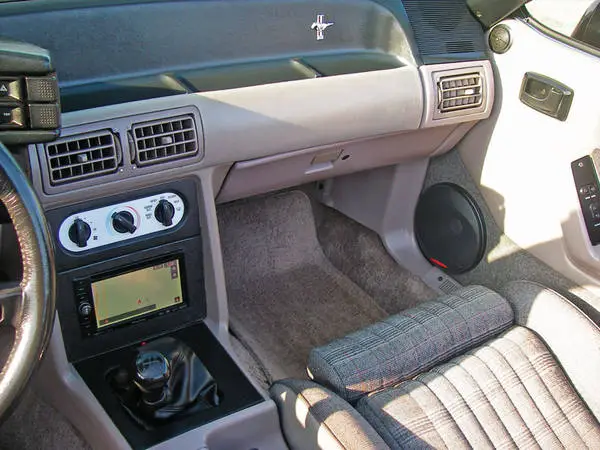

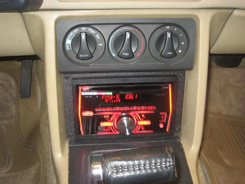

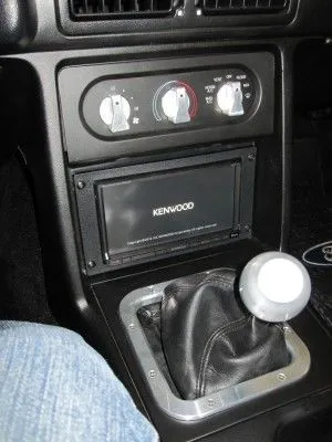

Found some pics of various double dins with various bezels....
I don't like the look of the A/C controls on the bottom with that long flat bezel, looks weird to me. Along with all the screws poking out. So if I decided to do this, I will keep the A/C on top. The 2nd pic, the guy raised the bezel edge flush with the upper A/C bezel line, feel like it needs to be a filled out more in the bezel left over area.
