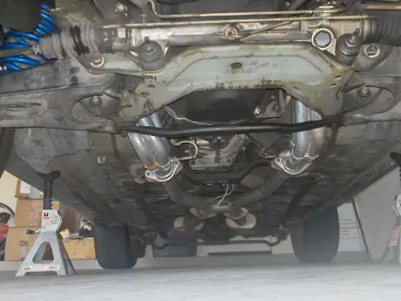

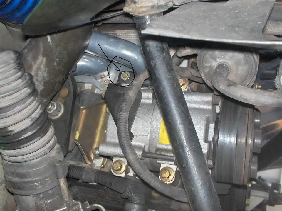

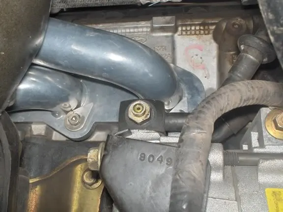

well when i was at a light i heard this really wierd hissing noise. well i got pics and i think its freon. can somebody tell me why it purged all this out and what i can do to fix it. thanks guys.
closer pic
and just one for the hell of it

thats the presure releif valve.. this is a last ditch effort to keep the A/C system from exploding under extreme high pressures.
the high side presure switch should have shut the A/C system down long before it got to the point that the mechanical presure releif kicked in.. This is not very common to have this problem.. One likely cause of this is a bad CCRM ( constant control relay module) it's located behind the right hand headlight in the fender well
bingo....hit the nail on the head..it is NOT common for cars to do this, and that is a common fix. as a matter of fact...just did one at my shop a few days ago. not saying it will fix your car, but it is a good chance.:SNSign:
