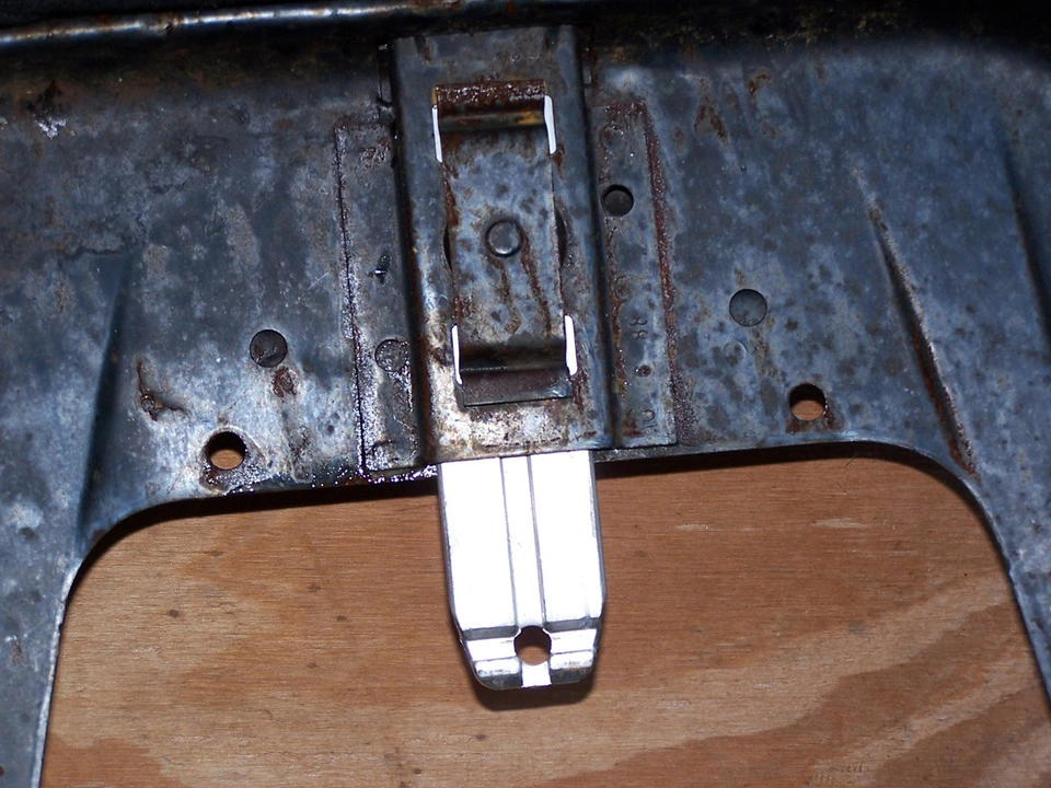

Headrest removal
There is a flat spring that pops into a notch in the headrest mount bar. There is one crook in the top part of that flat spring and one crook in the bottom part of the spring. If you stick the hacksaw blade in the front side of the headrest, it will keep the crook from popping into the notch on the headrest mount bar. Then you can slide the headrest all the way out

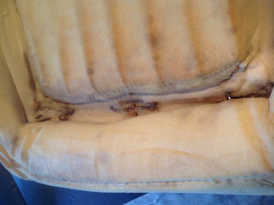

The covers and foam is in pretty bad shape. I want to see if the seats fixable before I commit to new leather cover kits and new foam. It's more than a grand for all the stuff. For that I could get a really nice set of aftermarket seats...

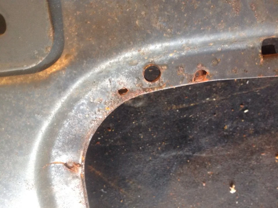

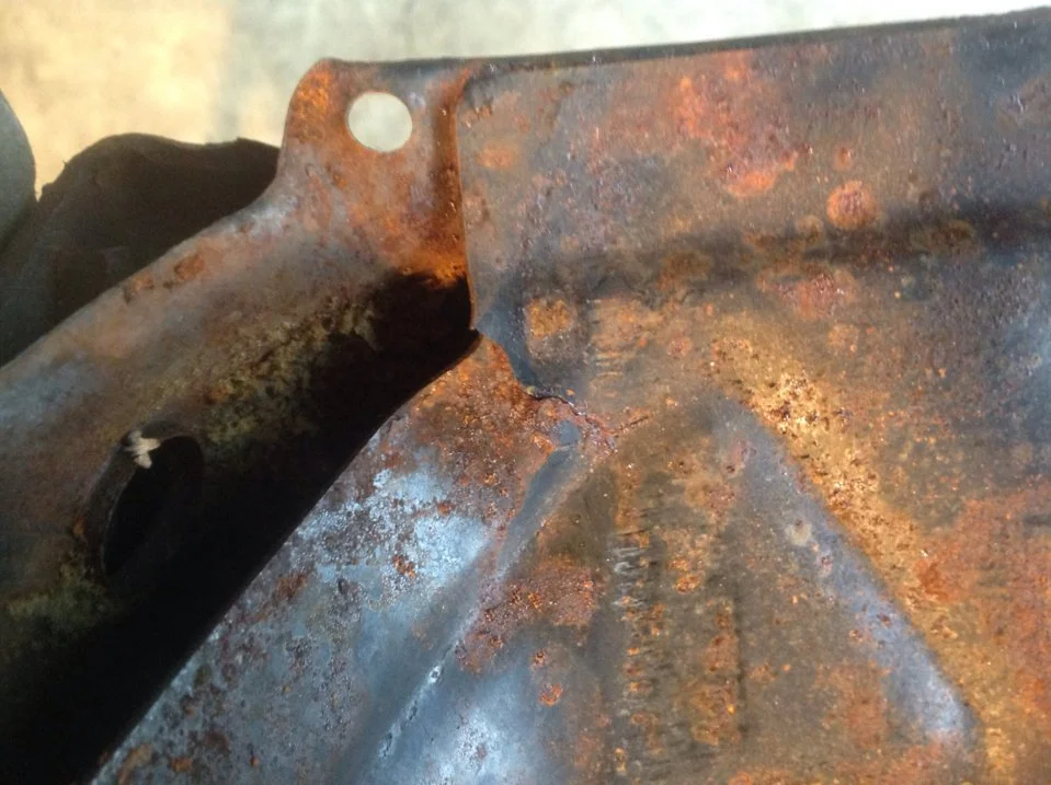

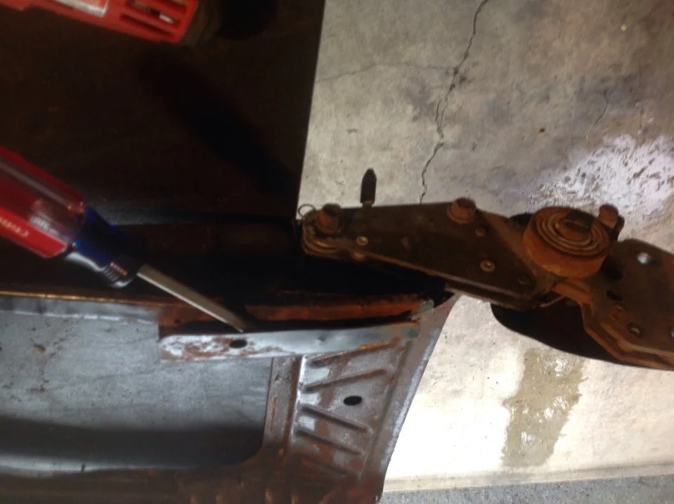

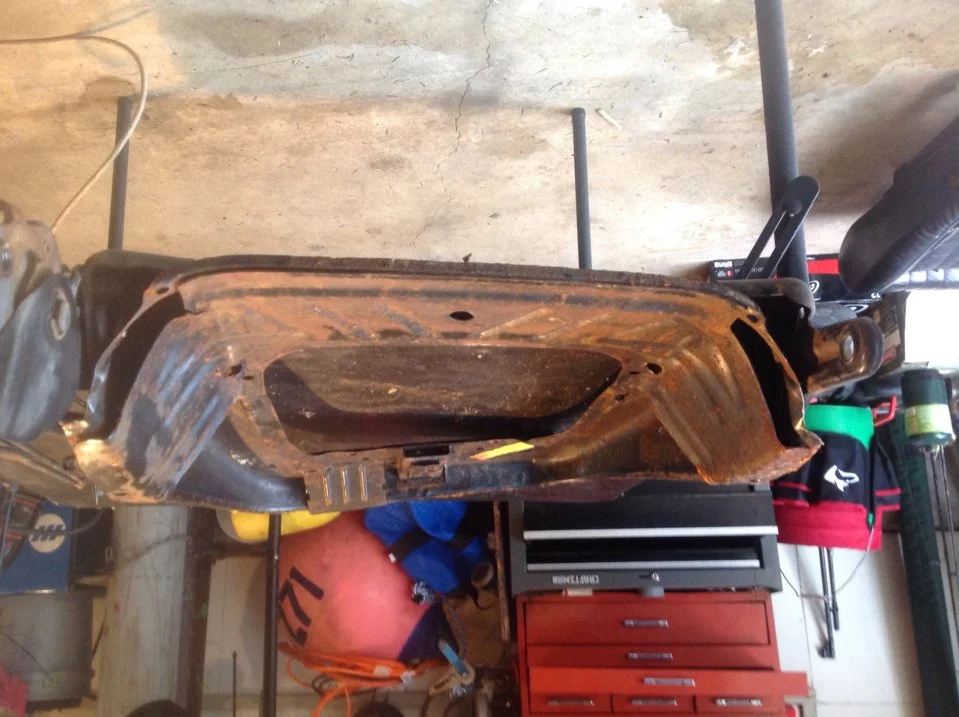

Here are some pics of damage and how bent the seat is. I'm going to see if I can straighten it out then clamp and weld it back together. I like the stock seats and if I can fix them would rather put the money into them rather than aftermarket. Stay tuned....out to try to straighten and weld....sorry for the upside down pics.
Seat is perfectly straight now and works and feels great! Basically I drilled out broken spot welds to the surface of the next layer of metal. Then plug welded each one. I also welded all edges were two surfaces met. Ground grooves in cracks and welded them. Then were any metal edge laid on another surface I welded them too. I don't think it will ever break as I seriously beefed it up.
