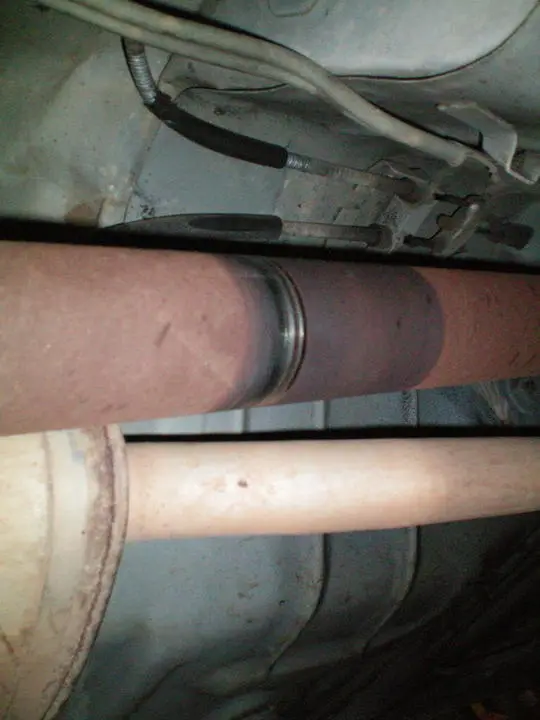

ok you guys ive looked everywhere but cant fint anything but this....
so help me out i really think that it just might be my springs but idk and i dont want to do the job if it aint going to solve my problem thanks
the only thing I can think of that would be even close to the driveshaft would be the exhaust. Even with the suspension fully compressed, the driveshaft has room in the tunnel. If there are no clean spot or signs of rubbing on the driveshaft, it's not hitting anything
It looks like it is hitting the parking brake cables. The on on the left is hit a little the on on the right is bad enough it has eaten the chaffing foam off of it. That is why (i would think) the drive shaft is a darker color "about" the length of the foam that is missing. It also looks like there are bits of foam (looks like powder from a burnout) on the rt side of the trans tunnel. I can see a clean spot above and between the cables. At this point there is a seam if you get back under the car (I can't tell from the angle of the pic) you will prob see a scrape on the leading edge. I figure this by the sharp scrapes on the driveshaft. I would imagine it makes on hell of a sound when it pins that brake cable between the shaft and tunnel. So I think you are either putting too much weight in the car or need new poss. stiffer springs. Is that close to the 1k words in that pic? I hope it helps, Omar
P.S When you get back under the car please conduct a thorough check of the parking brake syst. It is poss (though highly unlikely) that those scrapes could be a result of the broken conduit (the outer metal shell) on the rt parking brake cable when the drive shaft pins the cables down.
