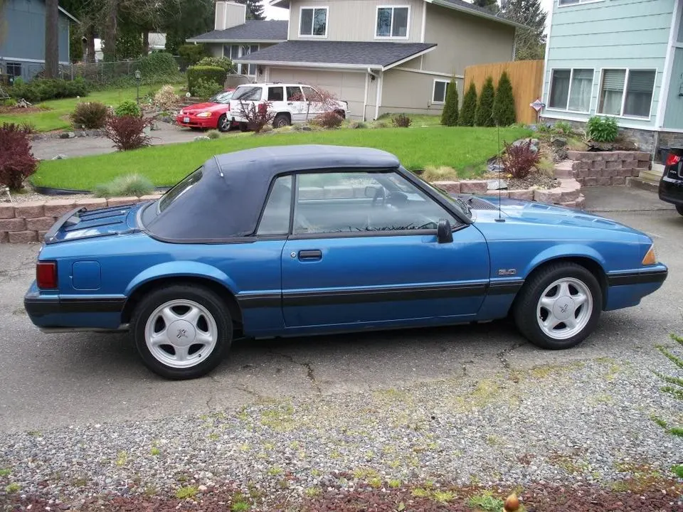

Looking to lower the stang just a little to give it a better looking stance. Any suggestions for springs currently stock 5.0 Auto, I had a 87 that was dropped and had a raked stance that was bad ass but I bought it that way. Would appriciate any help!!! Thanks

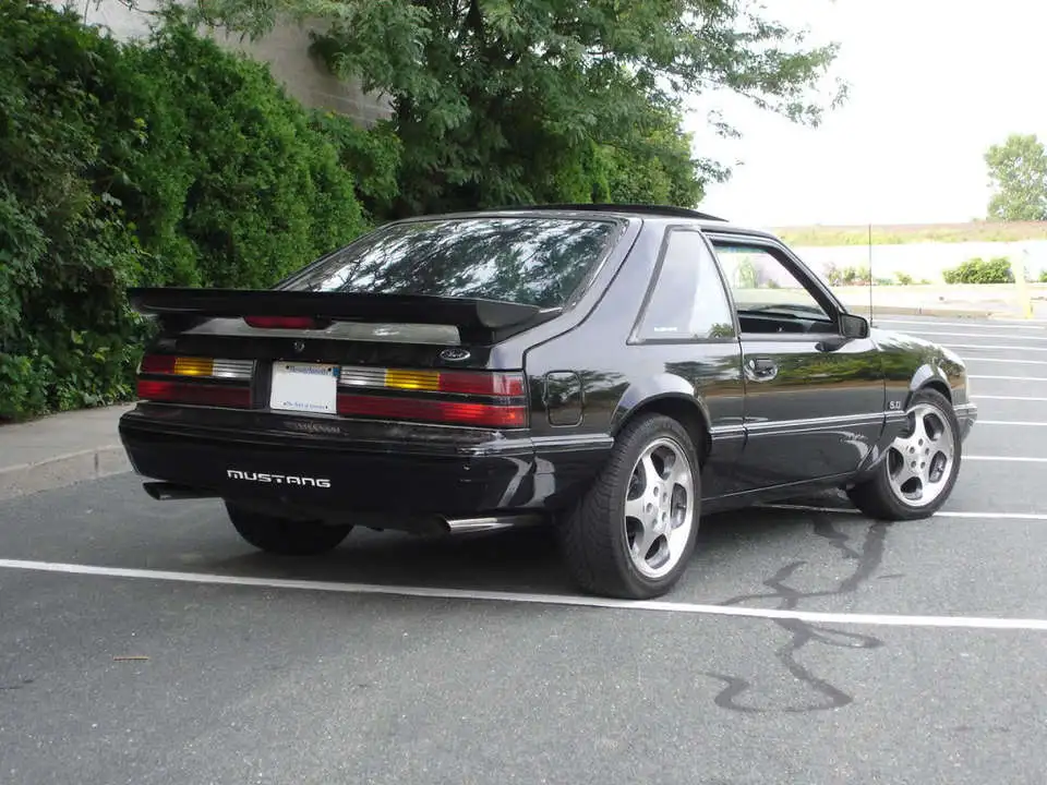

If you like the raked look, you can get that woth ford racing C and B springs. I'd recommend the B springs as they are progressive rate up front.
Here's my car woth C springs. I hated how low the front was though, and later put in Mach 1 springs instead.
