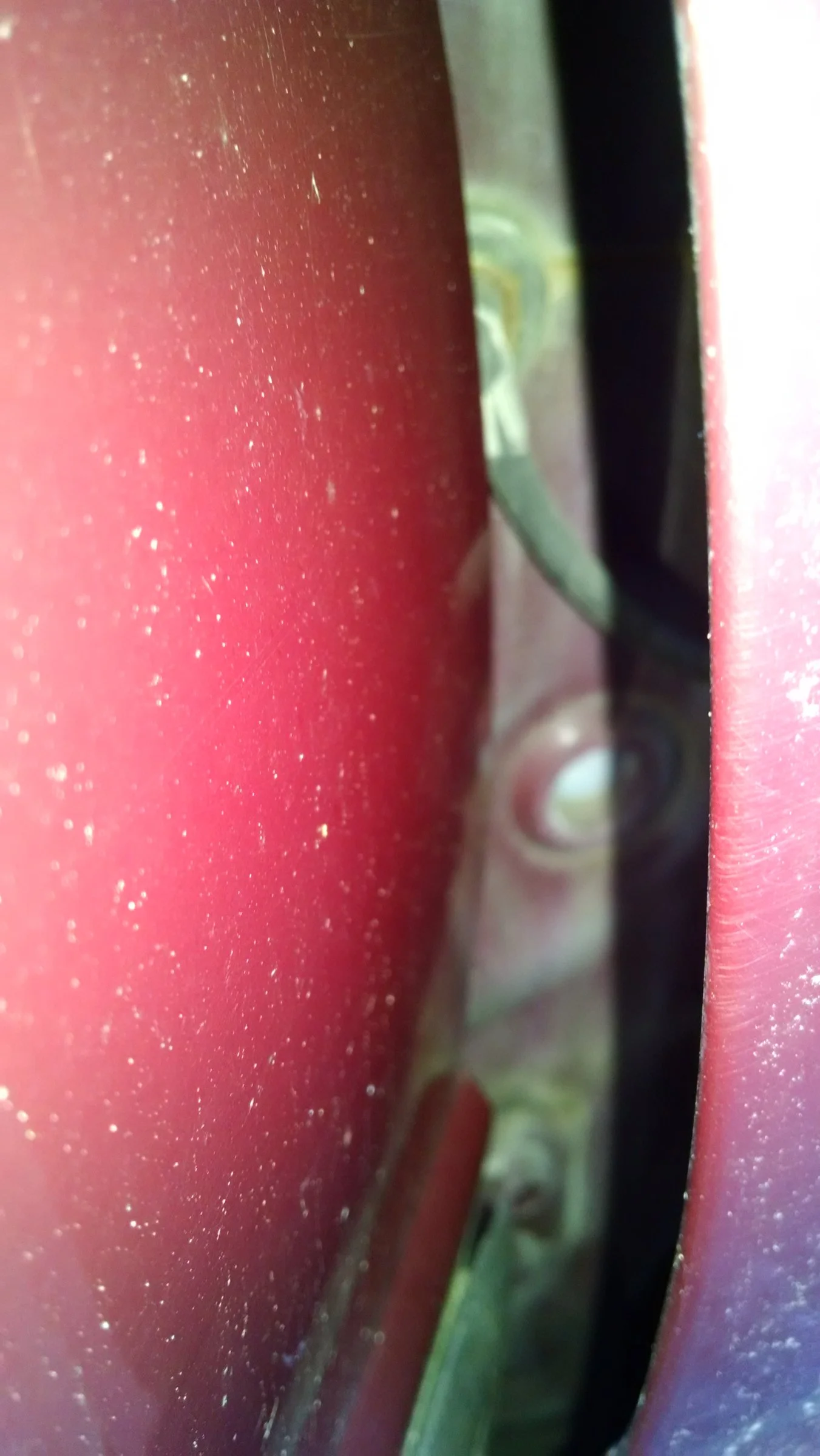

Don't get me wrong the learning curve is steep. However 90% of your time is spent just on the idle algorithm this is the single most difficult part. I can tell you however that I managed to get a nice steady stable idle with an e303 cam right around 800 RPM. With the stock cam or something much more friendly than the e303 the idle is much easier to tune

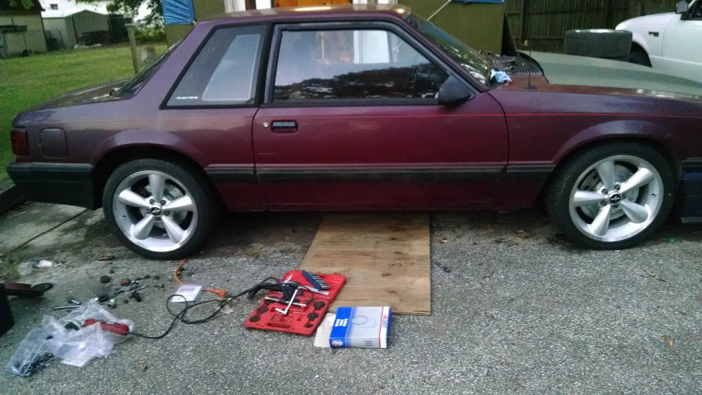

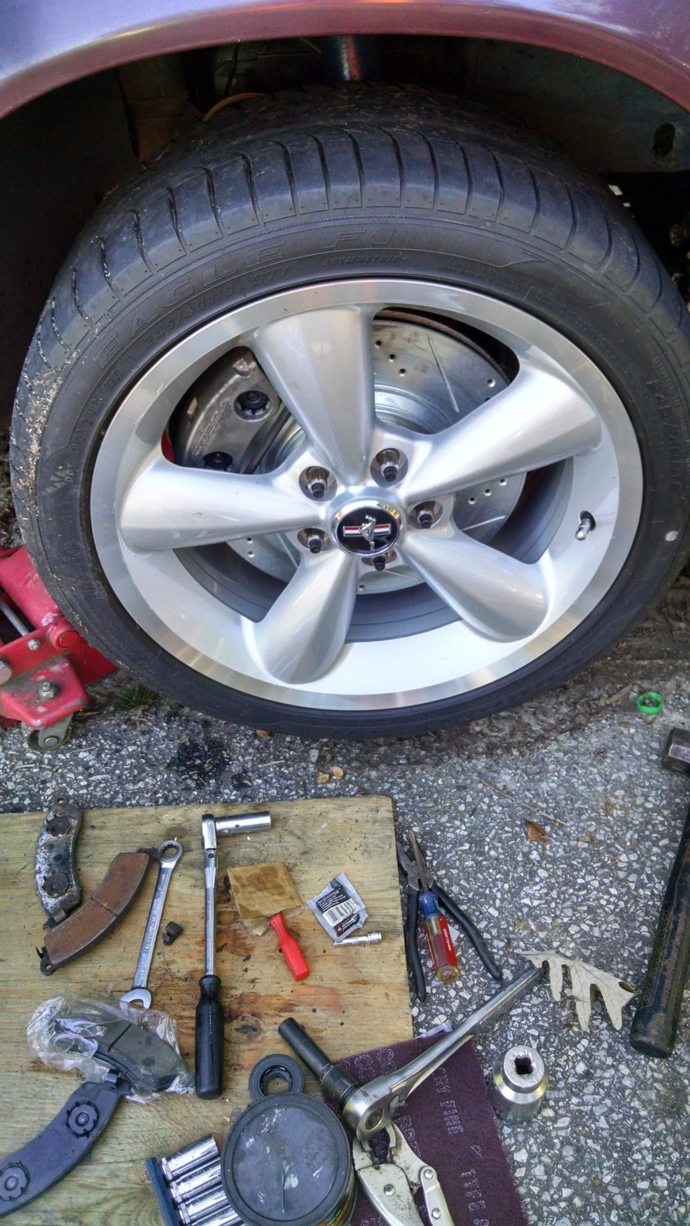

Got the hubs and rotors on. Ran into one small snag. The banjo bolts were so long that they kept the pistons from fully retracting just a hair.
I trimmed those SOBs with the grinder and no more problems. I also treated my old lug nuts to a good grinding, too. Took their heads off.
The rear brakes will be done soon.

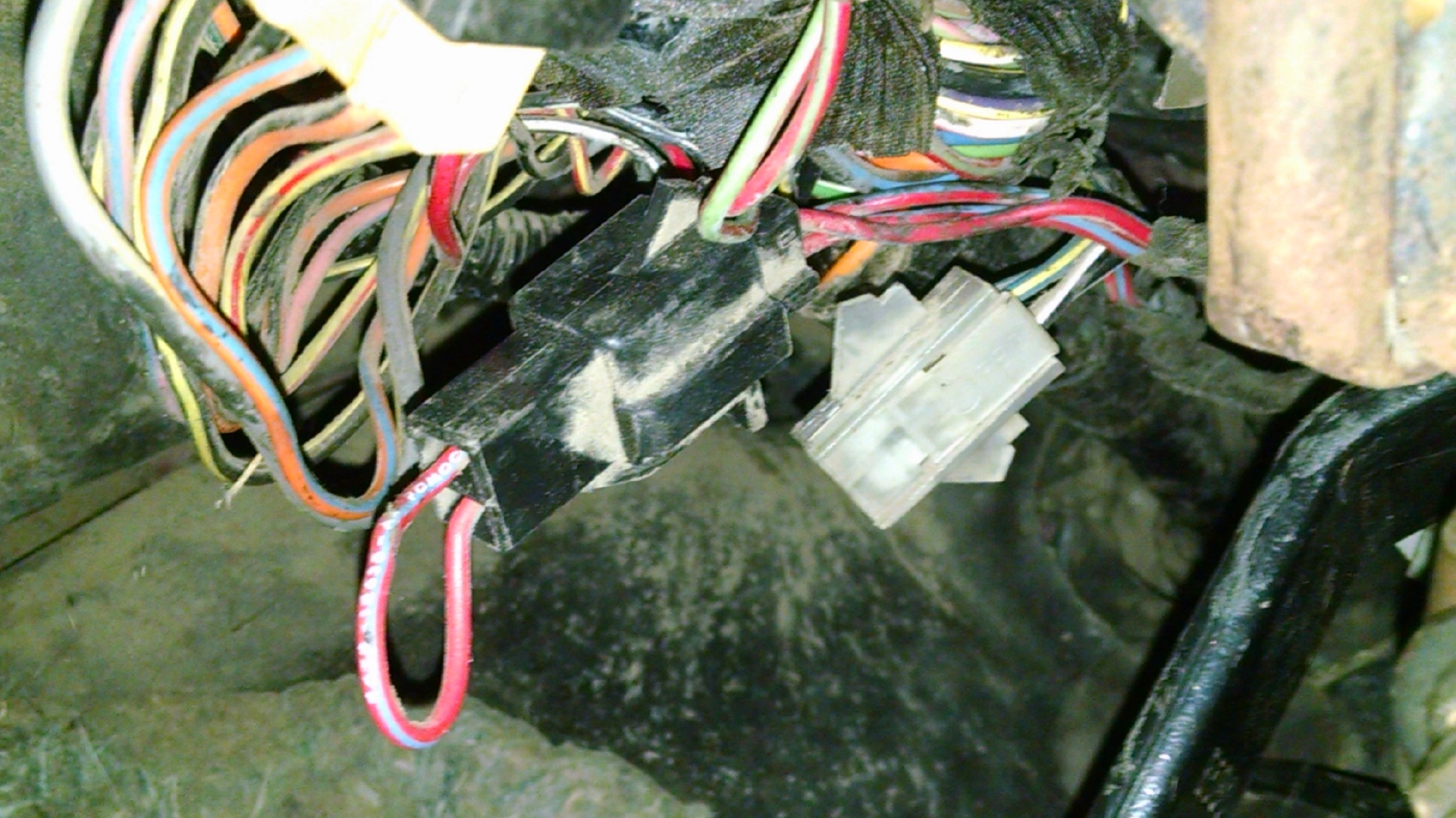

One more thing....to anyone that needs to know....this is the jumper in the clutch switch harness. Disconnect the jumper and plug into switch along with a clear connector.

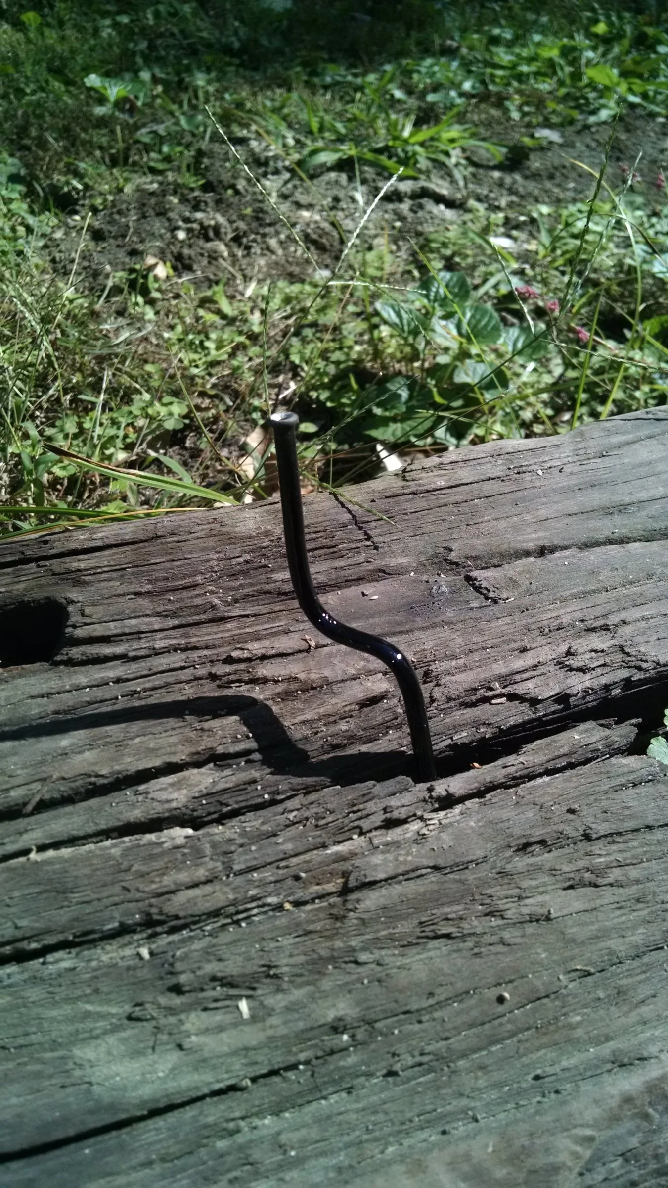

Went out to investigate our TFI modules today. The brand BWD sold by Advance Auto and carquest doesn't come with heat sink grease...it come with useless dielectric grease. It also is cheaply made. The cover on the front ( to cover guts ) is barely glued and isn't sealed for moisture. The Autozone brand Duralast comes with the proper grease and is fully sealed. Both passed ohms testing but the Duralast brand is obviously the better choice. Both are priced the same without discounts.

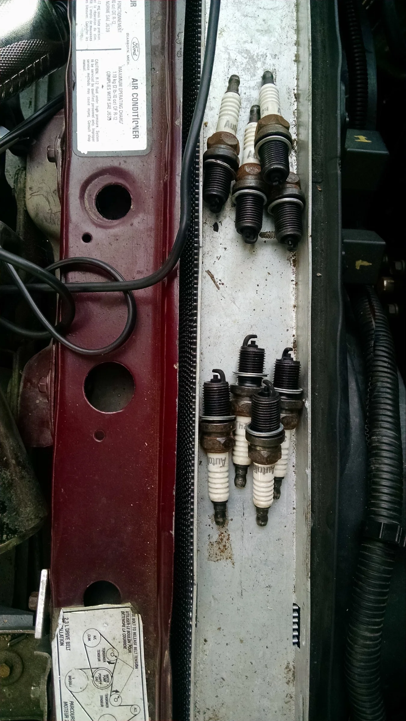

I can get to all my spark plugs without taking out the down pipe...another win. [emoji469]
All 8 of my plugs are fouled...well at least they fouled evenly. Smh

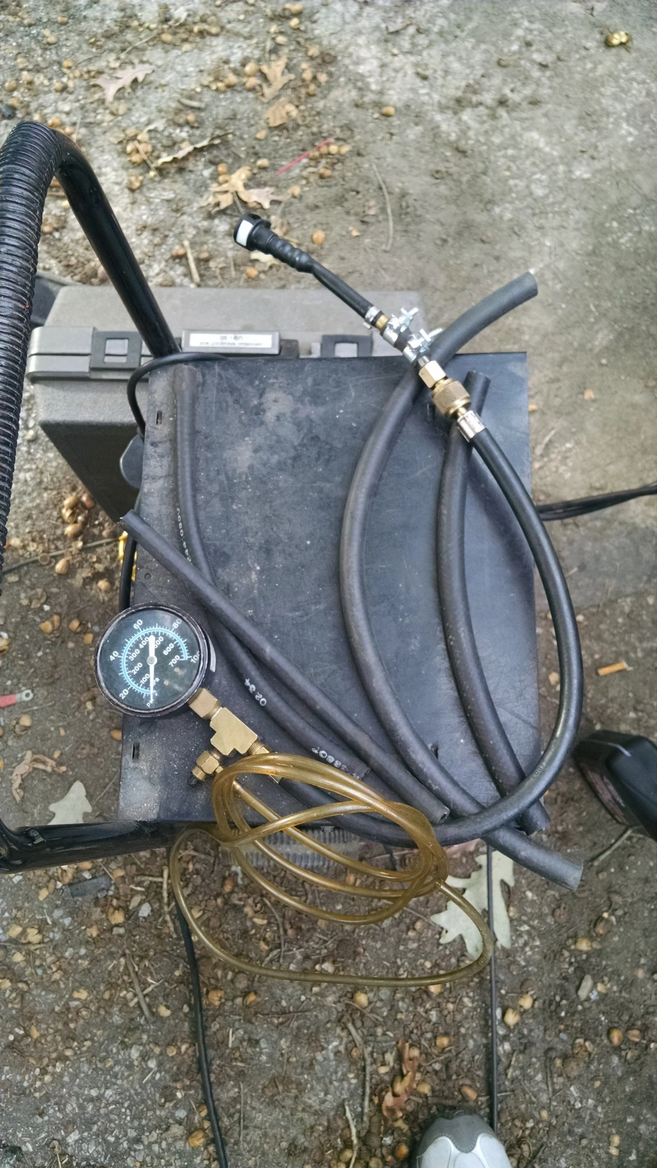

The Schrader valve for fuel pressure was deleted so I made this...
The pump is putting out. Two primes fills a one liter bottle half way. Three primes and the gauge was pegged past 100psi. It was connected before the FPR. ( directly to feed line ) Can't really tell how well its holding pressure due to a small leak at the connection but wasn't bleeding down fast at all.
Don't want to pull the intake to check injectors....if I do that I might as well buy 60psi ones.
Don't know how to test the fpr other than finding a way to plug the return line.

Haha.....found the issue...funny how beer works. My brand new Kirban FPR is bad. I noticed it would drop pressure over an extended period of time. This is rediculous because I have a two bolt truck rail.
I rigged my pressure check line and used air pressure to pressurize the rail. Gauge read perfect but pressure dropped quick. I swapped the fpr for a factory explorer one and its holding steady at 30psi....too low for me but let's me know the fpr was dropping pressure not the injectors.
